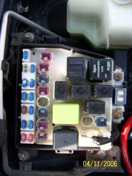

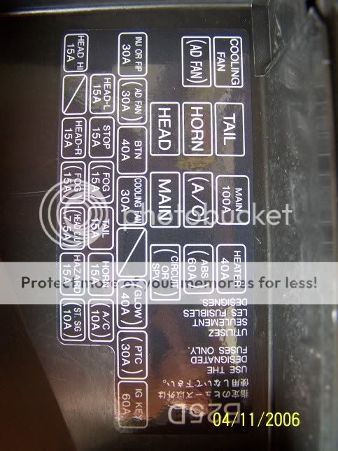

I agree that 40 kph is too low. Also, I believe fuses for the cruise are under the hood in the main engine fuse panel (not the one under the dash).
theres mine.. not exactly sure which one is cruise either but i figured it might help

Alright, well I checked ALL my fuses (both inside the car AND under the hood)a and they're all good. Not a burnt one in the bunch. Guess it's either a faulty module or a pressure leak. Is there any way to find out what could be wrong WITHOUT taking it to a mechanic? Thanks!
