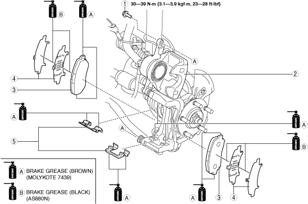

They may not have put the anti-squeak pads/compound on the back of the new pads or cleaned everything well before installing new pads.
I overlooked that OEM parts were used. My bad. It could still be due to lack of cleaning or anti-squeak compound.
Mazda does not use or recommend any grease be put on the pads, but you do on the areas where the metal clips attach.
