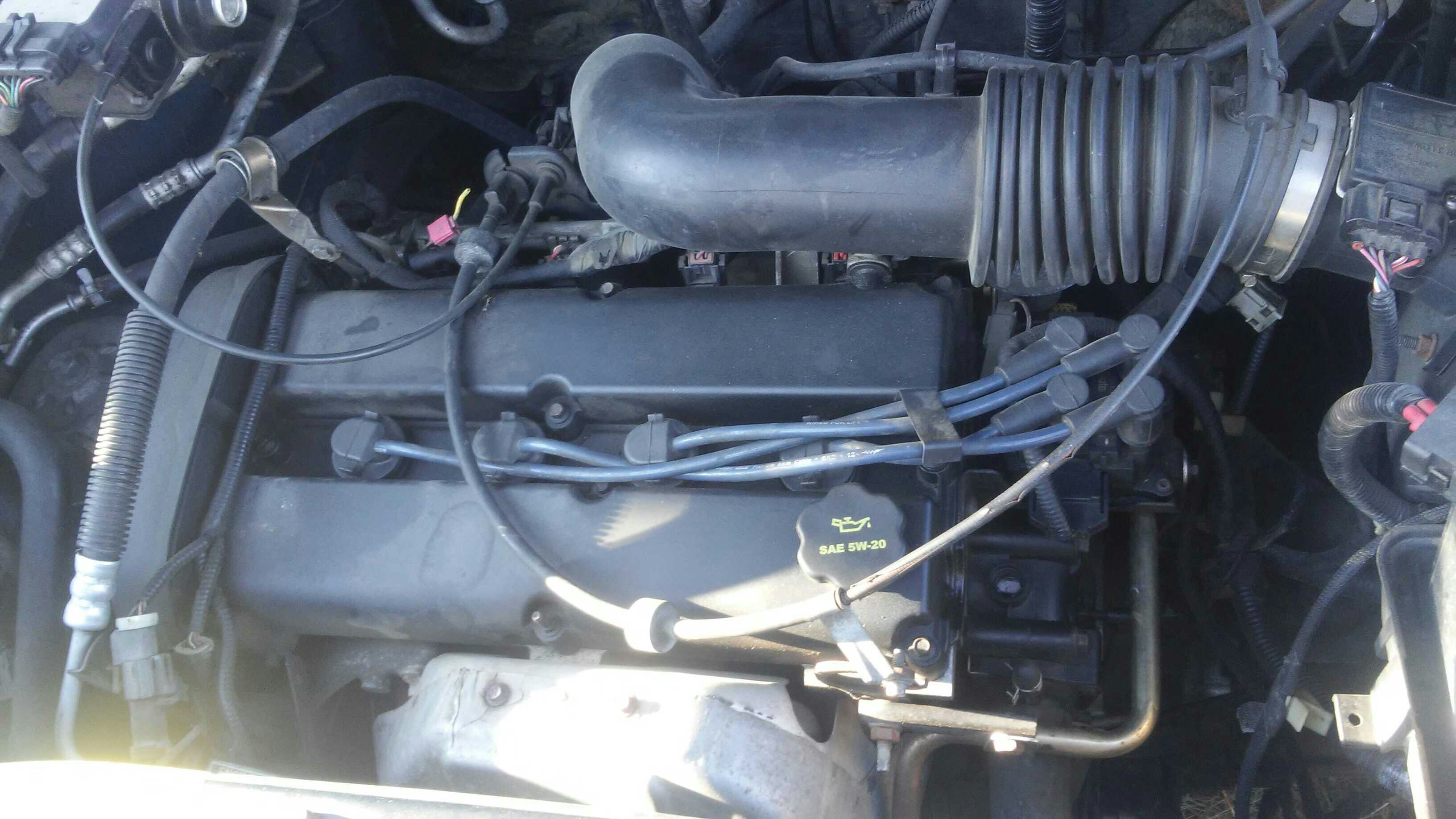

The 01 dx has an FS-DE. notice the crap plastic valve cover and intake. The worst of it is where the throttle cable gets looped over the entire engine. Its FS9 cast head, and I believe specific to the 01, five speed fwd tribute dx. This vehicle was my entry into the protege family of vehicles. I would pull more out to photo but currently is my daily. The 2.3 and 2.5 are zetec.
The 2.0L is a Zetec, which is what you have. Same as the Focus. The 2.3 and 2.5 are Duratec motors. They never put an FS motor in the Tribute. There was never an FSDE with a plastic valve cover. I am familiar with the early DX tribute, I used to work on them all the time when I worked for Mazda.
Huh, had it at a mechanic who told me it was FS. This was at a time I had torn the timing belt and melted the plastic water pump. He was stunned it was a non interference and initially told me it was done. I have since takrn to doing myvown work.
I believe you, no reason not to, I just need to do more research on my own. Thanks for setting me straight. Its third in line for getting pulled.
Yeah, did alot of wtf's when things went wrong on it. Seems sort of rushed and not thought out very well. Waterpump has since been replaced with a cast alloy at least.
Don't even joke about the pistons... I have been waiting to find the playdoh parts... lol
