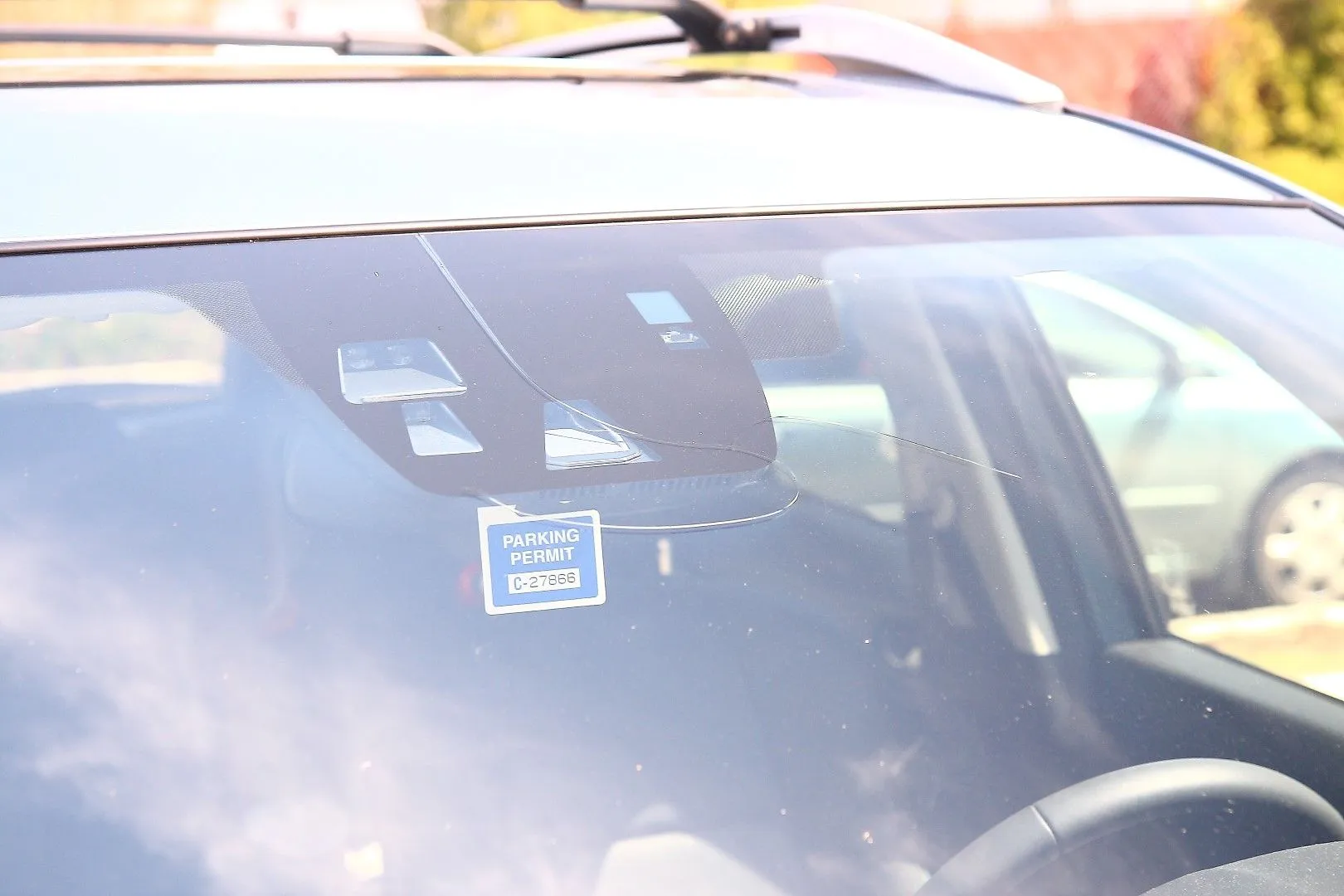

Went to wash the car this morning and saw the windshield cracked by the rear view mirror. Called the dealer to report the issue and he said I should take it in on Monday to the service manage. I'll keep you posted.
I hope the picture can be seen. I haven't uploaded pics before.

Thanks. I suspect that that's what they'll suspect but there's no rock chip. It happened overnight in my driveway. It appears to be a stress crack.
As I am sure you are aware, this is a well documented problem for '13-'15 owners. Luckily my windshield has been fine, but many others have experienced the same crack in the same location as you. It is a shame that this problem has not been rectified on the 2016's...I thought the 2016s had thicker glass which may have corrected this problem - but I guess not.
If there is no chip, fight hard to get it replaced under warranty. A few members have been successful with this.

So I haven't followed this issue as closely as others here, but Have most of the breakages been in that spot where all the tech goodies are hung on the inside of the windshield? My plain Jayne Touring just has the regular r/v mirror and no rain sensor for the wipers and I've had no issues in 2.5 years of use. Makes me kinda' wonder if that' just too much weight to try to support from a 3/16" thick piece of glass?

Yes, I'm aware that the issue existed with previous models. I also thought the thicker glass solved the problem. My primary reason for posting is to let others know that the issue still persist.
The dealer will cover the replacement under warranty. They've ordered the new glass and said it will be there in about two days.

Update: The dealer replaced the windshield at no cost to me. Total repair cost to be paid by mazda corporate to the dealer is almost $900
