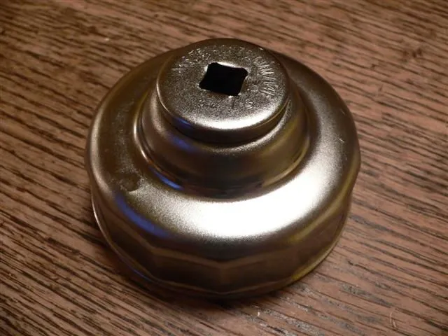

anybody got a pic of the tool?
Here's a picture. Be careful, there are several sizes that look kinda like this. If you get it from a Mazda dealer (or one of our sponsors) it will be sure to fit

The shop probably over torqued the oil filter housing. The manual says to torque it to 25-35 Nm. I bet the shop doesn't even own a torque wrench. That's why I don't let anyone work on my car, I don't trust a guy making minimum wage to take care of my stuff.
or go to advance auto .... 14 flute 76 mm (factory is 75.6)
dealer wanted $30-ish, advance was $4.98 and fits like a glove, big key is torque, it doesn't take much and shops are notorious for over-torquing filters. My gf had an older accord and the dumbass who changed the oil didn't put oil on the seal and then used a damned impact wrench to put the filter on. I had to take it off with an 18" pipe wrench.
