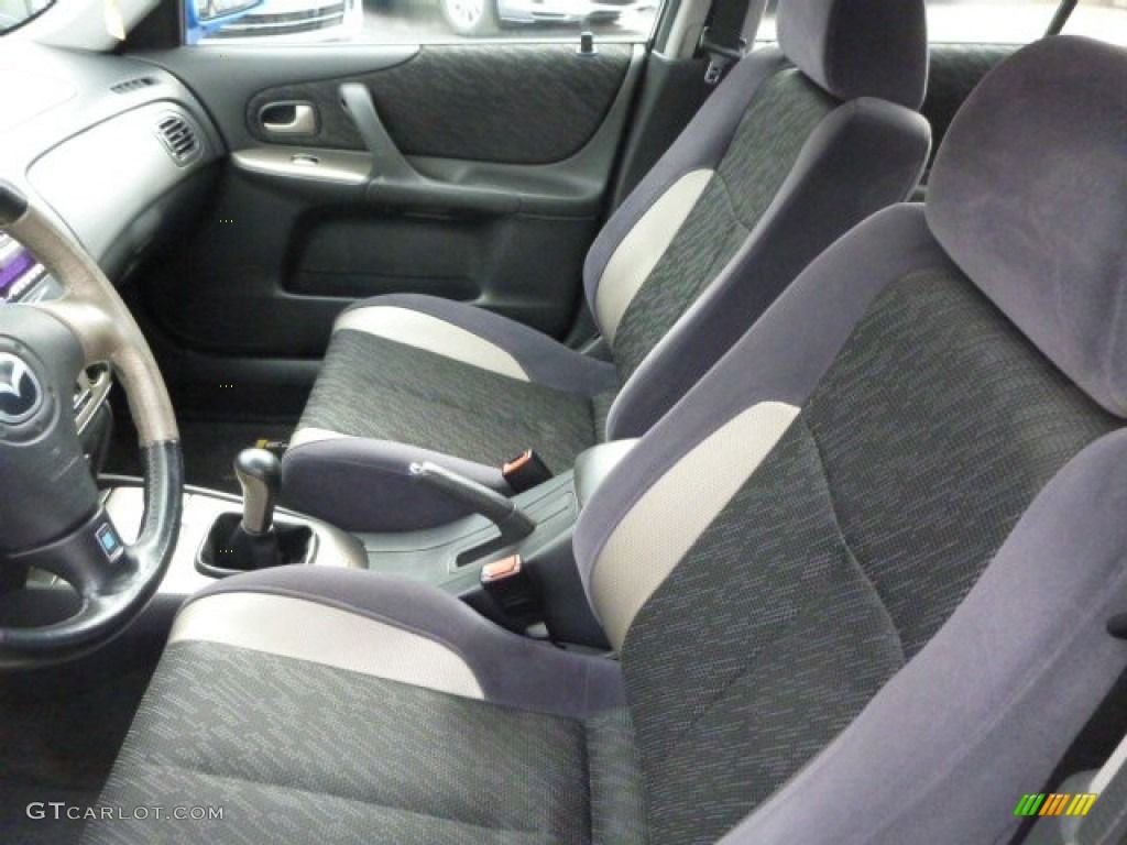

The MP3 was made for the 2001 model year, it came in Laser Blue and Yellow and it had different seats and door panels, similar to the MSP. It also had an intake manifold with the VTCS flaps deleted, the ECU had advanced ignition timing, it had a short shifter, Nardi steering wheel, metal pedal covers, different MP3 floor mats, Racing Beat axle back exhaust, a Kenwood stereo and 10" bass tube in the trunk, Tokico HP struts and Racing Beat springs, Racing beat sway bars, yellow strut tower brace (same brace as P5 and MSP), small black lip under the bumper, higher pagoda-style spoiler, rear lip, side skirts, 17" Racing Hart wheels, and an MP3 engine cover. It also had MP3 badging on the doors and trunk.
