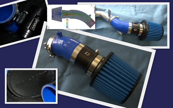

We're in the process of developing a short ram intake for the first generation MZ3, similar to the one we have been selling for the last 4-5 months to the 2010 guys.
Our goal is to have an intake that makes good power across the powerband on the 2.0 and 2.3 with a simple installation, clean look and configurable color options for those of you who want to have a specific look to your intake. This will be followed up with our cold air box development that will give you all of the low pressure drop characteristics of a short ram design with the cold air benefits of a long tube CAI.
The design uses a 4 layer braided nylon reinforced silicone coupler, anodized and second-op machined billet MAF housing and CorkSport Dry Flow conical filter w/ internal air horn and AEM DryFlow Media. It will provide location for a factory style valvecover positive crankcase ventilation tube.
We'd like to get as much feedback as possible on design considerations so we can incorporate any other items early in the development process. We're a few weeks away from having our first set of prototype silicone couplers as well. We have a number of our 2010 MZ3 design intakes on 2.3l 1st Gen MZ3's also and they are running great with no CEL activity (one has been on for nearly 5 months now).
Here's a photo of our 2010 setup in blue with black MAF Housing and some close ups of the various design elements in the system:
By the time we release the design for the 2004-2009, we will have a multitude of anodizing colors (sky's the limit really), silicone colors (blue, black) and filter media options (blue, red, charcoal).

Jason@Corksport, can you make sure that when you position the MAF Sensor that you take into account how long the stock MAF Sensor wires are and make sure that it isn't too tight and not putting any extra strain on the wires. Or maybe you could offer a MAF Sensor cable extension so we don't ruin those delicate wires. I guess that is one thing holding me back from getting a SRI. It would be great if you could take this into account with your design.
Of course, there will be no strain on the wires. All of our systems place the MAF within a few inches of where it was from the factory. In the case of this intake, its negligible difference from stock.
