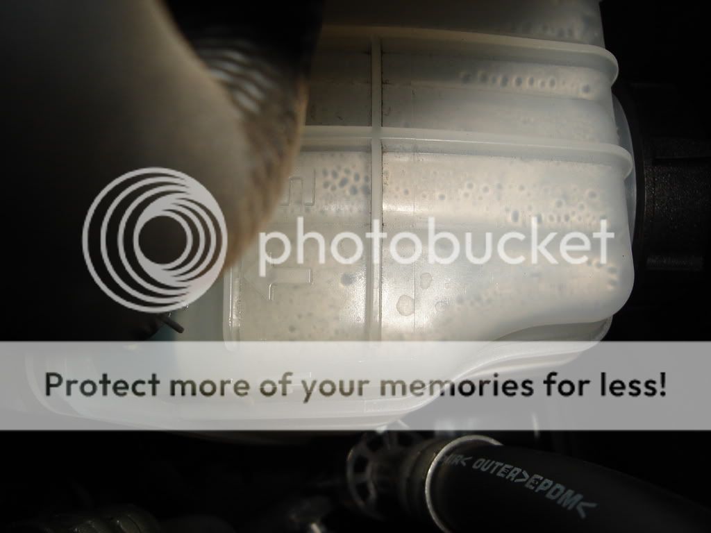

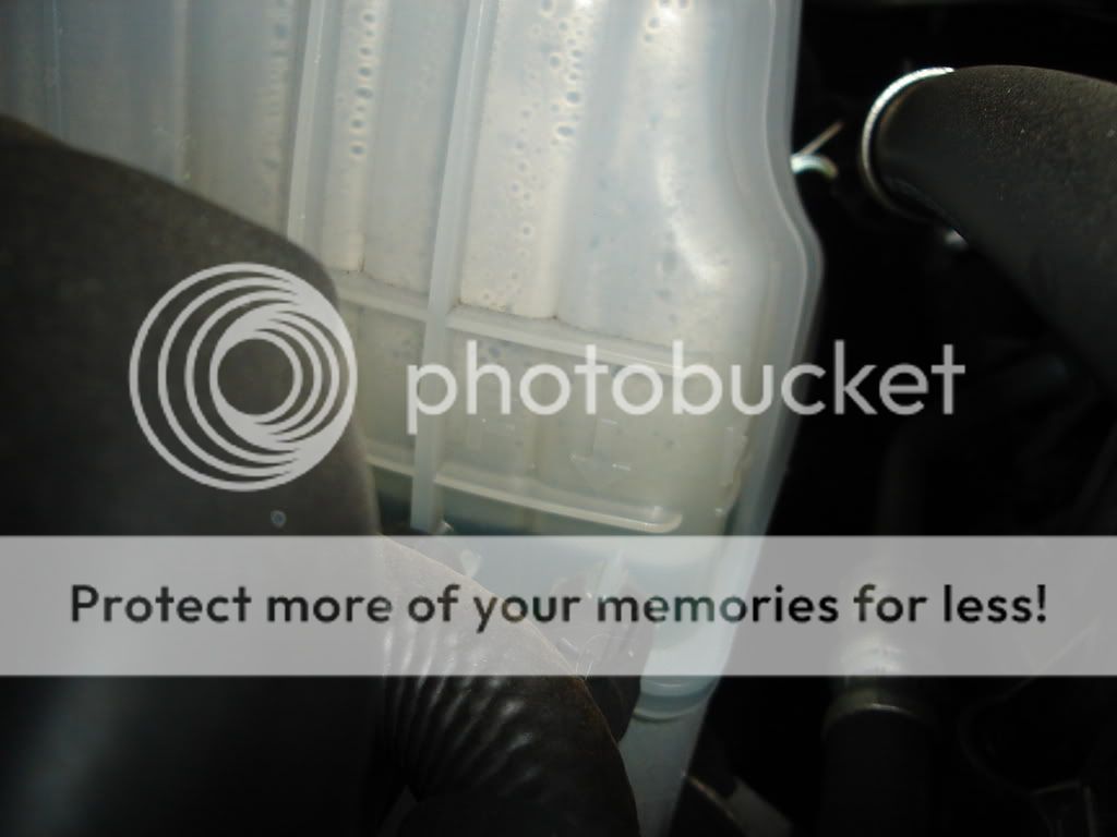

my coolant has slowly been dissapating. about a month ago the coolant was about 2mm below min. now its a good centimeter below minimum. i read some place that coolant is not supposed to be consumed like that and that there could be a problem. i show no signs of leaks tho. i bought some coolant to add, but i asked my mechanic about this and he said to add water in the reservoir and when it gets sucked up it will mix with the coolant. i don't know about that. i thought you were supposed to add water only in a bind. should i just add the coolant? i would like to avoid the dealership as much as possible, so any help would be appreciated.
it was a tad bit higher about a month ago, but now:
mix coolant with water 50/50 , water cools better but coolant has lower freezing point as well as additives. as far as where the water goes......either it leaks it or it steams it. If it leaks it look for puddles if it steams it (in the form of a busted head gasket) you will have white smoke , not unlike the white smoke we all experience upon start up on a cold morning except this white smoke will be from water being dumped into the combustion chamber rather than the condesation we experience on cold mornings.
