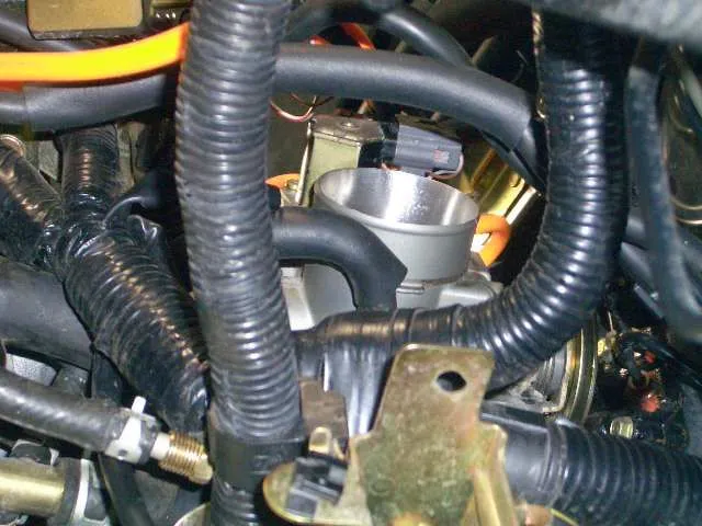

Here is a pic. of the throttlebody already installed ...you can see the bottom coolant hose connected to the metal tube I used to connect them. I can't tell you the performance difference since I put everything in at the same time, but I will tell you it feels pretty strong in the high rpm range.
