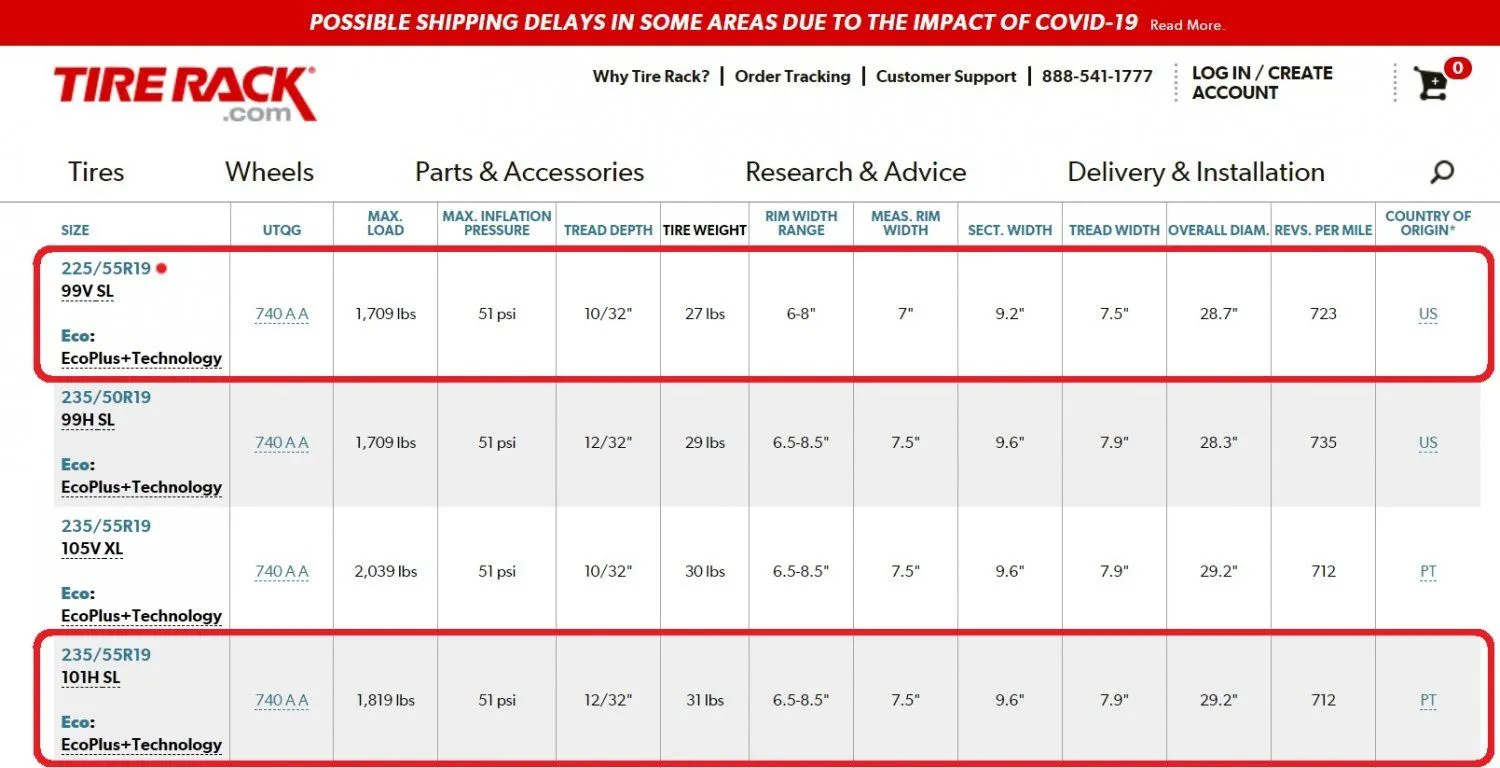

When I checked the specs on Continental CrossContact LX25 for 225/55R19 99V and 235/55R19 101H from Tire Rack, the difference is more than I thought it’d be:
225 is V rated but 235 is H rated. Some people insist they want V rated tires to match factory V rating on 19” tires.
225 is 10/32” but 235 is 12/32” on tread depth.
225 is 27 lbs. but 235 is 31 lbs. on weight, and 235 is 14.8% heavier than 225.
225 has 7” but 235 has 7.5” for measuring rim width whereas the width of our factory 19” rim is 7”. “The measuring rim width is the industry standardized rim width upon which the tire must be mounted in order to confirm it meets its dimensional targets. Because the width of the rim will influence the width of the tire, a standard rim width for every tire size is assigned and must be used. This standardized measuring rim width allows all of the tires produced around the world to meet the same dimensional standards and therefore, be equivalent with regards to their physical size. The measuring rim width is sometimes referred to as the tire's "design rim width."”
225 has 28.7” and 235 has 29.2” on overall diameter, and 235 is 1.7% larger than 225.
225 has 723 and 235 has 712 revolutions per mile and 235 has 1.5% less revolutions than 225.
Finally, 225 is made in the USA, but 235 is made in Portugal.
Interesting. Actually, that is quite a bit more tire weight-surprised there is that much difference in such a small size increase. Usually, adding unsprung rates deteriorates ride quality a little. That was my experience with my old mustang GT when I added wider Nitto drag radials. But I also upgraded the shocks at the same time so it helped keep the additional unsprung weight mostly in check.
I wonder about the 235/55 "105V XL"?
How do tire manufacturers come up with these confusing differences?
