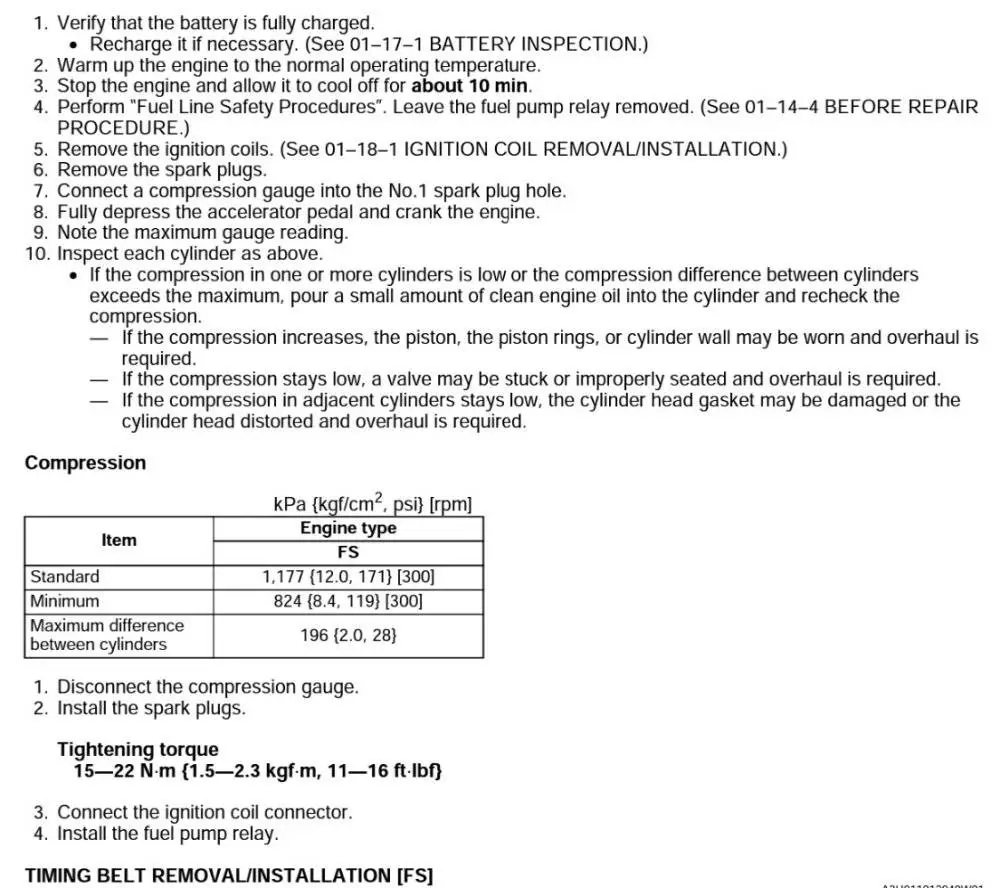

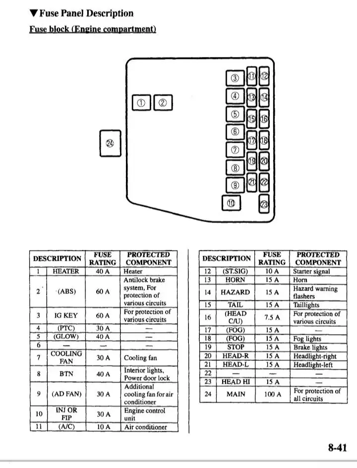

I’m about to do a compression test, but there’s no fuel pump fuse so I’m not sure how to disable the fuel injectors. What should I disconnect (visual much appreciated) and anything else to consider?
I'm almost positive that you pull your fuel pump relay and that it's relay #10.
