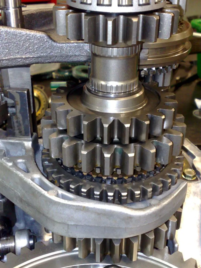

I debated long and hard and finally thought how much I put into this car and decided on the PAR 1-4 set. I think my original plan for 300whp may go up a little higher since that was pretty much my limiting factor. Payment went through today gearset will be here in a week!
YOU LUCKY BASTARD!!! I am soooo fuggin jealous! When you told me how much them things are, I had to go on a search for a better price. YOU HAVE TO POST PICS!!!! I gotta see em.

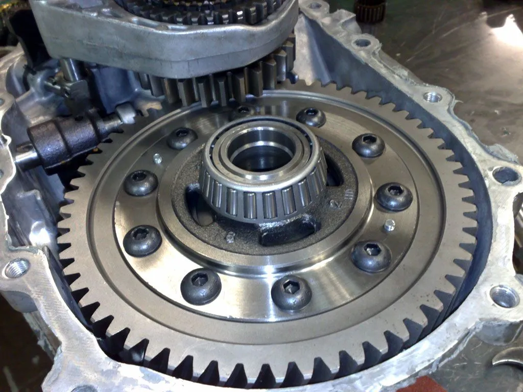

These were posted in Dana's broken 3rd gear thread by PAR! Yummy!!
The last pic is of my tranny last rebuild. Big difference and I have all needel bearings for the new setup .
