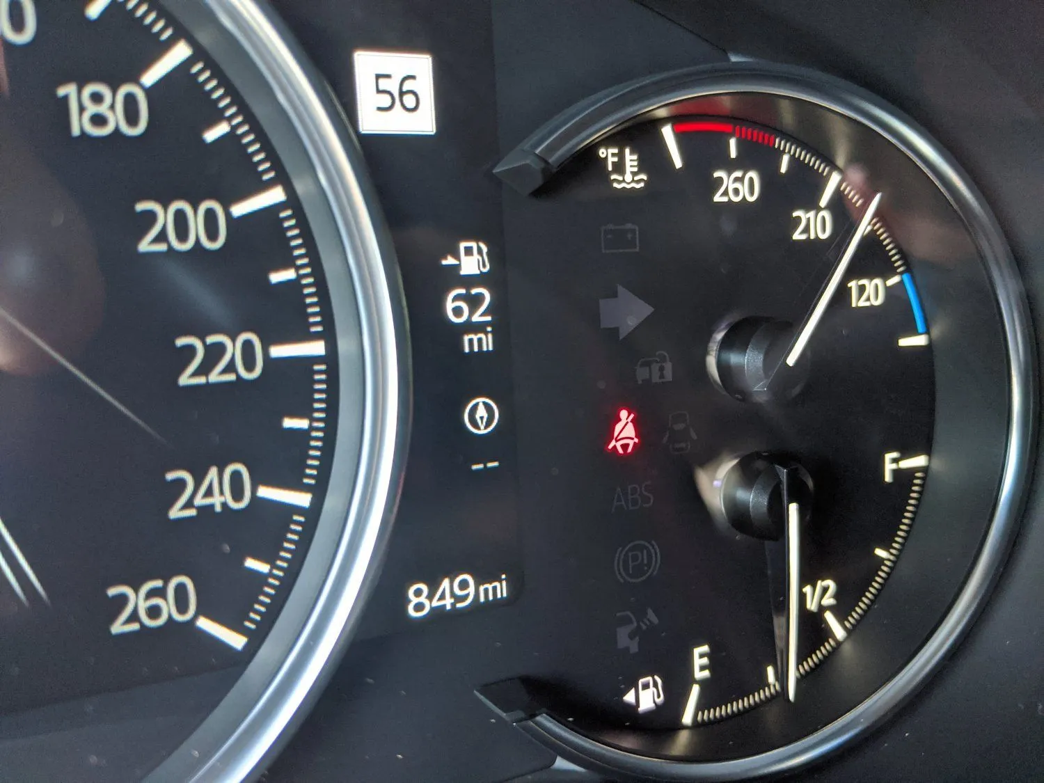

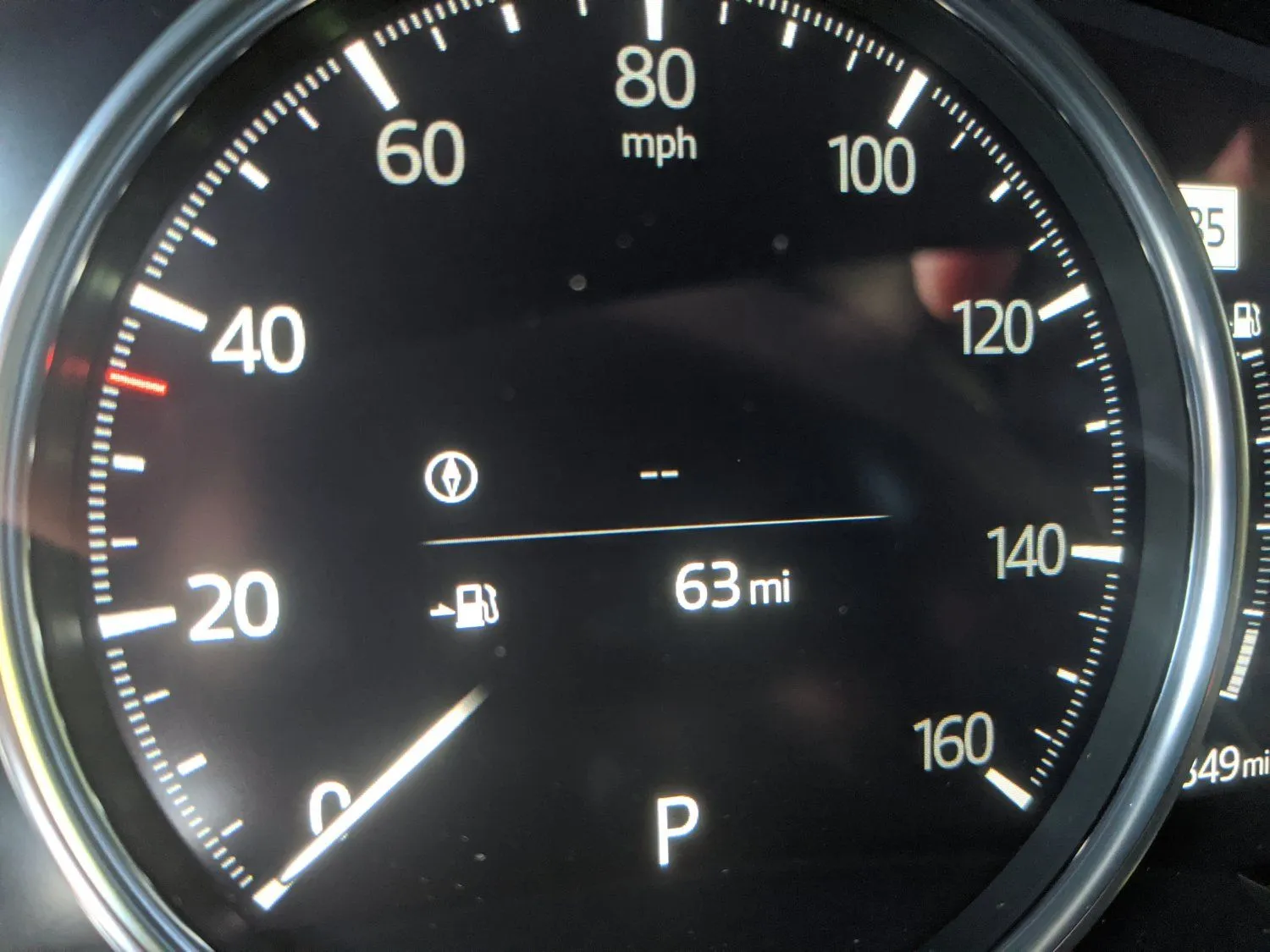

My compass on the dash stopped working recently. It always shows '--' for the compass, even when moving. I'm not sure when it stopped working as it originally was working, but for a while I didn't have that view displayed. It doesn't matter which "view" i have the dash set to, if I set the middle to show the compass it doesn't show up and if I hold the stick to bring up the view that has the compass on the right side it doesn't show either. I attached some screenshots.
I tried pulling the nav card out and testing and that doesn't matter either. I will say when I pull the nav out and click the 'nav' option on the infotainment, the compass in the infotainment works and shows me my heading, lat/lon and altitude.
Note again it doesn't work even when I'm moving. I know it's not supposed to show anything when stationary.
