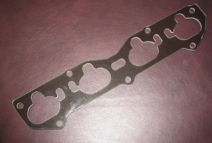

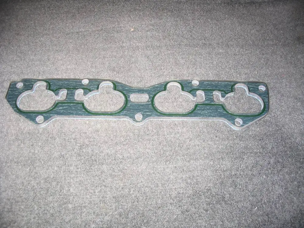

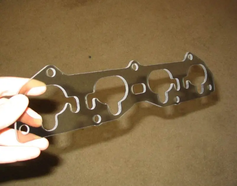

We got our first prototype of the thermal spacers in. Nothing but great news regarding them!!! The fit and finish of them is absolutely fabulous. Also, our research has yielded a lot of great things too! We match the temperature ratings of the "other guys" out there as far as our material, we exceed the tensile and compression strengths, but most importantly of all we have a 30% better resistance to conducting heat! So that's great right there. Then the fact that the fit is as good as can be means we are really happy. Additionally, the stock hardware still fits great and gets plenty of thread engagement. We will happily provide hardware though to anyone who is not completely comfortable with the engagement.
So without further blabbering.. here are some pictures.

Neat once again! What is the thermal resistance of the polycarbonate? I never imagined it could hold up better than phenol...
Polycarbonate is .20 W/m*K versus .29 W/m*K for phenolic.. in other words phenolic conducts more heat which is less desireable... then as far as mechanical properties:
Tensile Strength-- Phenolic:93.1 MPA Polycarbonate: 73 MPA (approxmately 10,000 psi)
Operating Temp-- Phenolic: 284F Polycarbonate: 280F
While the polycarbonate is certainly a bit less strong, it is still more than sufficient for the kind of application it is being put in. The likelihood of it rupturing or causing any kind of problem is minimal. The worst case is it could crack at some point and you might develop a small vacuum leak. That would be about it as best as I can tell at this point. We are going to be put them on a car and run it for a few days to see how it does, but I think it should hold up in the long run. Polycarbonate is a rather tough polymer, nothing like acrylic! :)

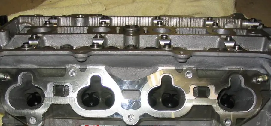

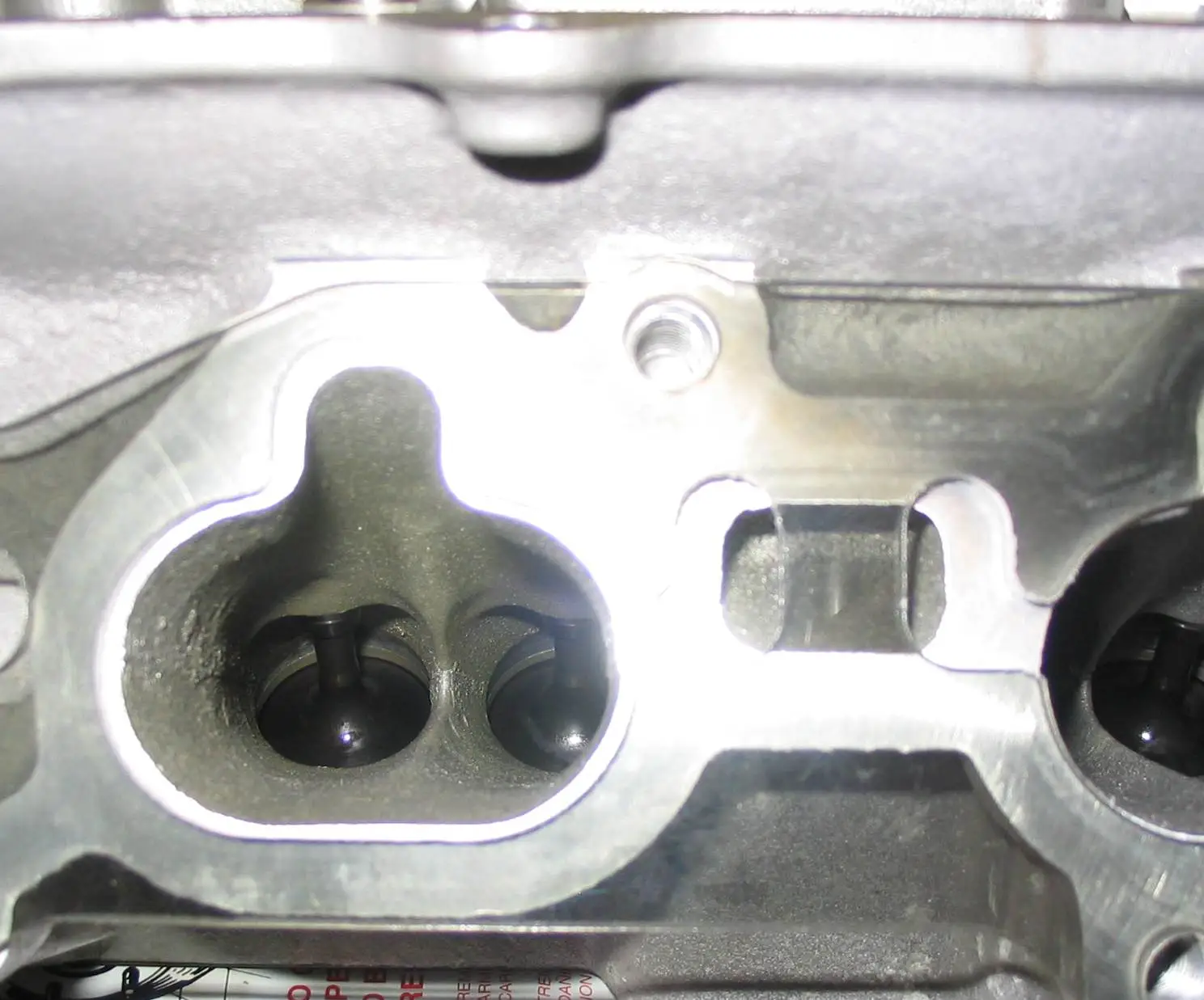

Sweet!!!! Are these port matched to the head as opposed to the IM? I was planning on port matching the IM to the head and if these are already matched to the head, then that's awesome.
When you're ready for these, put me down for one. Looks like I'll probably take just about 1 of everything you put out.(thumb)
They are slightly bigger than the head ports even. They are an EXACT match to the stock gaskets. So you could port the head out by about 1/16" on all edges to match out to the gasket. But the gaskets leave plenty of room for porting the IM without restriction.

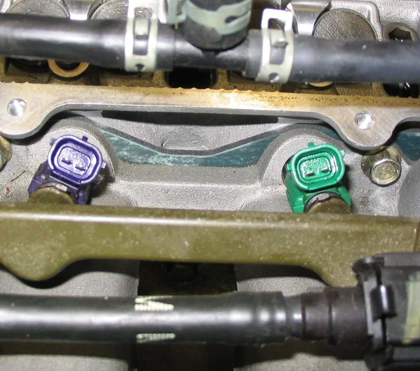

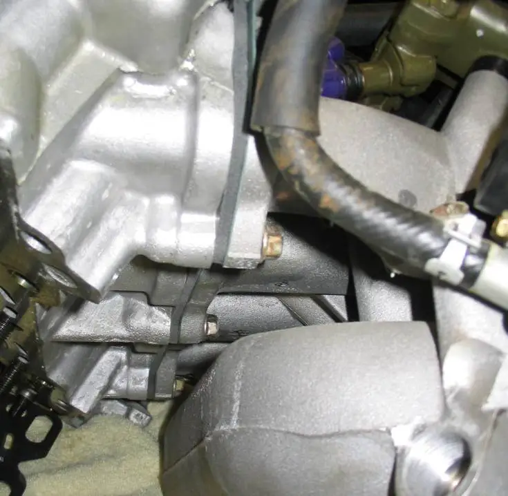

As Chris said we got the first one on his car last night... AND he has CAI intake that use to rub on the master cylinder. With the spacer in there and a minor adjustment of one of the brackets he now has more clearance than he had before! :)
We also measured temperature improvements in the 12-15 degree or better range which is comparable to Outlaw's results. Also, it is hard to say how it directly compares as you don't know where they measured, and since theirs was done on a 94 probe it also effects how the air flows over the engine and so forth (and that makes a MASSIVE difference). So all in all perfect fit, dropped temps, lengthens the runners slightly, improved the intake fit for Chris, and overall very good results from the piece!
