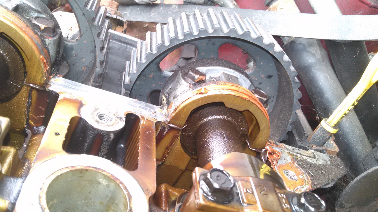

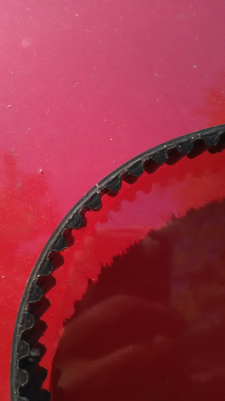

I'm also concerned about the wear on the timing belt, mind you this belt has about 1500 miles on it if that. I'm wondering if it is running untrue and scraping on something.

That may be just the way the belts are made...
You can see the edge.
If there is no new rubber dust in there then it's probably the old belt that left it behind.
You did get new pulleys and tensioner with your new belt right ??
Old pulleys can wobble and make the belt move off kilter.
I took a picture of my old T-belt and it looks scuffed up on the sides as well.
My old pulley and tensioner were quite sloppy and I replaced them. I don't know what my newer T-belt looks like... It's been 3 or 4 years and I haven't had the valve cover off.
This is the T-belt from my parts car..
It doesn't look like it's too bad.
So, rubbing on the edges a bit might be normal but I'm not sure
sigh. Im going to put it back together and remove the cam position sensor and run my fingers on the inside or something to see if there's new residue.

I guess I learned something from your thread in that you can throw a cam sensor code if you skip timing.
It does mention the timing belt in the list of causes for your problem but you would think having it replaced by the professionals at Mazda that it wouldn't be a problem..
Plus it's quite involved to check the timing to make sure.

Well, the timing was way off. The mechanic also said there were bolts and hardware missing from the timing covers and stuff. I'm going one day this week to try to get my money back. I don't expect to, and honestly spending another $260 to not have that Mazda **** up my car more is worth it IMO. Id like to thank pcb for his endless supply of charts and guides, and 323 for the mechanic recommendation and finding the post that stopped me from splicing in another connector to my car lol First 2 pics are how far off the timing was and the last is it corrected.

Just an FYI.. (although it's too late now,... I thought I mentioned it earlier but it must have been a different thread)
You can check your timing with your valve cover off by looking at the timing marks on the cams to see if they point at each other. You can rotate your engine with a socket on your crank pulley bolt (rotate clockwise)
It's kinda hard to see in there at an angle but their are timing marks on the backside of the cams that lineup perfectly with the cylinder head when viewed from the other side.
If they don't lineup, then your timing is off regardless of where your crank gear is at.
If they line up and you think the timing is still off, you need to remove the crank pulley and check the marks on the gear underneath. (the timing marks on the T-belt cover are unreliable.)
