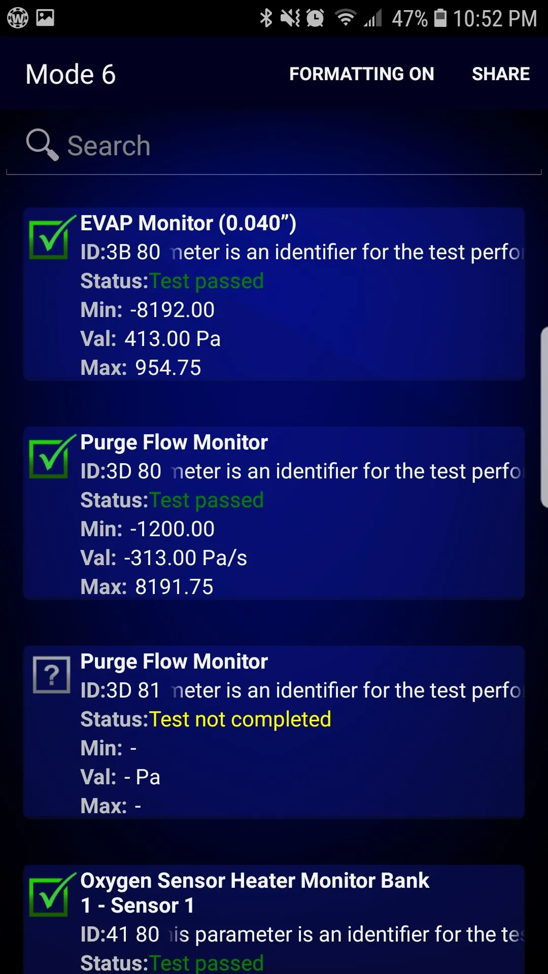

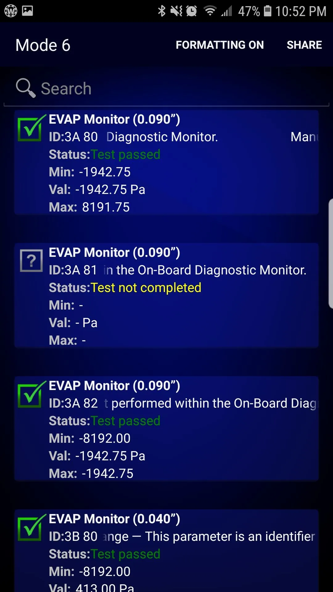

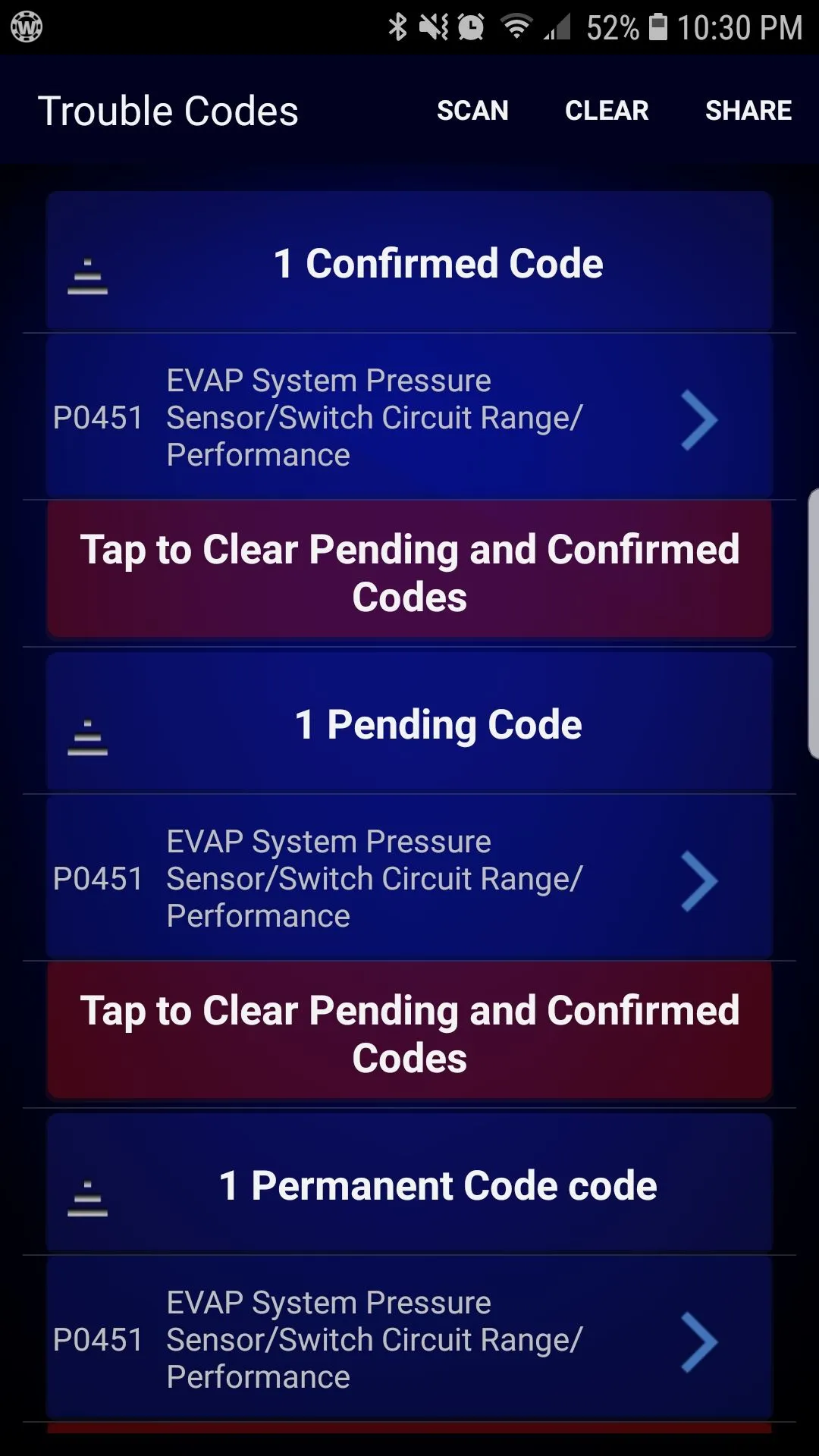

My CEL came on the other day and the code I am getting is P0451 - EVAP System Pressure Sensor/ Switch Circuit Range/ Performance. I have notice it is burning more gas. When I look up this code most peoples solution is to replace the Tank Pressure Sensor TPS but from what I can see is that the 2012 Mazda5 does not have one. Do you think it might be the front or the back Canister Purge Valves parts LF82-18-740 or LF3T-18-741? Has anyone else had this problem? Here are some readings from my OBD2 reader.

Looking again today I think I my have found the sensor part CG36-42-580A. But still has anyone else had this problem?
It could also be the purge valve solenoid, pretty sure it's located under the hood no drvr side of engine. No personal experience but there is a specific method of testing it out that involves blowing through it to see if it's clogged or not.
Would be easier to rule that out than to drop the tank and replace the sensor only to find out your problem was the purge valve.
