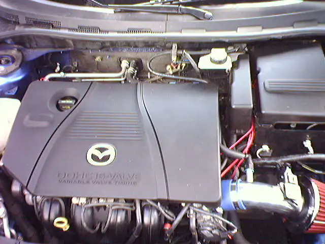

The purge valve is mounted on a bracket with a long hose attached, I am looking at one in my inventory but I am horrible at describing things. I know that they have an issue with holding vaccum
hey would anyone mind circling where I need to be looking for this purge valve? Or if you have a picture of the valve that would help alot too :)
The 3's are notorious about the evap purge solenoid. I have 22,000 mi. on my 04 MZ3 and have had 6 purge solenoids replaced under warranty.
its a 100$$ part from the mazda oem parts vendors here... i believe its down on the tb side of the engine about half way looks like a lil ufo thingamagij... and yes thats the real name.
