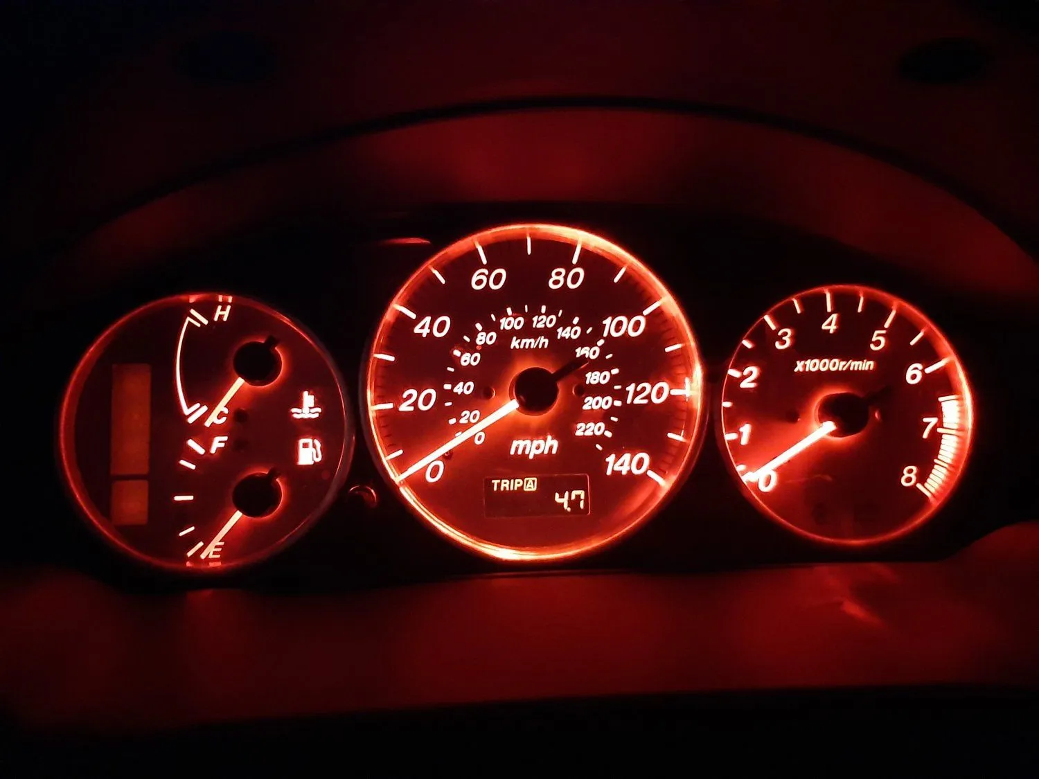

Here's a picture of my gauge cluster and it's not even dark outside yet :)

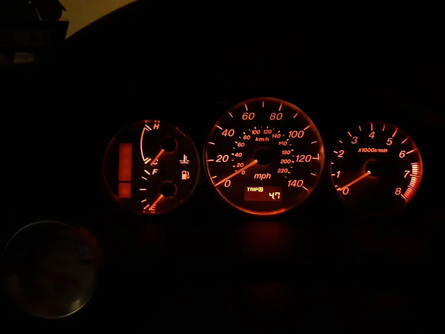

Alrighty......was able to remove the upper mounting bracket and maneuver the whole cluster upside down and flipped over to access the back and find the other 2 bulbs and get them all going without removing any harnesses. Diggin the results....................
before...............
after.......................
Both pics are full brightness on dash knob. Should be able to turn it down a bit now with the LEDs.
