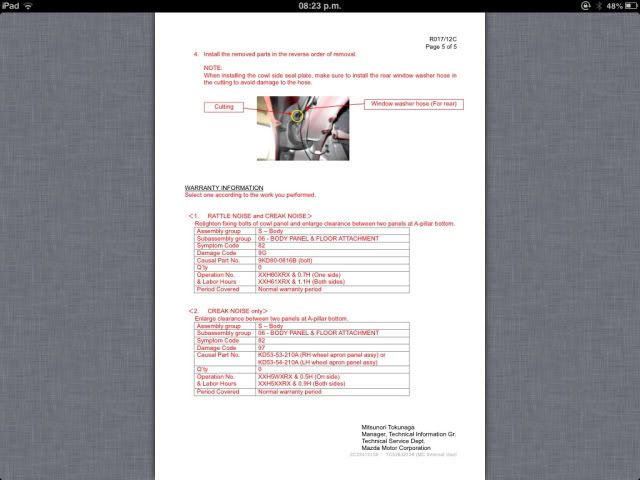

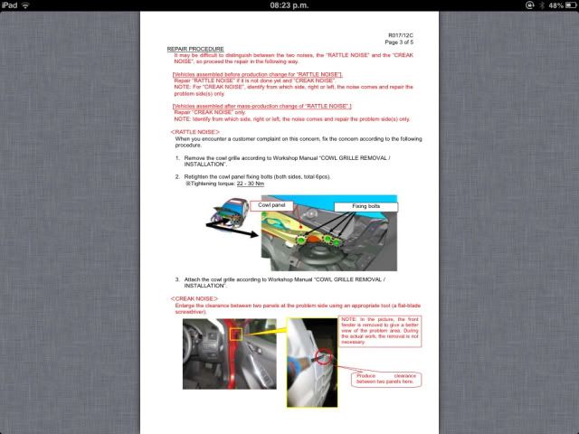

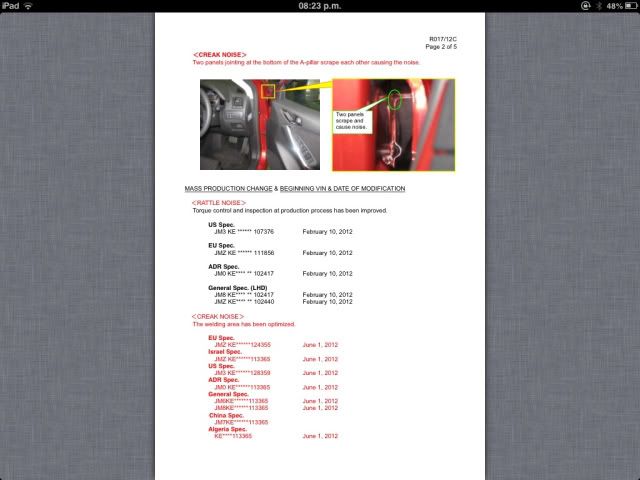

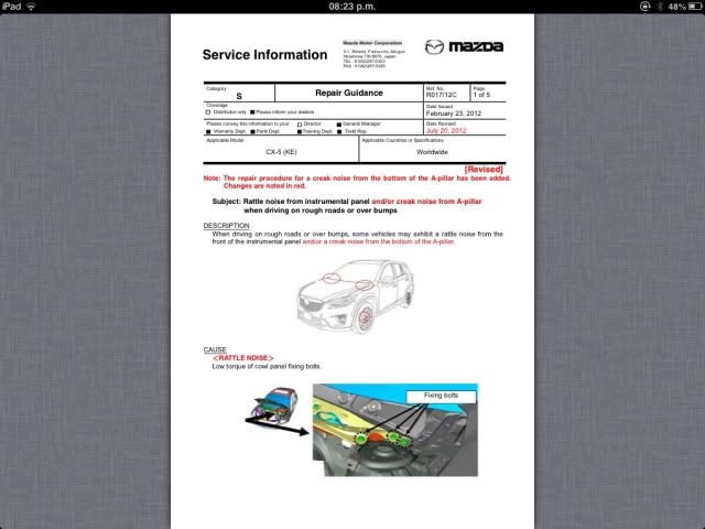

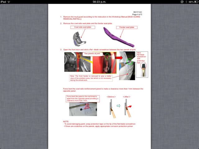

I had same problem on my CX-5 thought it was suspension or strut issue. It really bugged me going over bump roads, speed bumps, etc. I found this TSB and dealer performed the service and problem has been corrected. Mine turned out to be the A-pillar listed below. All is quiet now.
TSB 09-009/12
APPLICABLE MODEL(S)/VINS
2013 CX-5 vehicles with VINs lower than JM3KE******128359 (produced on or before June 1, 2012)
DESCRIPTION
While driving over rough or bumpy roads, some vehicles may exhibit a rattle noise from the instrument panel and/or a creak noise from the A-pillar.
Rattle Noise From Instrument Panel:
This noise may be caused by low cowl panel mounting bolt torque. The bolt torque control and inspection has been improved during the mass-production of vehicles with VINs JM3KE******107376 (produced February 10, 2012) or higher.
Creak Noise From A-Pillar:
This noise may be caused by two joined panels scraping together at the A-pillar. The panel weld areas have been improved during the mass-production of vehicles with VINs JM3KE******128359 (produced June 1, 2012) or higher.

I had the same clunking sound and found this service information and took it to the dealer and had it serviced. They were not aware of this issue and asked me if they could keep the information. Unfreaking believeable!! Anyway here it is hope it helps. I do have it on pdf just Send me a message with your email and I'll send it to you.
