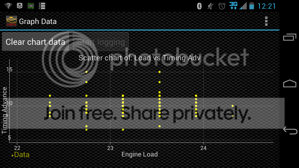

Here is some data from timing.
Warm Idle
2nd Gear WOT (full throttle at least!)
<a href="http://s1337.photobucket.com/user/f1yen/media/Screenshot_2013-07-08-17-29-30_zps089f6a54.png.html" target="_blank"><img src="http://i1337.photobucket.com/albums/o662/f1yen/Screenshot_2013-07-08-17-29-30_zps089f6a54.png" border="0" alt="2nd gear WOT photo Screenshot_2013-07-08-17-29-30_zps089f6a54.png"/></a>
2nd Gear again WOT
<a href="http://s1337.photobucket.com/user/f1yen/media/Screenshot_2013-07-08-17-24-54_zps7856bf1c.png.html" target="_blank"><img src="http://i1337.photobucket.com/albums/o662/f1yen/Screenshot_2013-07-08-17-24-54_zps7856bf1c.png" border="0" alt="2nd gear WOT2 photo Screenshot_2013-07-08-17-24-54_zps7856bf1c.png"/></a>
As seen from the 2 WOT runs, the jump in timing (different rpms in both runs) in lower rpms may be relating to timing being pulled.
The timing seems to progress fine once 4k is hit.
