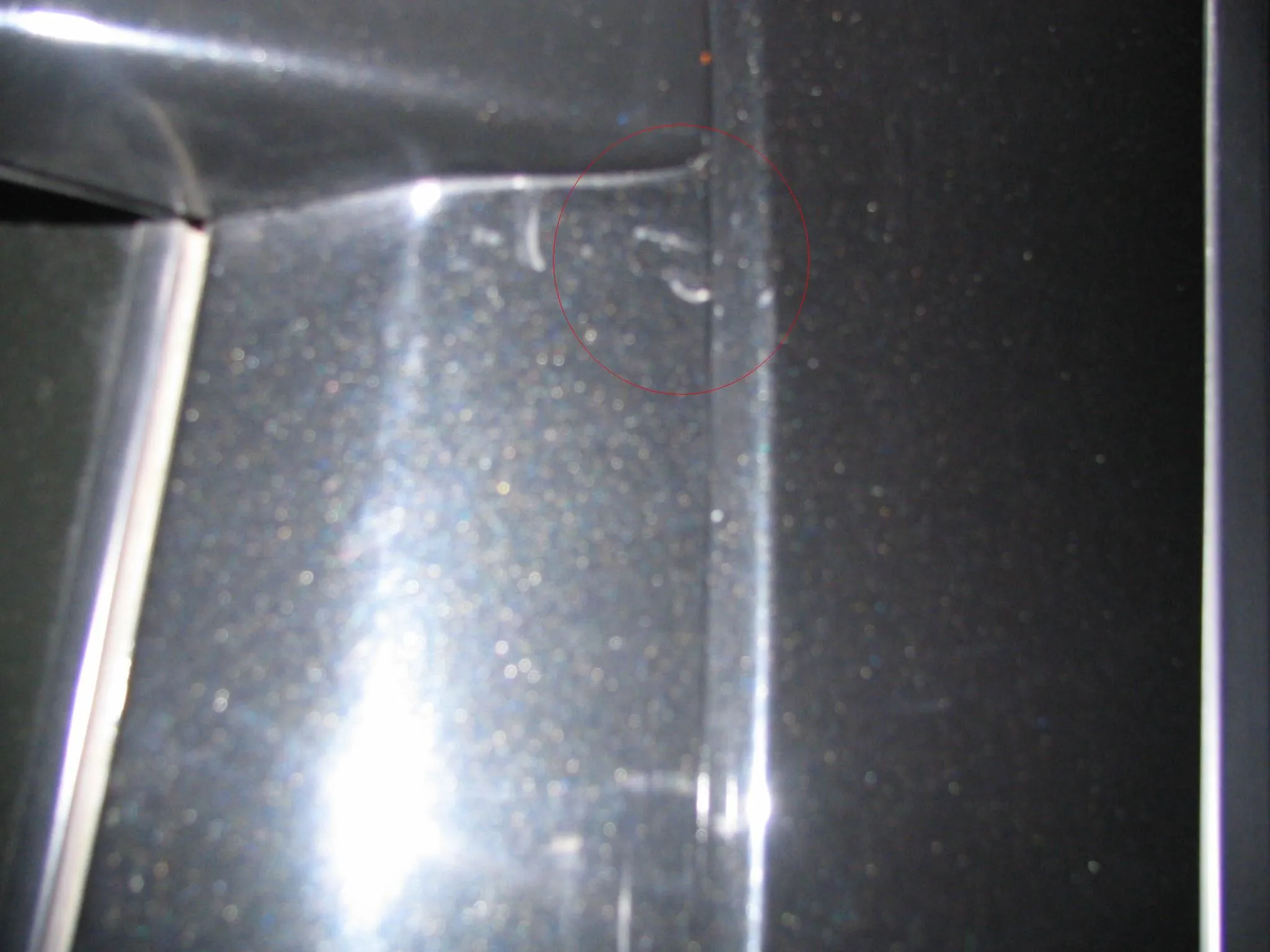

i have a 02 p5 and my clear pealed on my hatch under the spoiler ... i dont know if its commun ? anyone have the same probleme ?
Do you have a pic? I see we've got teh same year and color.

there. its not really clear in the night , sorry
