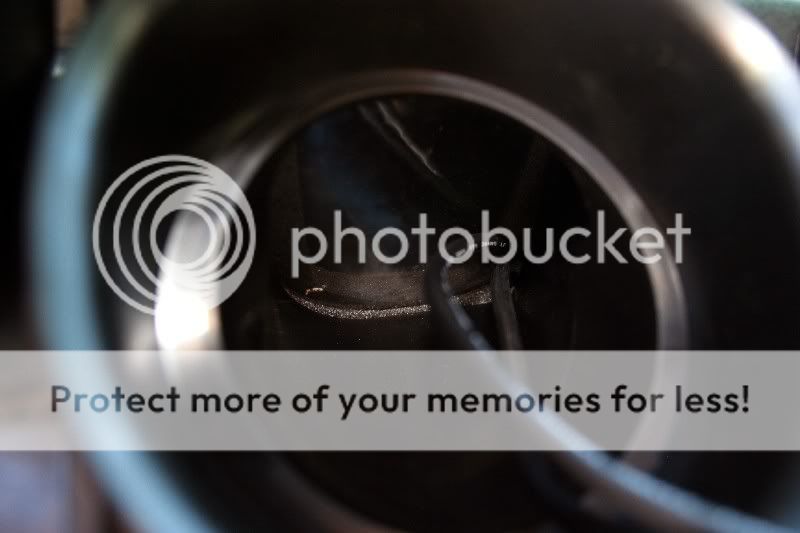

I posted pics in my thread with the block off plate that I used. Here it is again to show you the proper way to do it.....using just foam still might let air through and I did not want to risk it.
The plastic is clear so it is kind of hard to see. I lined the outside of the plastic with another strip of foam, the same as Mazda uses. Then I ran the wires between those two. Perfect seal.
