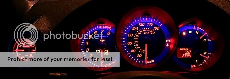

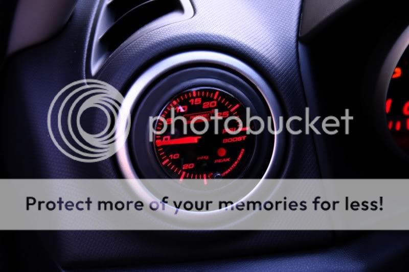

Ok so I tried to tackle the project that Voicekoil first did. All went well...here are some pics. Opinions welcome.
Off
On
Night On
Full gauge shot

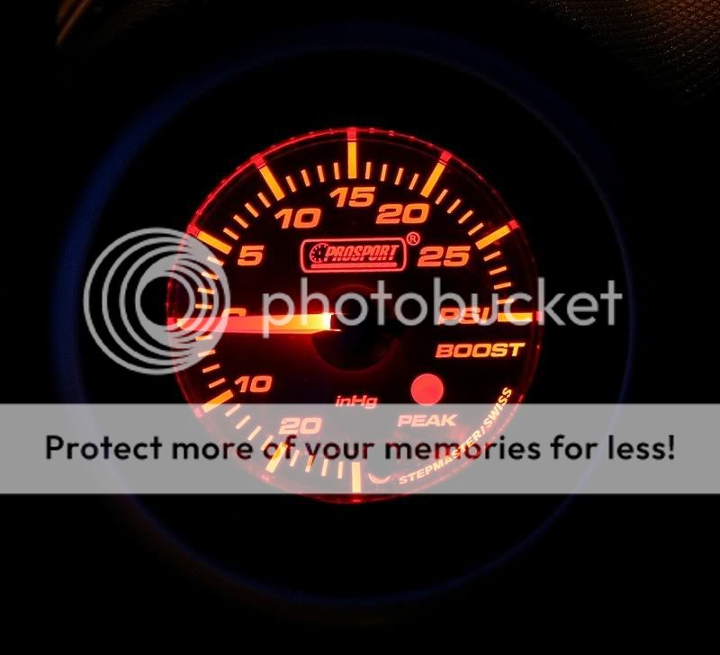

Picture of heater block off if anyone is interested. Notice the extra foam, the wires run out between the stock foam and the plastic blocking plate.

Man that looks great! Does the gauge just fit right in there? Did you have to fabricate any other mount around the gauge to get it to fit? Oh yeah, is that electrical or mech. gauge? Looks really good.... tks, Mike
PS - I thought the Prosport gauges come with a silver trim ring?
Thanks for all the positive responses! As far as fabricating goes it is pretty simple. I picked up a PVC cap from Home Depot. Cut the guts out of the vent. Used a 2 1/4" hole bit to drill out the PVC to install the gauge. Then glued it all together with plastic weld. Sounds complicated but once you get hands on its no problem.
Yes the gauge bezel ring was silver but I wanted it to match so I taped it off and sprayed it with an ultra flat black.

so what exactly do you need to do? just pop off the air vent, and run the wires through? do you need to take anything out? then just get some kind of cap or something to fill in the gap. looks super good man.

Hey Scott, do you have any addt'l info on the PVC cap from Home Depot? Like size or part num. or even a picture? Would like to duplicate this myself. Also, was it difficult to route the wiring out of the vent tunnel so you can hook them up? Thanks! Mike
Routing the wires were easy...no issues there at all. Um I dont have a part number on the cap. Just go to the PVC pipe area. Look for a black end cap.....maybe 3"s in size....not too sure didnt measure it. Let me know if you have anymore questions.

Yes in the third picture you can see the block off plate. Its clear plastic but its there. No problems what so bit.
