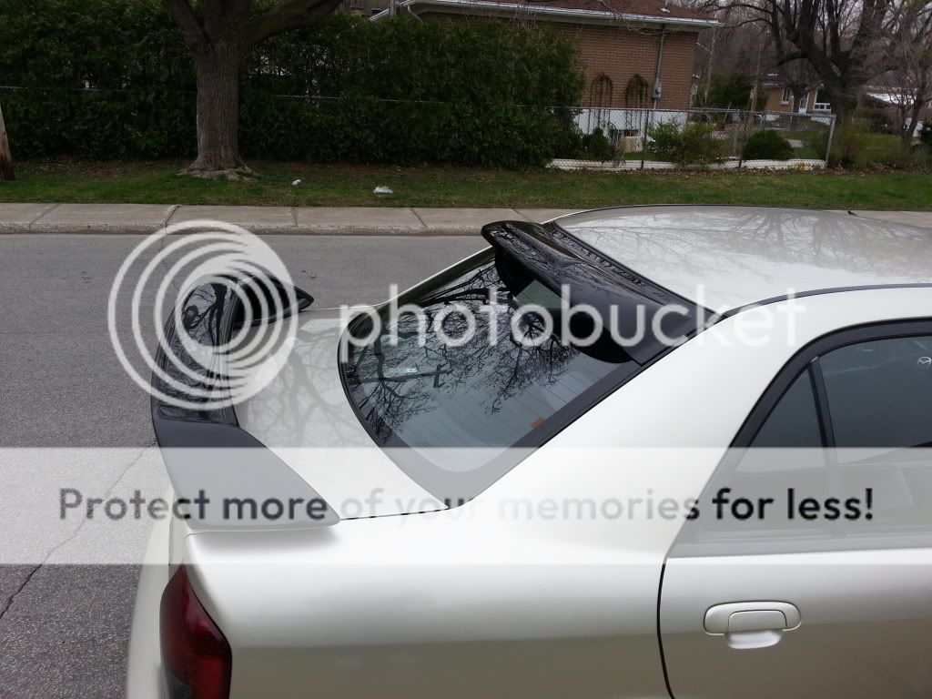

I got a question for you, when you installed your msp spoiler was it 4 holes in total? Did you use the marking on the inside of the trunk to drill? (There's like 4 small indents on the inside of the trunk). That's pretty much where mine are drilled so I'm hoping the msp spoiler is a straight bolt on with my regular sedan spoiler
In total it was 5 holes. 2 screws on each side which i did use the marking inside of the trunk to drill on. And you need to drill another hole on the driver side to pass the break light wire. I think i used a 1/4 drill bit.

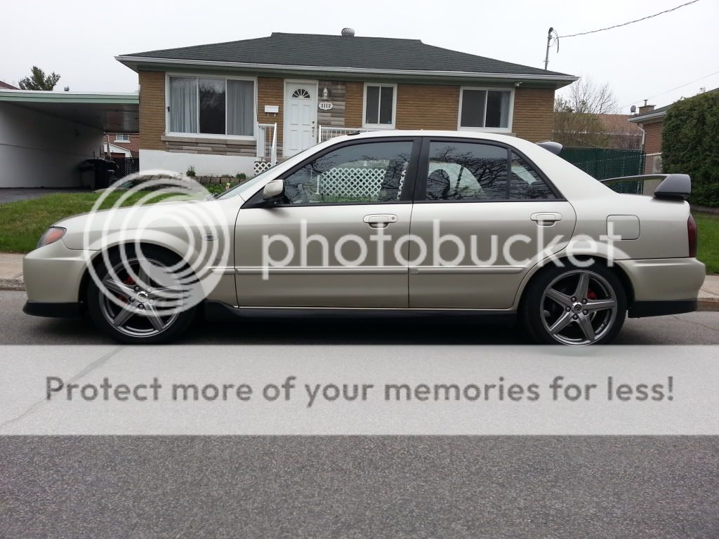

My newest arrival :) That thing is super sweet! Thanks to Alex (ScratchNSniff)
And yeah, i cant go in my driveway facing backwards anymore.. lol
Ill get more clear pictures tomorrow in the daylight
Yes exactly, you will need 01-03 front end links. So the 10.5 inches ones.
thanks man! Hopefully the spoiler fits with my existing holes, might need to drill one more hole for the wires, i forgot if i drilled 4 or 5 holes before.

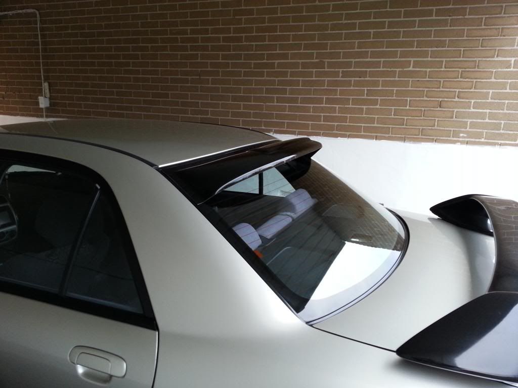

btw the roof spoiler looks awesome, finally some proper close up pics with different angles of it.
As far as the end link issue I would get 2002 Ford escape front end links. They are thicker than Mazda ones, plus half the price and they are moog so lifetime warranty, a great option I'm glad I went with!
those are the exact same locations as my standard wing, awesome

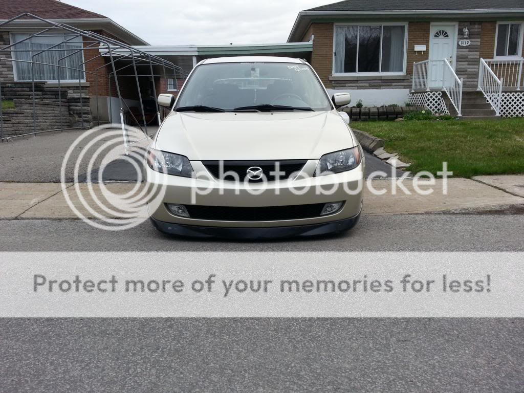

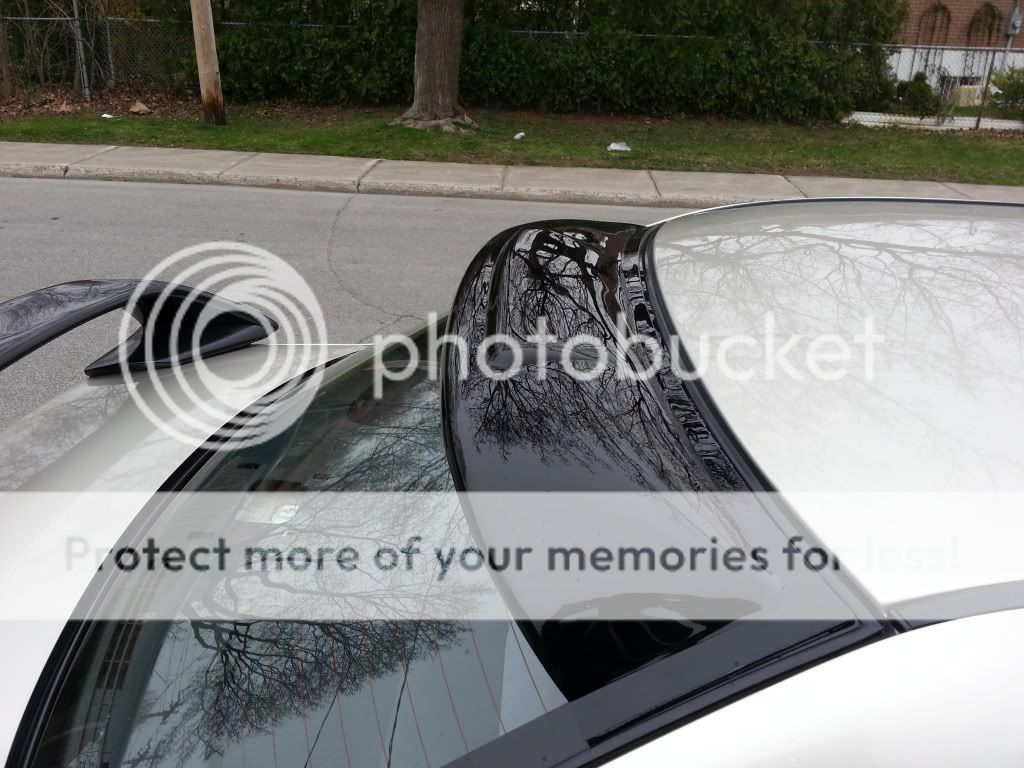

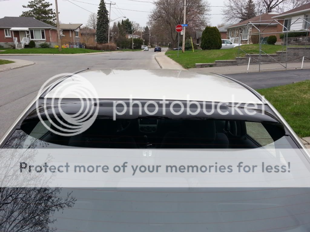

As promised, here's a few more pictures :)
Sweet!! Your protege looks sick with the racing harts. I picked up a set last weekend but I need to complete my 5 lug swap before the install. Keep up the good work :)
Looks good! Got my rear window visor on today as well. We both have the visor/03.5 wing combo.
I know I've said this before but I want that front lip so bad! Mine would almost be that close to the ground normally haha.
