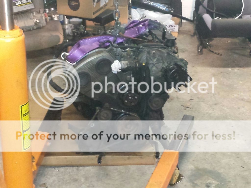

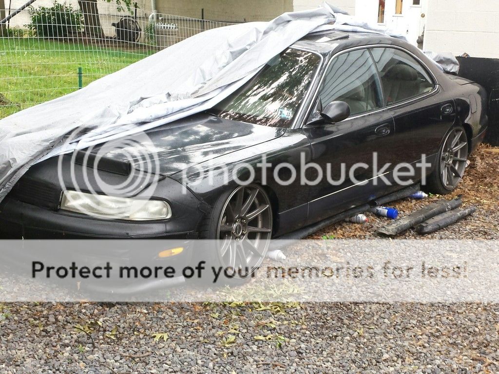

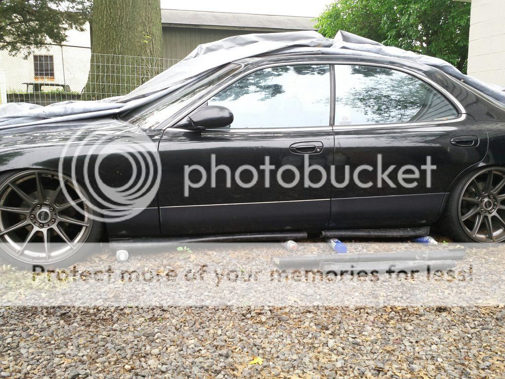

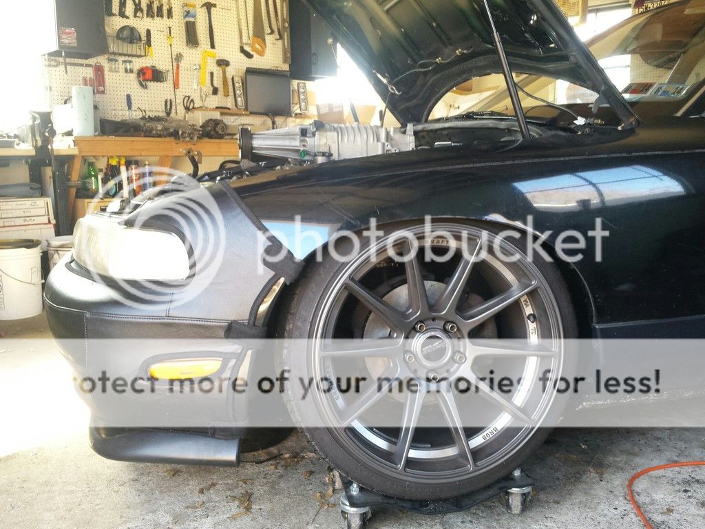

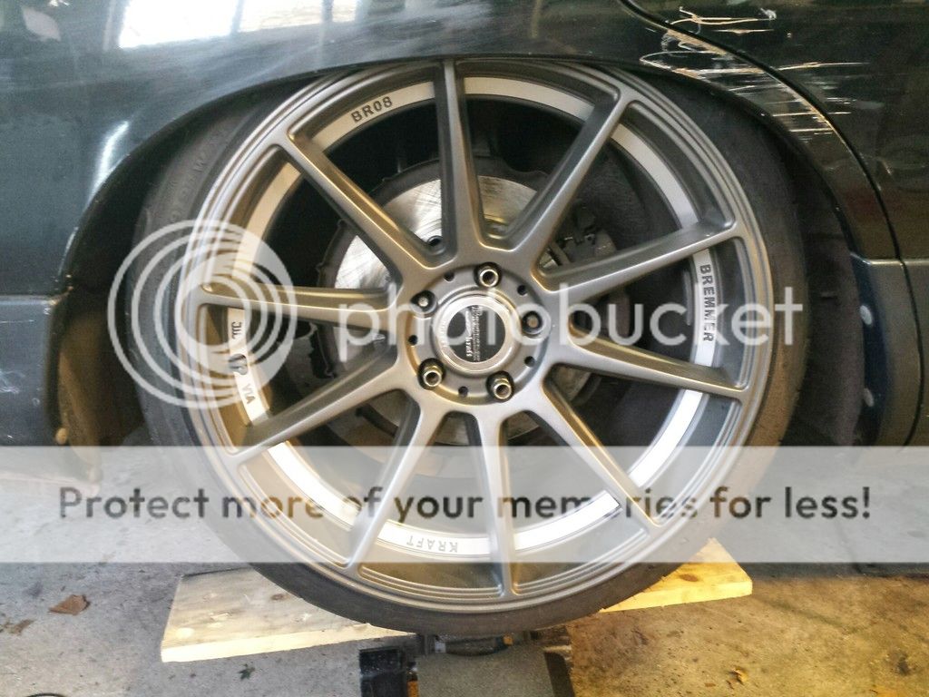

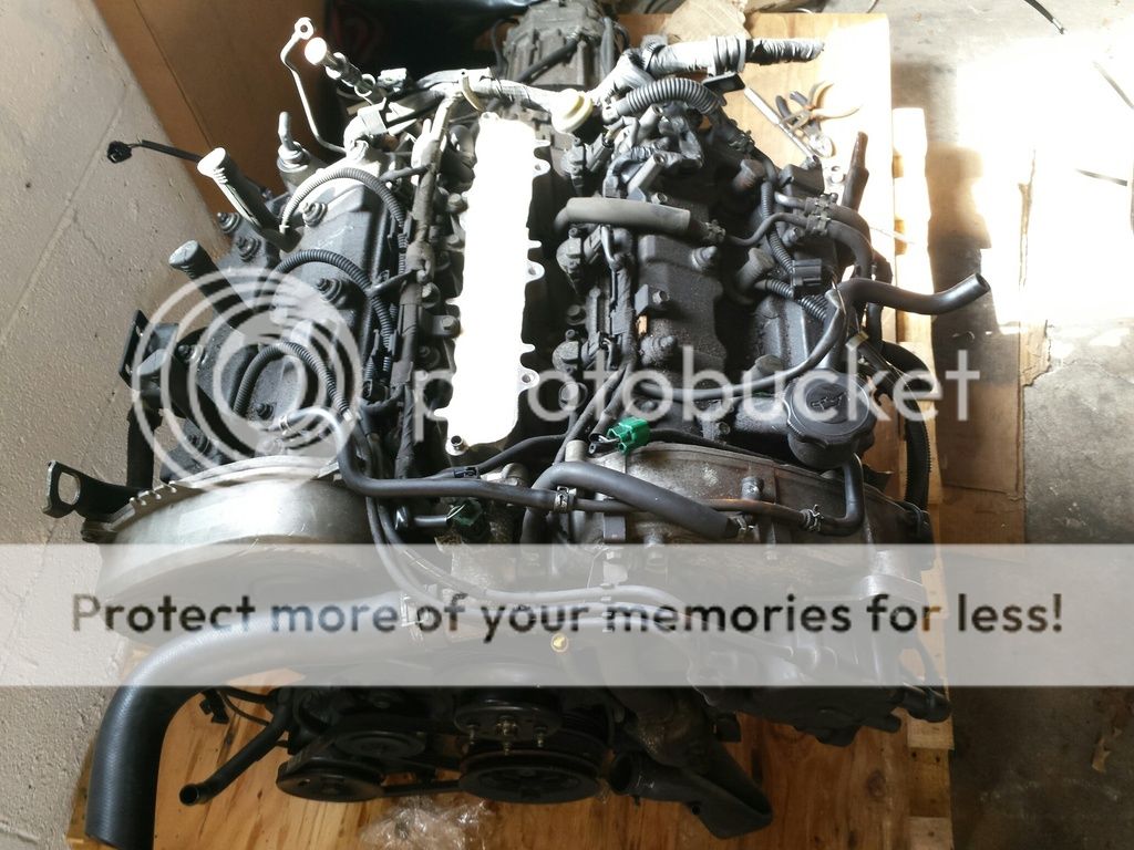

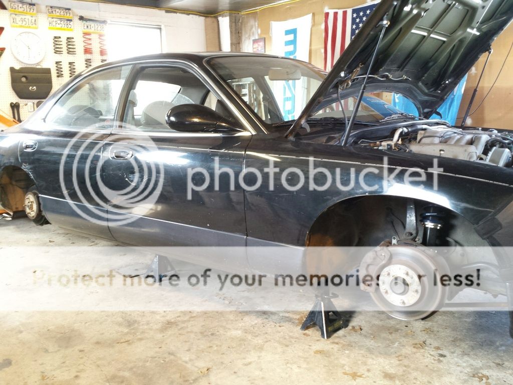

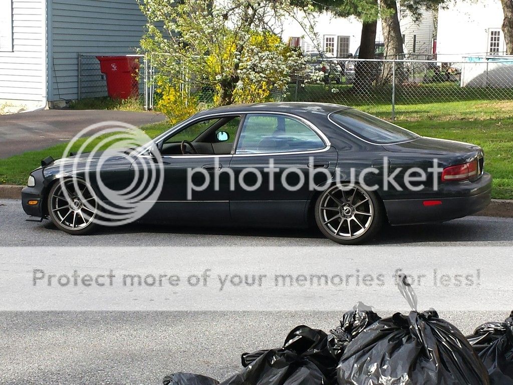

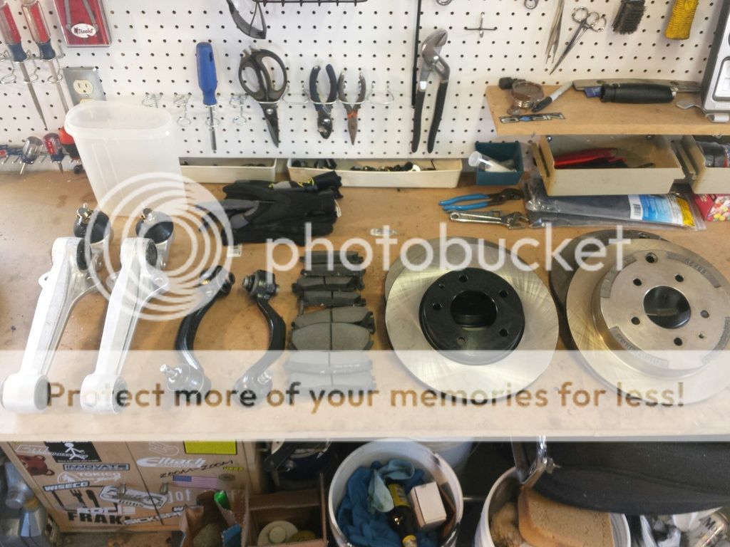

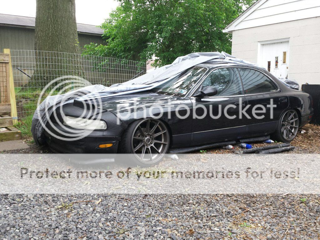

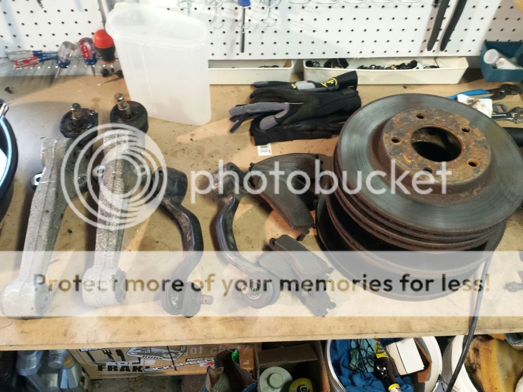

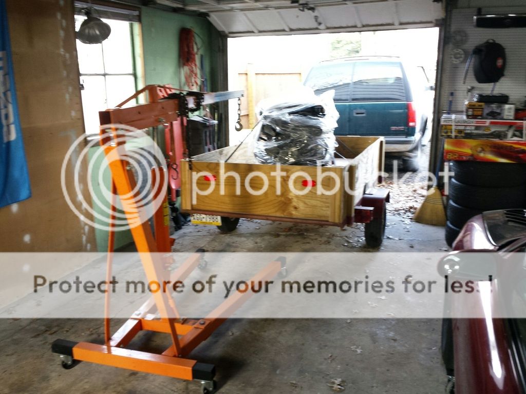

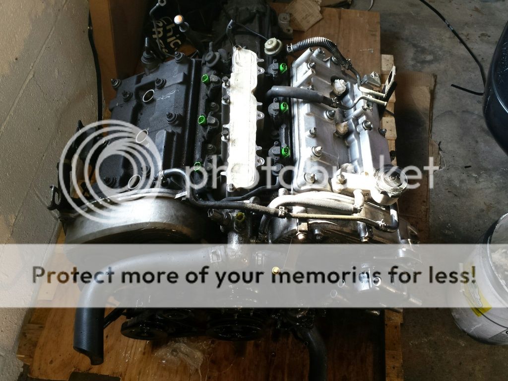

Been busy. Got a new motor and transmission a while back. Apparently the slightly more powerful JDM version but I haven't really compared to the one in my car yet. Took 10 days off work and started ripping into her with my buddy. I swapped the front and rear coilovers around some so I could have better up/down adjustment front and rear. Before I was max down in the front and max up in the rear. Now I have the same drop and I can go either direction. It could lay on the floor if I wanted her to. I replaced upper and lower front control arms and did all 4 brake rotors and pads.
Ended up a bit low. LOL I had to raise it some fron here.

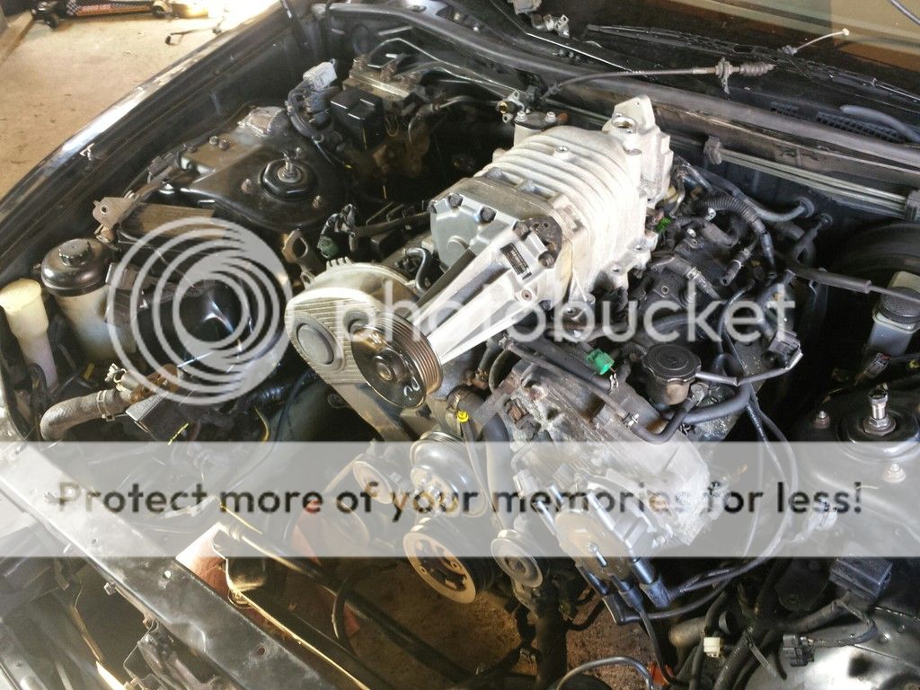

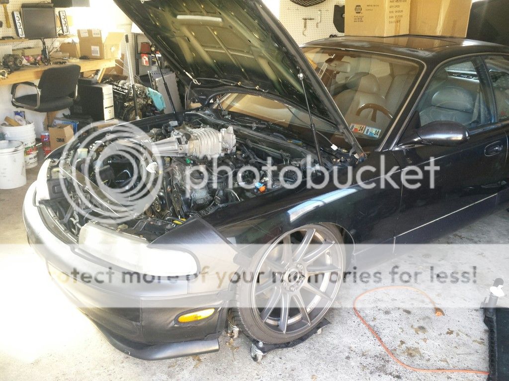

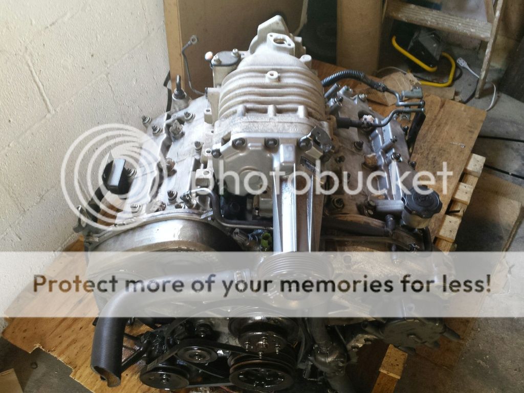

I picked up this M90 supercharger locally for a future project. I think I have it all figured out just need to find someone to make me some parts.
I think hood clearance is going to be an issue. LOL nothing a nice scoop and/or motor lowering or even hood spacers can't fix.

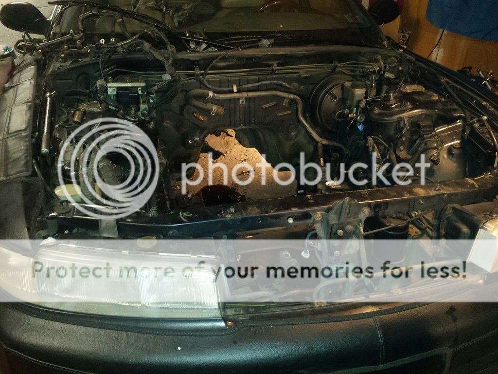

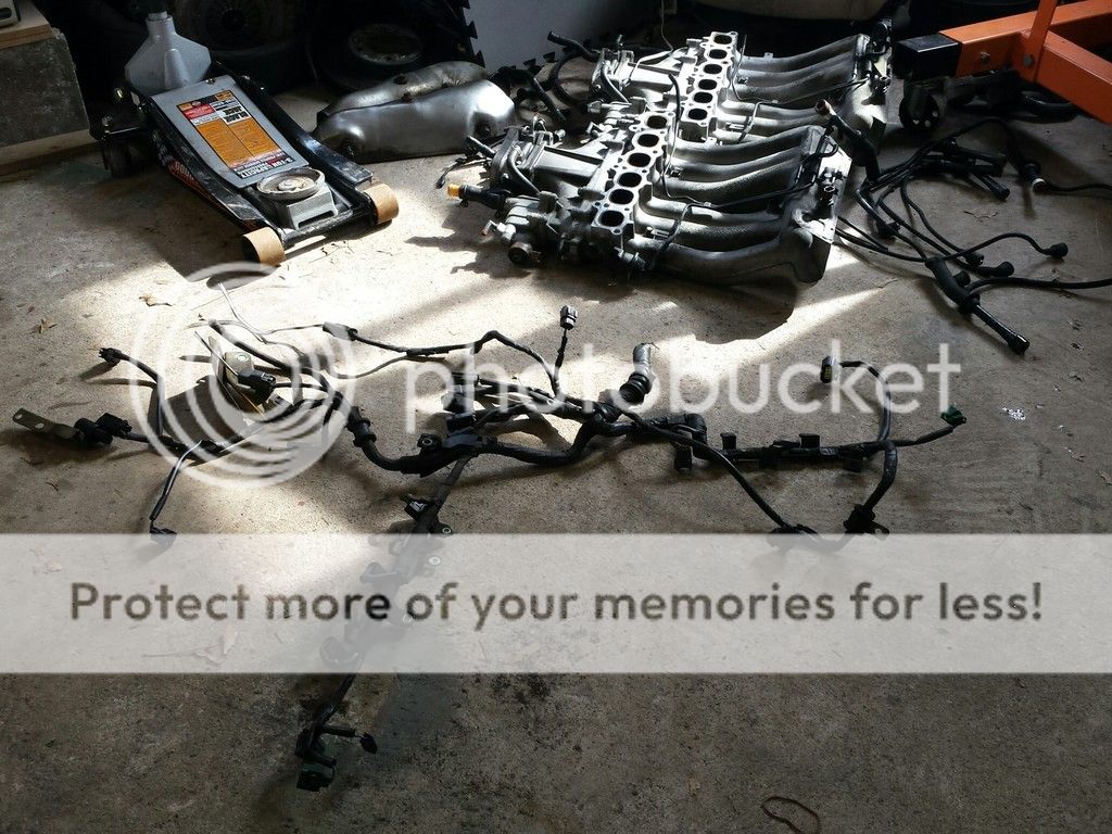

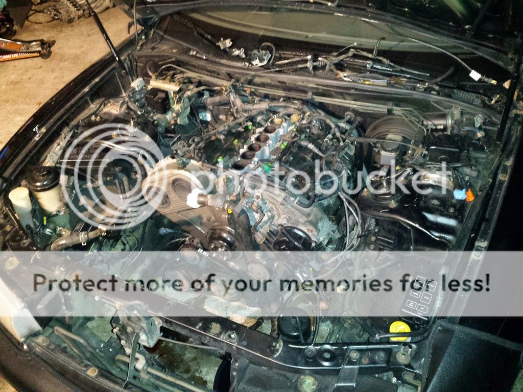

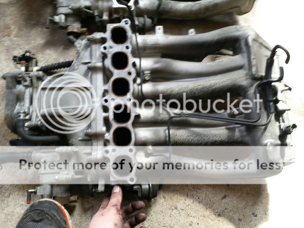

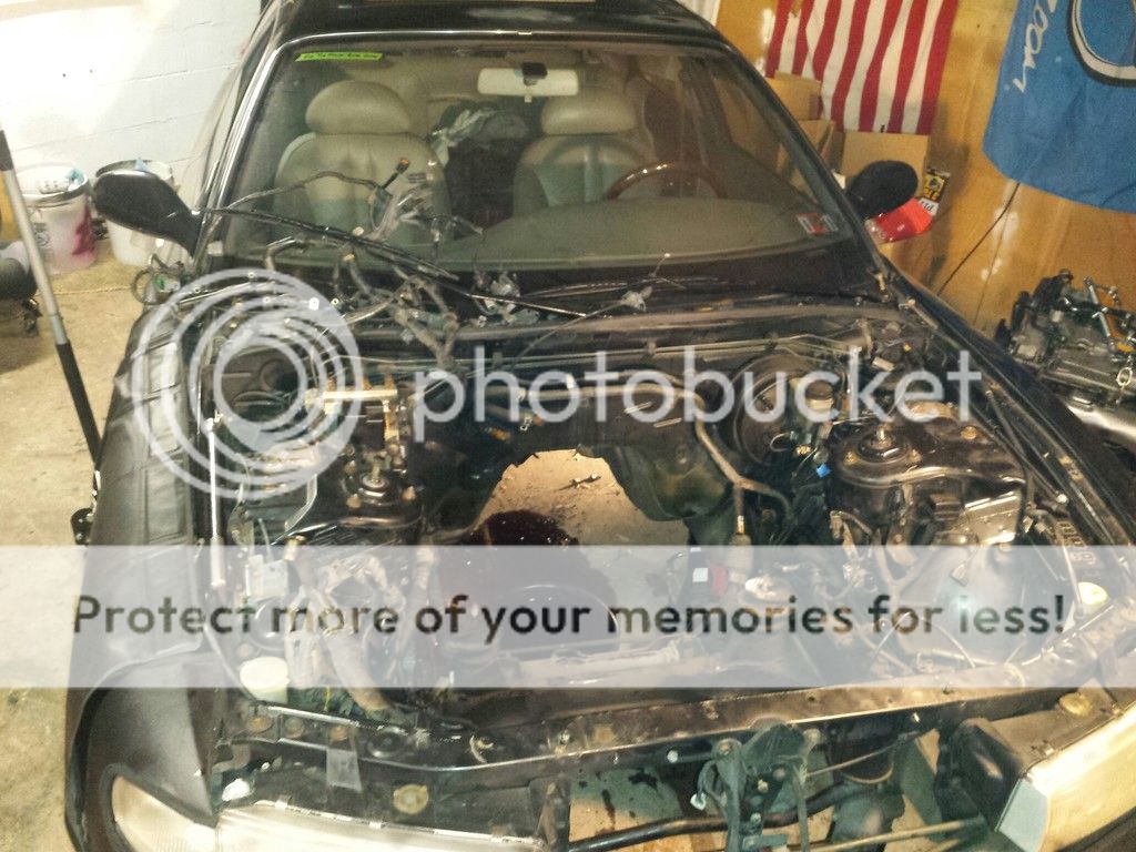

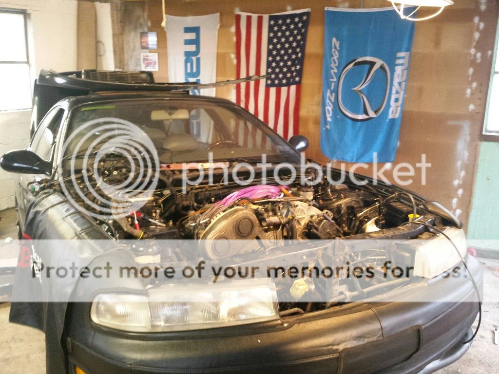

So far I have been prepping and cleaning the new motor to go in. Got all the wiring harnesses off both motors so we should be able to at least get the old motor out tonight. I've completely removed the air conditioning system as well as cruise control. Then I went through and removed a bunch of unnecessary brackets and such from the engine bay. I'll be relocating the battery to the trunk and putting some jumper terminals in the bay by the radiator in case the battery goes dead (electronic trunk popper and no key mech anymore). I've got a new radiator coming because the old one is toast. I'll be installing two pusher style electric fans to replace the stupid large mechanical fan that was on the front of the original motor. The electric fans will be powered by a switch relay with an in-line temperature sensor telling them when to turn on and off. Should work like a charm. My thermostat opens at 180 degrees so I got a sensor that will kick the fans on at 210 and turn them off at 195. If that leaves the temp needle too high I have a 200/185 switch I can replace it with.
2009 Mazda3 hatchback, 1994 Mx-6 w/ a turbo, 1993 Mazda 929

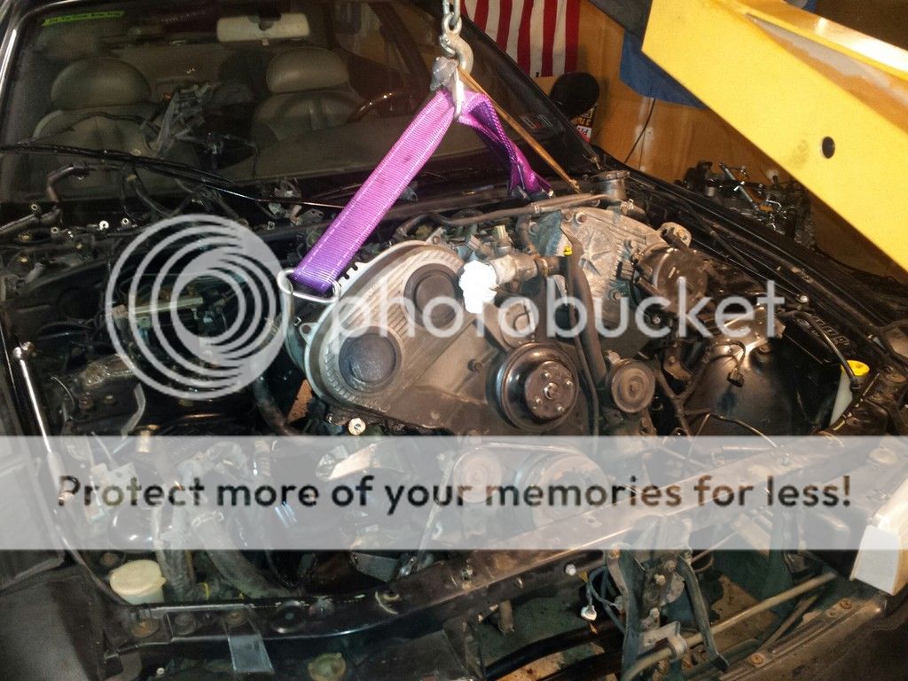

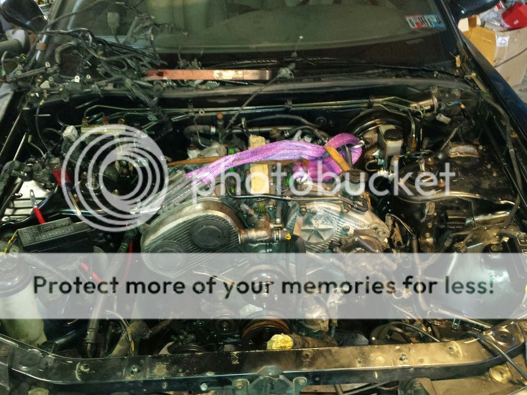

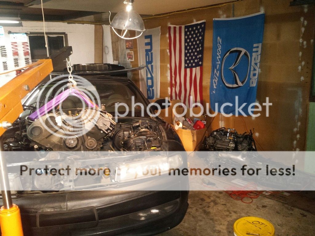

Got the old motor out and the new one in and wired up. Worked into the early morning hours with my best friend and most of today after a few hours of sleep.

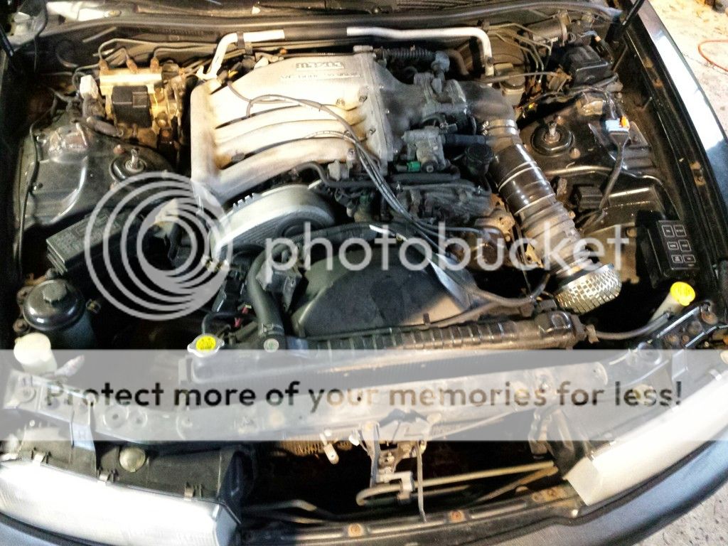

The motor is in and it even fired right up on the first try! The new motor is STRONG! It can drive on its own but I need to finish installing a new radiator with electronic fans. Not really a hard job just don't have time right now. Once that is done I need to get her to my buddy to fabricate a new exhaust. It's loud because I broke some exhaust flanges taking everything off for the swap.

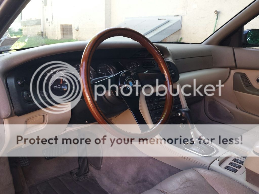

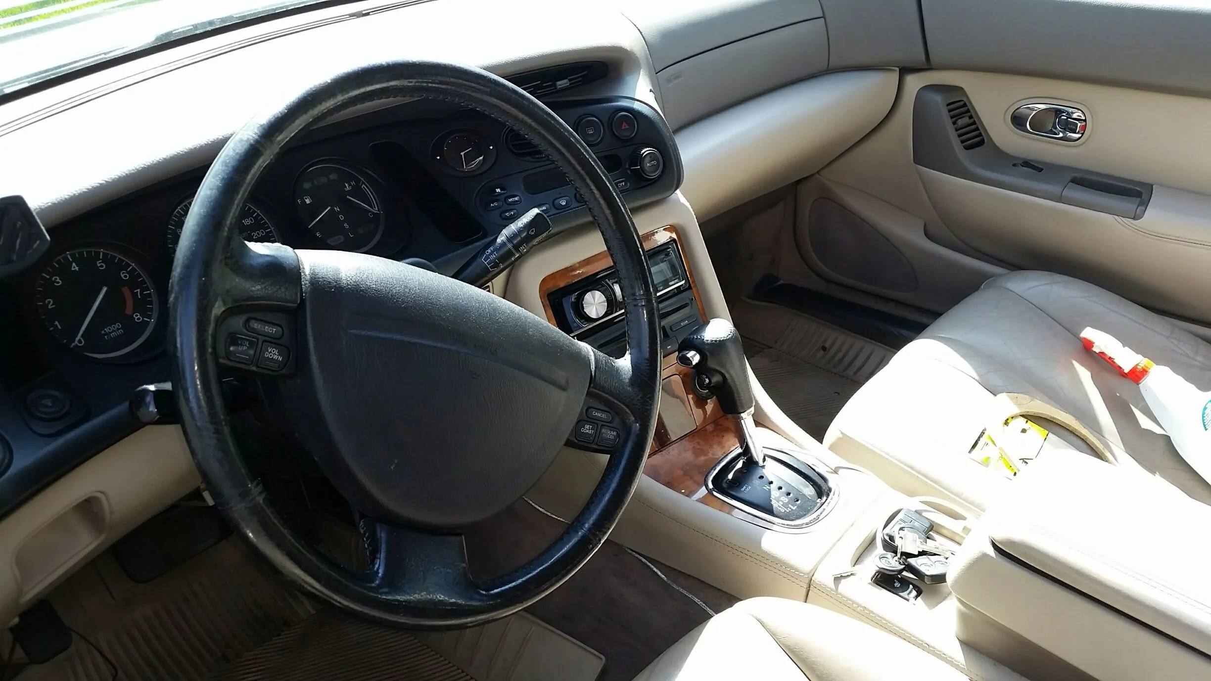

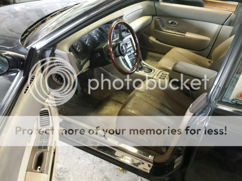

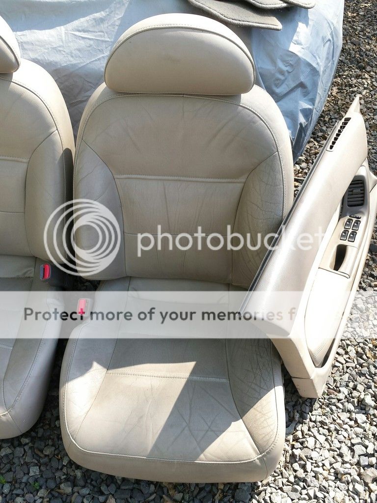

I also realized I have never posted any interior pictures. Here's the interior. I added the wooden Nardi wheel to give her a more vintage feel. I also stumbled onto some OEM polished door sills on ebay that say Sentia on them and snatched them up! They're like the ones that the mx6 had but polished to a nice shine!

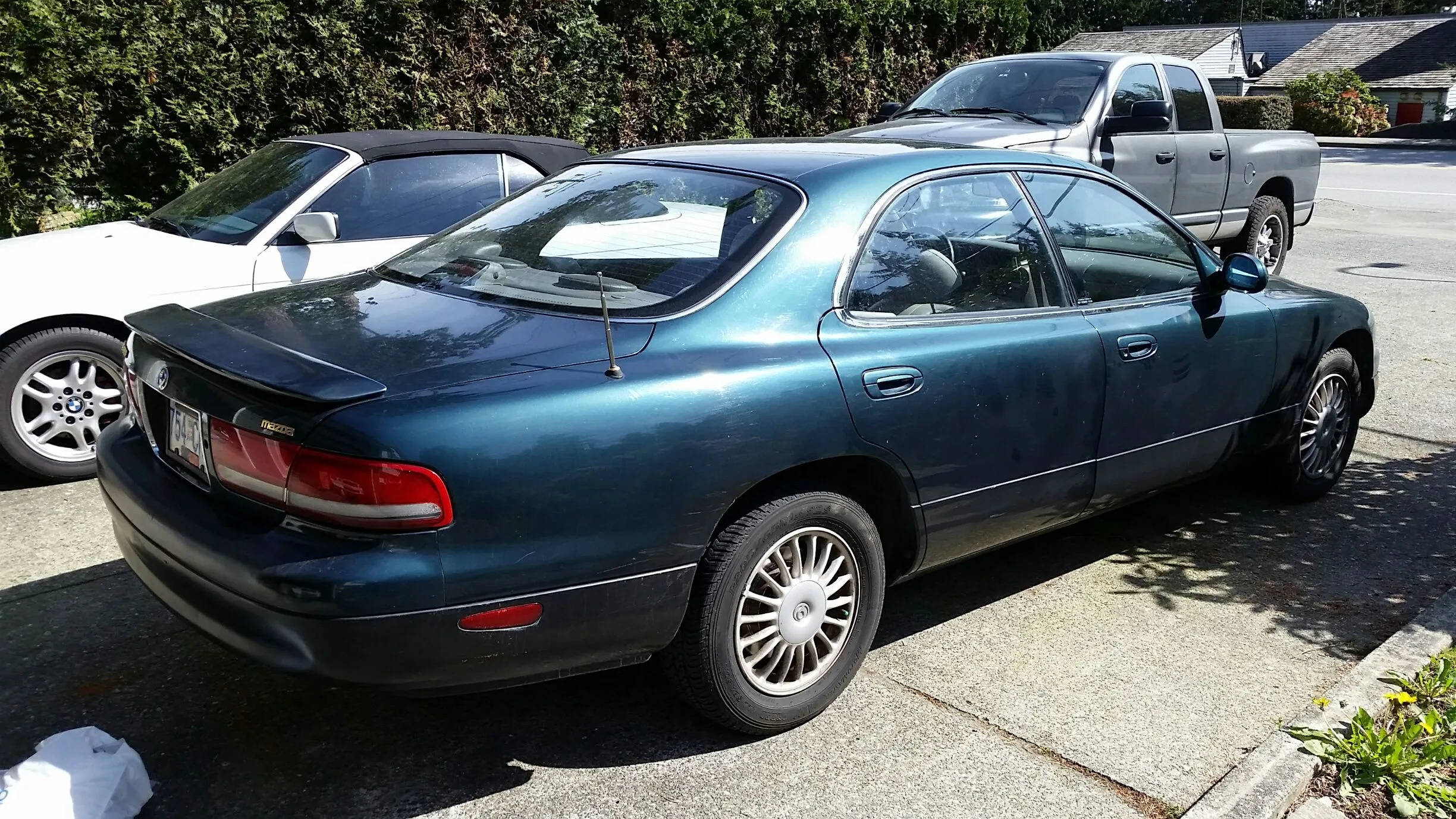

Well here's some pic's of the green beast. This is what I'm starting with. All I've done so far is replace the head unit with a temporary one until I get a double din touch screen and replaced all the speakers. The factory ones were "all" shot, the foam on all of them disintegrated lol. The power antennae doesn't work so I'll work on that soon. I'm starting with some comfort items so I can drive it for now :) Eventually I'll start tearing stuff down.
It runs fine but has a slight shake at idle, not quite a miss or dead hole... has new plugs, leads and distributor cap. Do these things normally idle like that? Also, this thing shifts hard, almost like it has a stage 2 shift kit in it! I know nothing about these cars but, is that normal?? 20150407_143420_resized.jpg 20150407_143429_resized.jpg 20150407_143451_resized.jpg 20150407_143507_resized.jpg 20150407_143525_resized.jpg

The idle on mine is pretty good. I haven't run the new motor much yet but the old idle might have had a few stumbles. The car also had a bunch of valve tap and smoked a lot so it had some other issues then too. Mine did shift pretty hard too. There is a transmission cooler in the radiator and automatic transmissions shift a lot harder when the fluid is cool. Especially hard before everything is up to operating temperature.

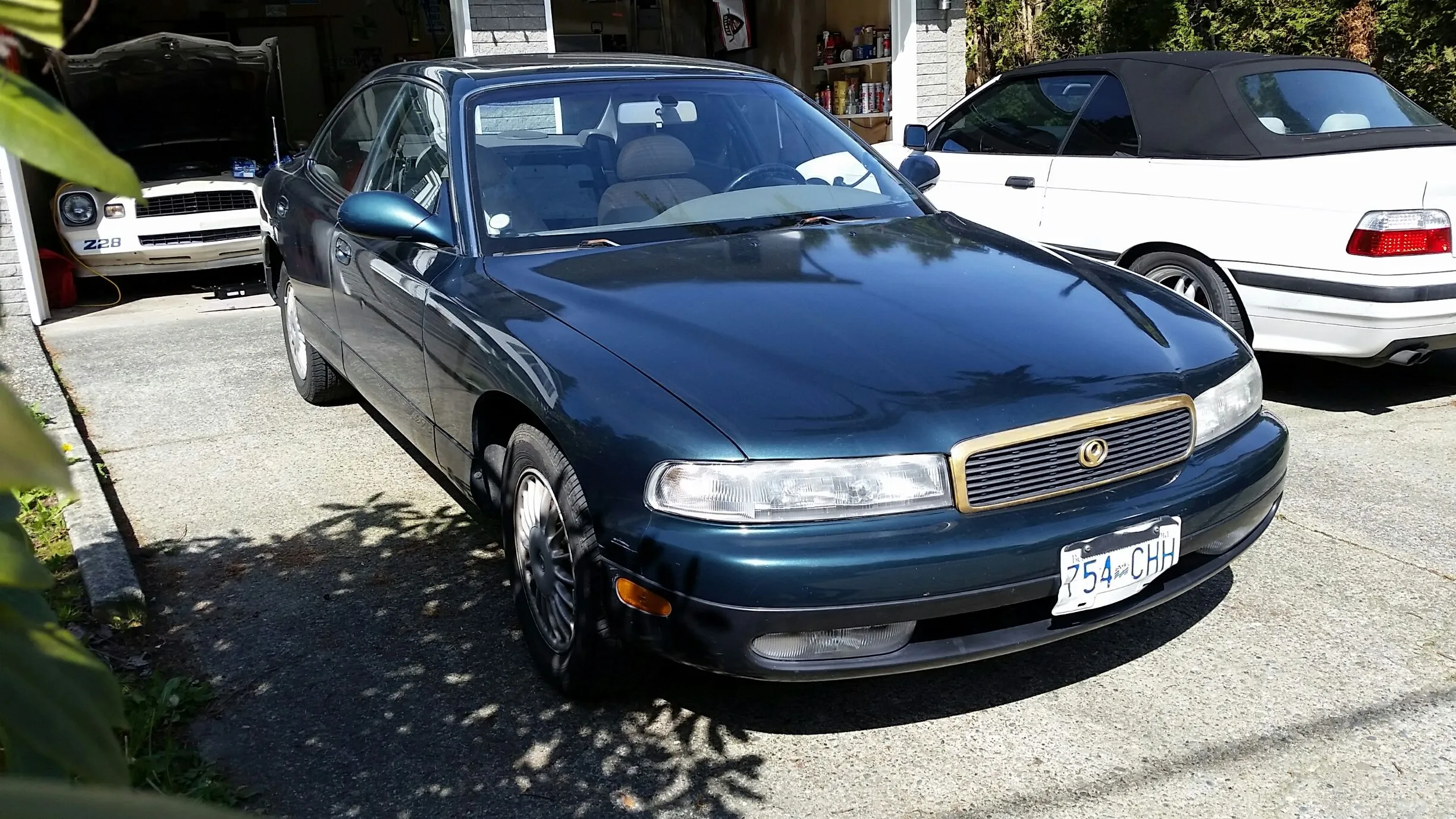

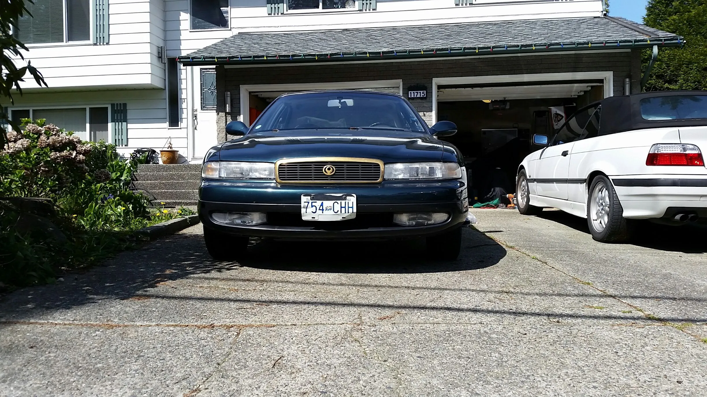

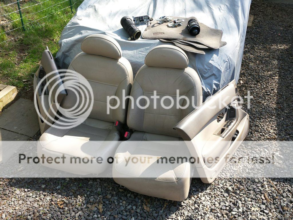

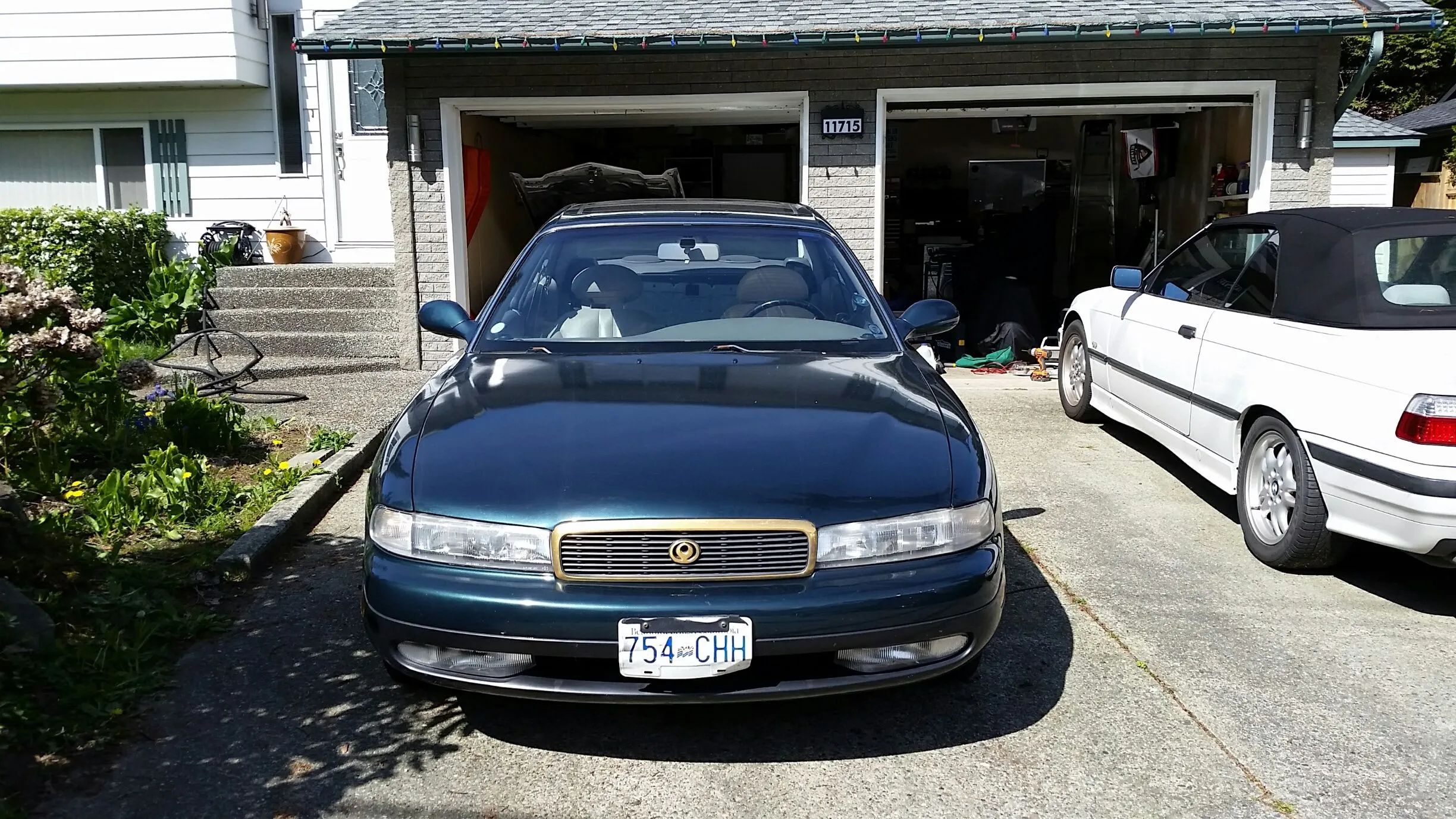

A few semi recent pictures and some new parts I picked up off a 929 in a local junk yard. I love how this car is coming together. My interior will be basically mint and the exterior is looking great as well.
