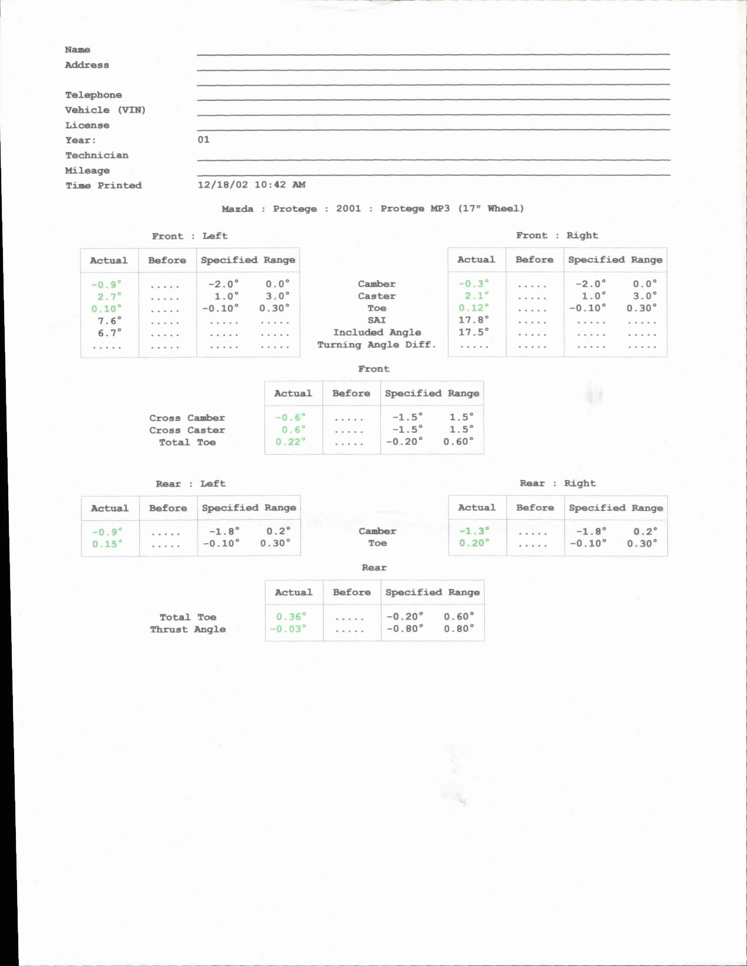

Hey guys need some feedback...
What do you guys think of these settings for camber, castor, toe, SAI etc...got it done from Curreys Motorsport out in Sterling, with laser alignment. Thanks.

Hmm it would be nice to be able to get -1.5 front and -0.5 rear....

The slightly positive toe 0.22 is going to help the car turn in a little better. Rowan is right about trying to get -1.5 camber in the front. Sometimes this can be done with the stock bolts on the struts, loosening them, trying to force the tops of the tires in towards the car, and then tightening them back up.
Check around for a different shop that knows a little more about autox alignments.

Q: The .22 positive toe, is that in or out? Out will help turn in. Toe in just shreds tires and makes you work more.
