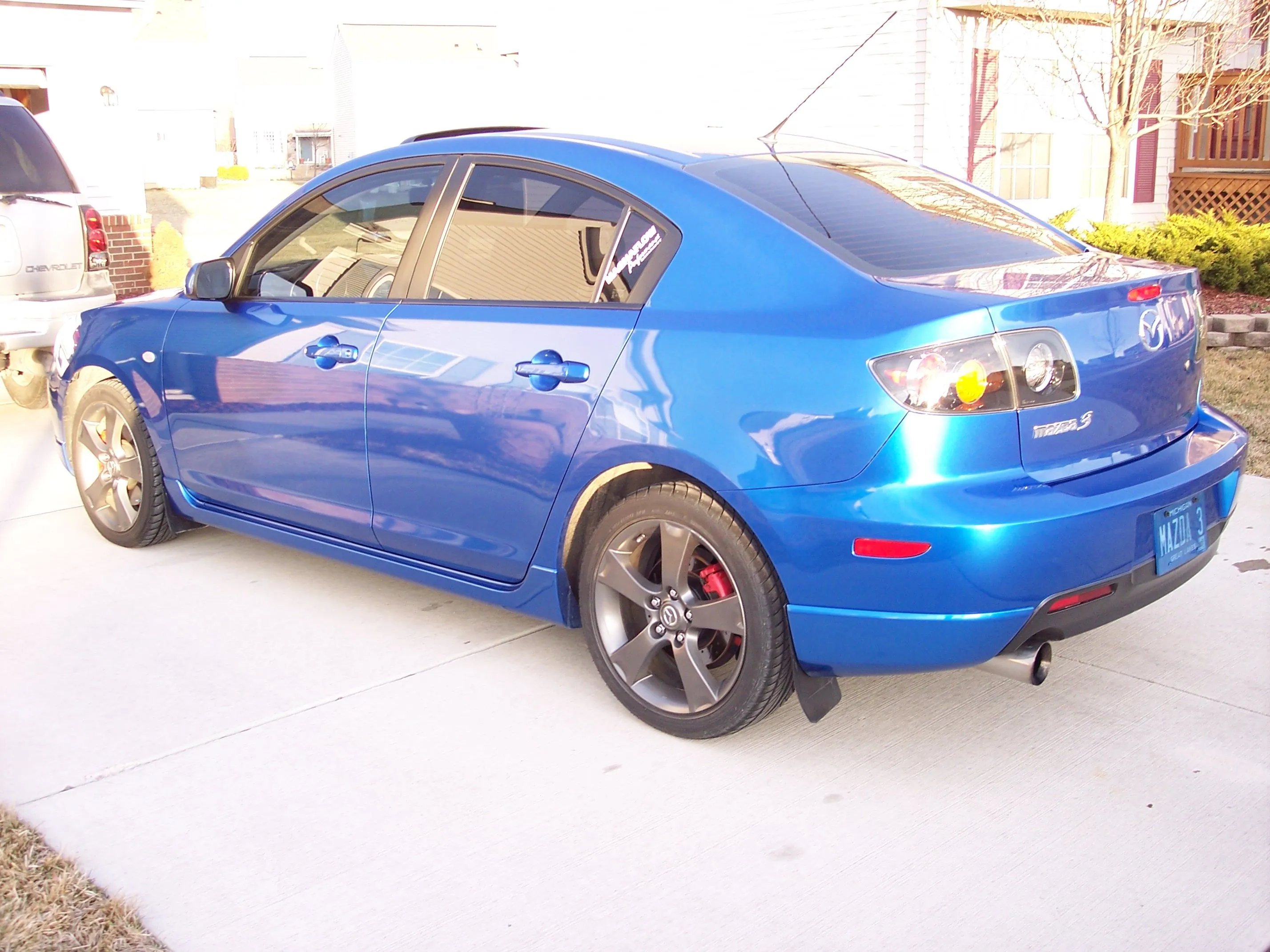

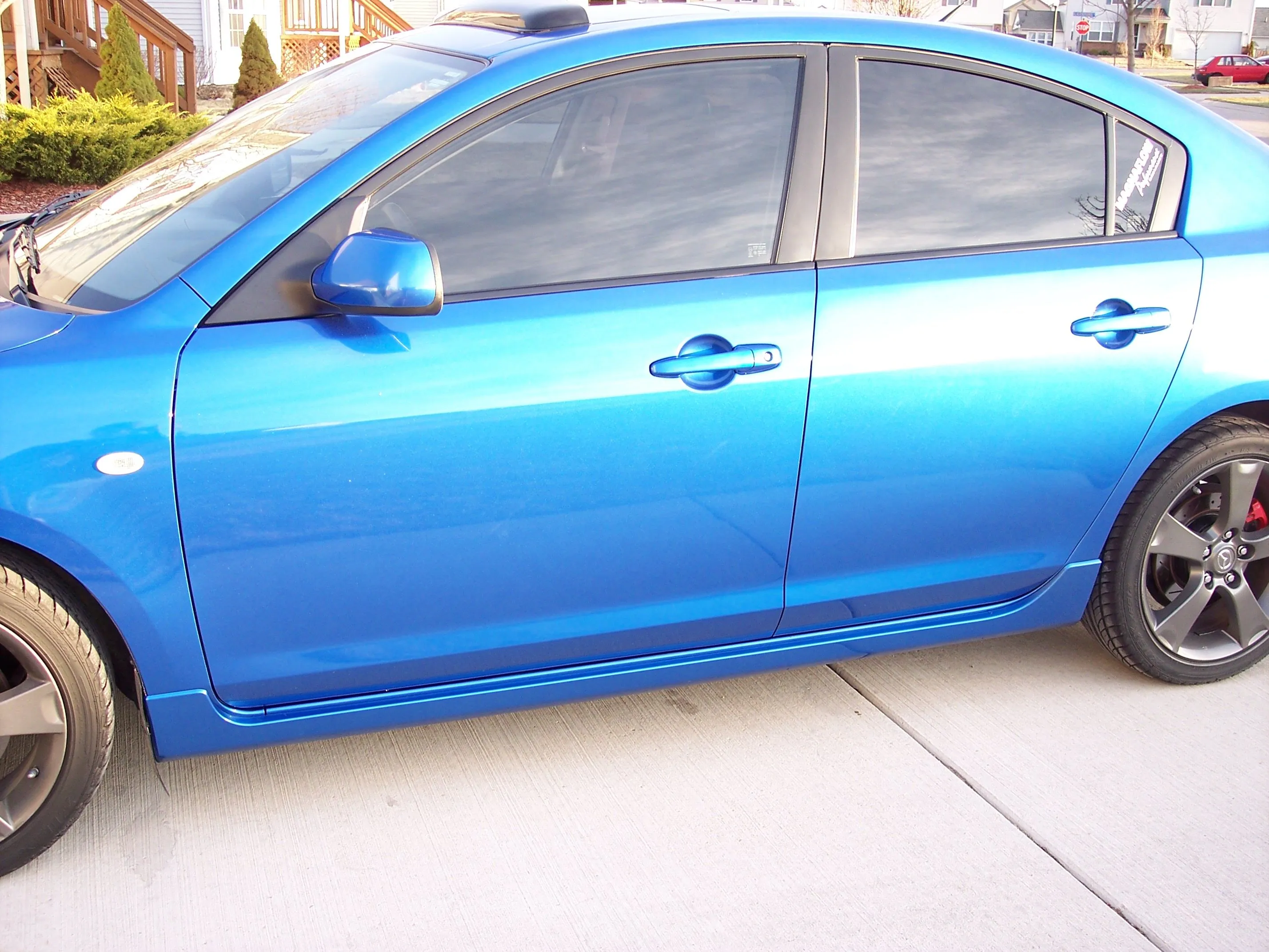

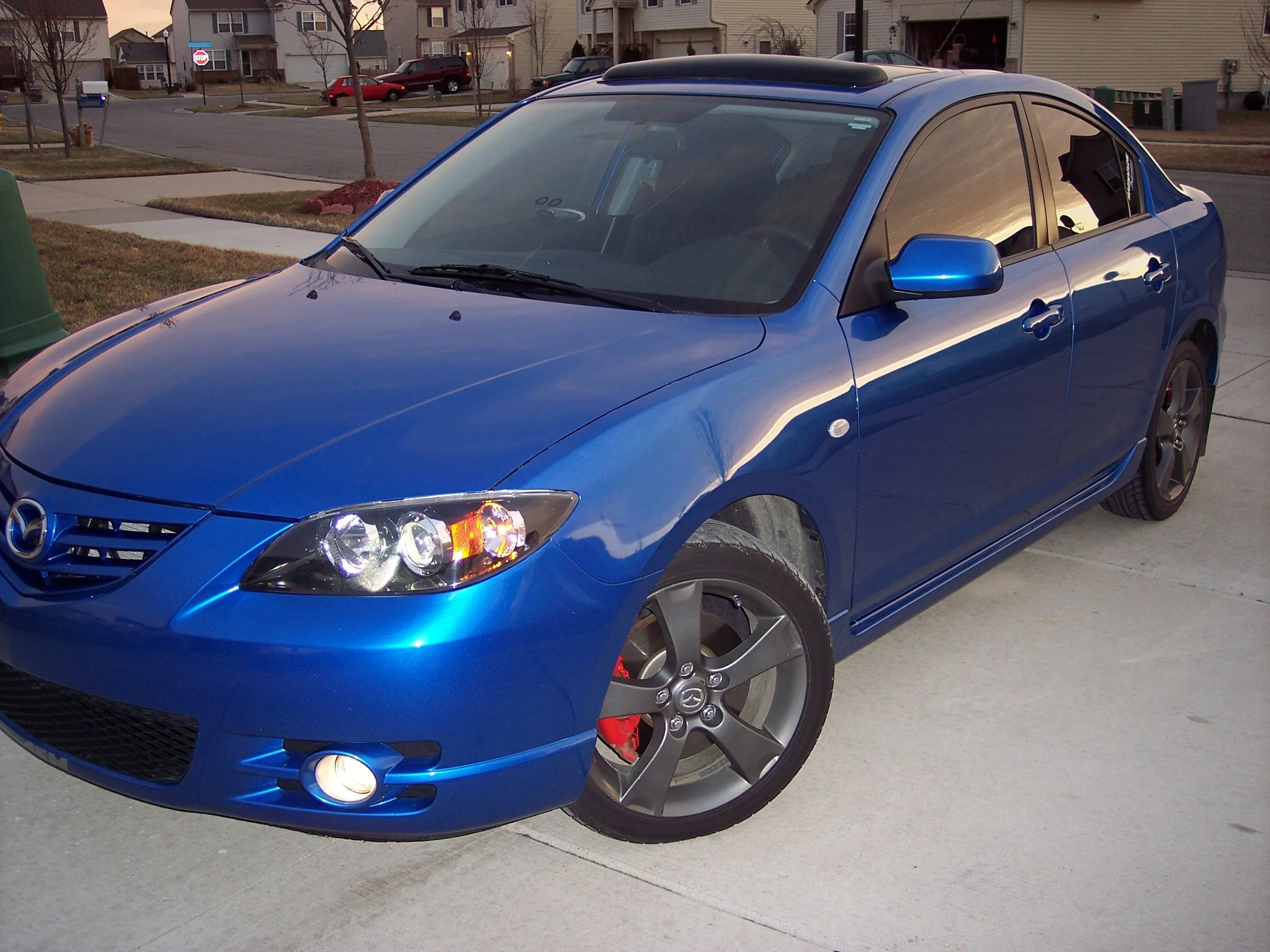

Just got in from taking off my side moldings and waxing my 3 for the first time this year.tell me what u think.
In the first pic notice my lisence plate.lol

Naw those are aftermarket and as u can see in one of the other pics i havnt had time to puut in the new front brakes yet.
looks awesome. What do you mean by taking off the side moldings?
How much to get the rims painted?

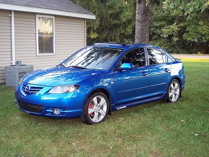

The side moldings are those strips that run down the side of the car. ill post a b4 and after pic. The rims i did myself, i sandblasted them first then used some self etching primer (dont know what it does but a bodyman told me to use it) then bought the paint and some clear and went to town.

selfetch restores the corrosion protection on the substrate. i dunno if the wheels look good with the 3. it just doesnt look right to me.
any techniques to remove the side mouldings? and how long did it take? Now that i have seen your car without them I have to take mine off.
The side moldings took about 20 minutes to get off. I slipped some fishing line behind it to get it started then i just pulled it the rest the way off. there was only a little bit of sticky stuff left on there and that just came off with my finger nail.
The mudflaps are just some universal ones that i got at autozone last year. They were like 2 or 3 bucks and they serve their purpose (keep the side skirts from gettin all chipped up even more). I had to cut em to size a little bit but other then that they just screwed into the inside of the wheel well.

looks awesome. lose the antenna and you'll be golden.
Yea ive been wanting a stubby antenna for a while but the radio recption alread blows as it is so i dont want it to be worse.
