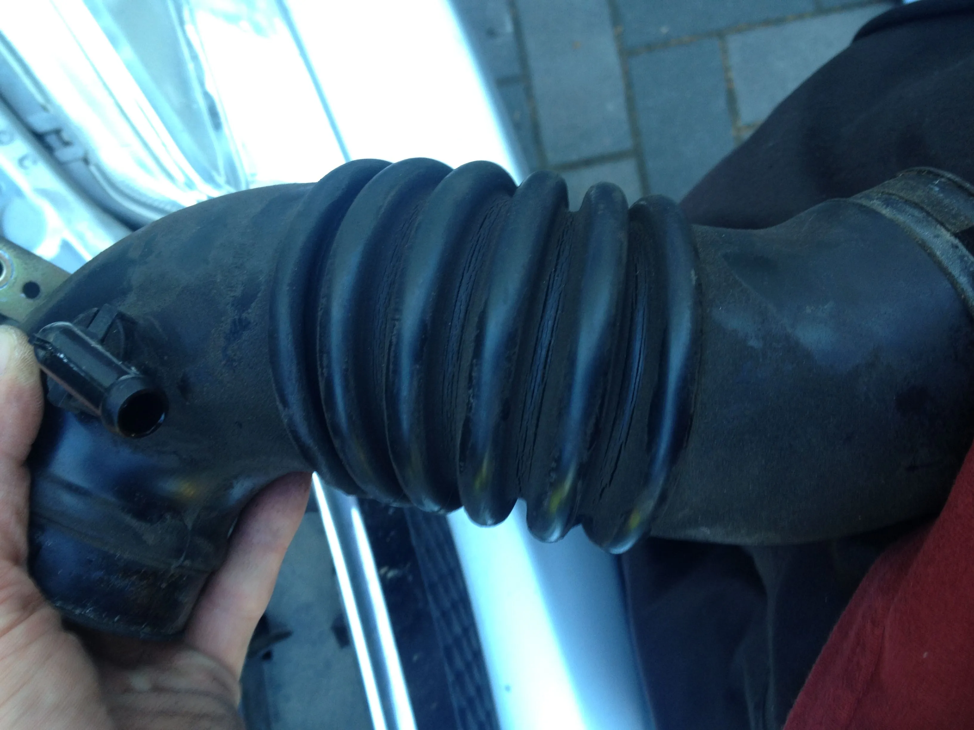

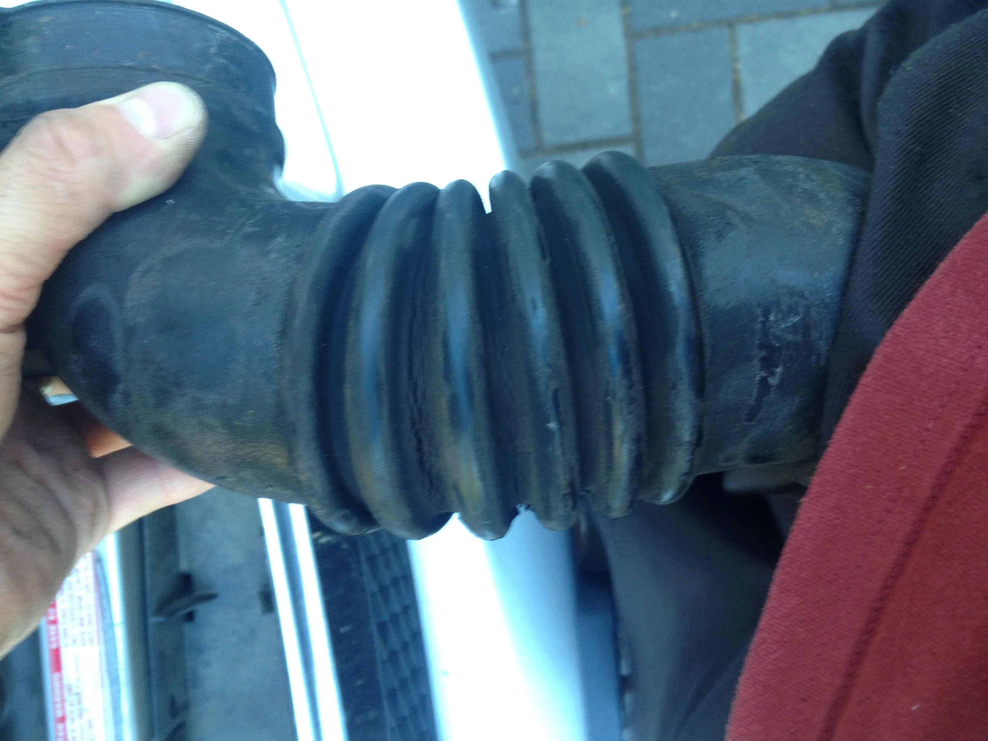

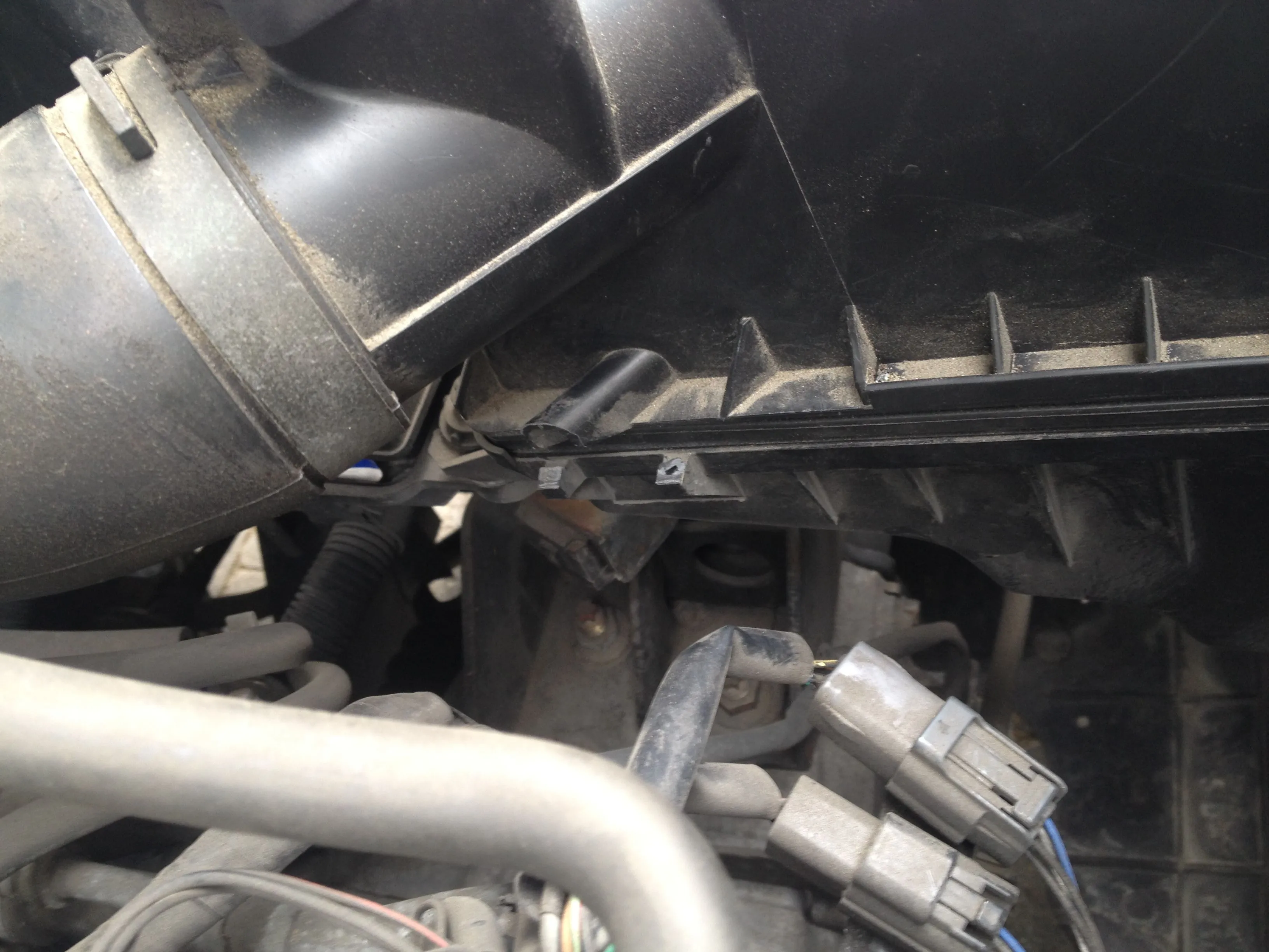

I checked the air intake out, there were some small cracks on the large bendy black hose that goes form the air filter to the intake but they didn't look like they went all the way through. I also inspected the vacuum lines and didn't see any that looked cracked. I have uploaded a picture of the air filter box which shows a broken clip that holds the box down tight. Could this be the issue? The other black clips works and the two metal clips on the other side also work properly. I also inspected the air filter and it looked pretty dirty. I blew it out with some compressed air and put it back in. Although i don't think a dirty air filter could cause this issue?

It may not be the O2 it could be a lot of things, a leak anywhere between the MAF sensor on the intake and primary O2 sensor in the exhaust manifold can throw that code. Most common reason on these cars is the accordion section of the intake tube tearing and leaking air, second most likely cause is a vacuum hose leaking. Less common on the N/A cars but something to check is the exhaust manifold for missing hardware or cracks. You can use soapy water in a spray bottle while the car is running to spray the vac lines and around the intake/throttle body to help find leaks. The MAF sensors do not fail very often and they are frequently replaced for no reason, a simple cleaning with some electric parts cleaner should be sufficient.

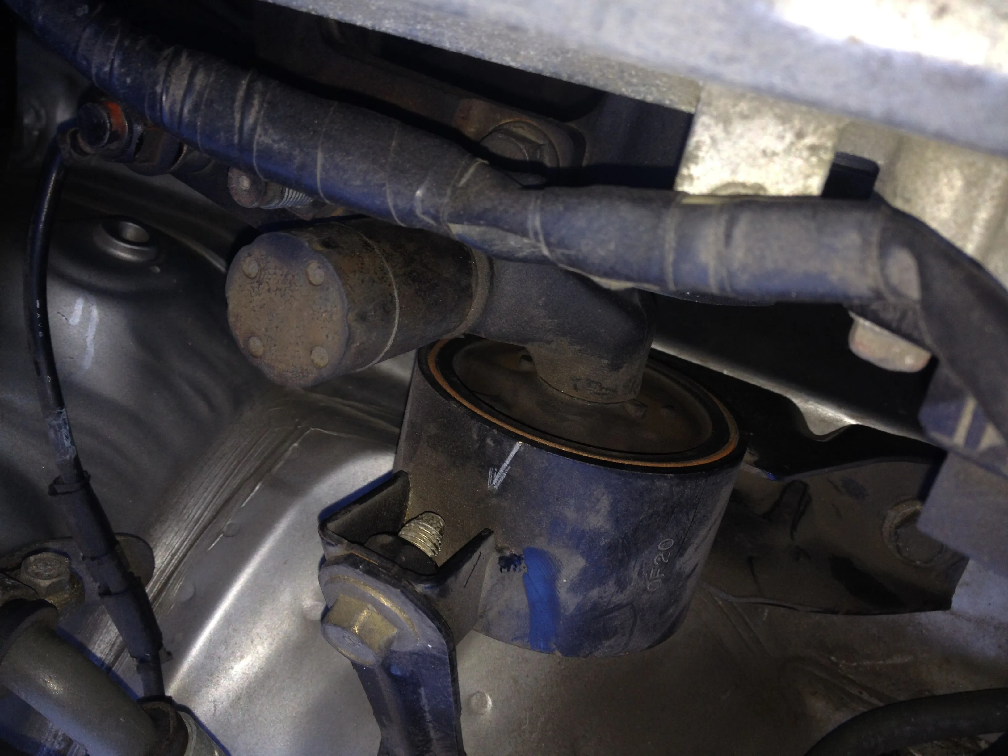

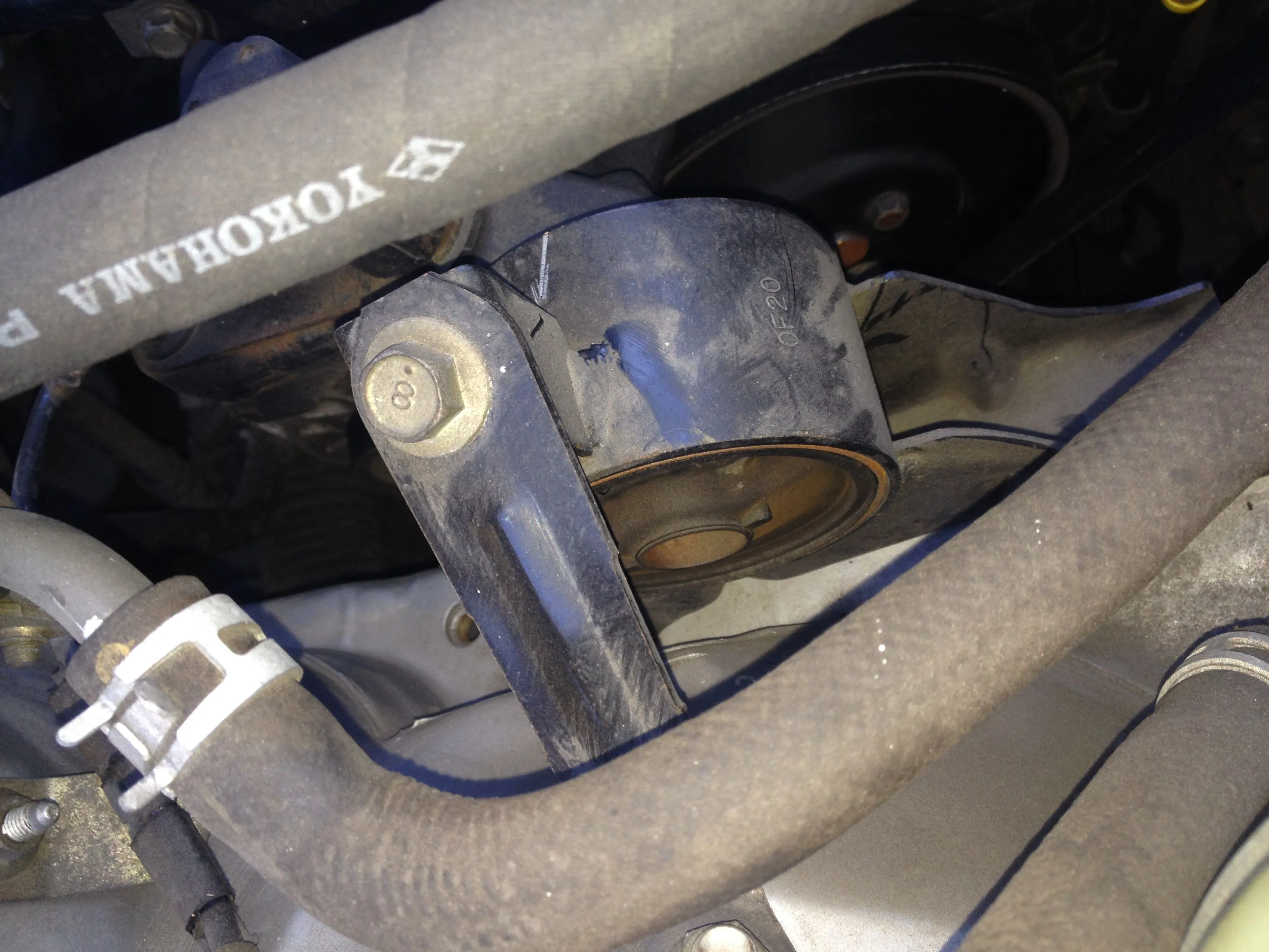

The accordian section of the intake tube is likely split underneath. did you remove it when inspecting or just have a look. i work at a Mazda dealership, and own a protege that has had the exact same symptoms as you are describing from a tear in the intake boot. because "false air" is let into the engine behind the MAF sensor the PCM injects too little fuel into the engine and the o2 sensor picks up a lean condition and signals more fuel to be added. once the PCM is adding 15% more fuel than usual to combat the problem the engine light comes on. Proteges are notorious for tearing the front or rear engine mounts with age, which causes the engine to rock back and forth and tear the intake boot open. check the intake boot when removed from the intake and look to see if either the front engine mount (below the exhaust manifold attached to the transaxle subframe, and the rear engine mount which is between the intake manifold and the same transaxle subframe)
Excellent thank you, i was just about to order the sensor when i saw this. I will take the rubber acordian thing off tonight and take a good look for cracks. I will also check the engine mounts.
Another possibility: This lean code happened to my daughter's Protg, not too long ago and it turned out to be a cut vacuum tube near the upper middle of the firewall in the engine bay. I simply cut 1/2-inch or so of the tubing off, reinstalled the tubing, used my ScanGauge 2 to turn off the check engine light and everything wa good to go.
There was one pic i couldn't post of the engine mount due to it being over 2MB. But it looks as the first two pics do. There are not any cracks in it or anything like that.
