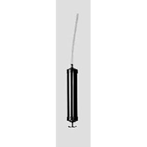

Or just get a suction gun. Tractor Supply sells them and you can get them on line at Amazon.com or elsewhere. Fwiw Mobil 1 has always worked for me regardless of temps.

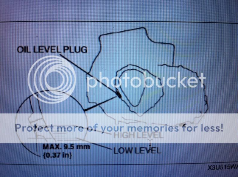

Is that picture pretty right on? I can find the drain bolt easily..I found what I think is the fill hole facing towards the front, but it's not as far forward as in the picture.
I'm going to assume I found the right one as the plugs look identical
I feel like I remember seeing it where I put the red dot at.
