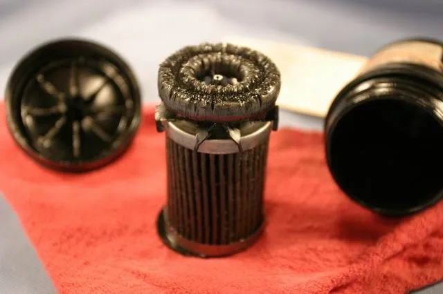

Here's a photo of a dirty Magnefine filter (basically an inline magnetic/paper filter for tranmission and steering fluid lines). I don't have a photo of a dirt Forcefield, but it's basically the same result. All that stuff on it at the top is metal shavings from a GMC truck tranny after 30k miles. Paper filters can only filter down to a certain particle size and still allow oil to flow. The magnet attracts particles of any size.
To make the explaination short, the small particles are the ones that mess parts up because the big particles can't fit in between the bearing clearences. It's pretty scary to see the difference between identical parts run with and without this thing after a while.
Ford and Chrysler started puting those on all automatic transmissions that come in for warranty work.

that's pretty gnarly. you think anything will come out for the protege auto tranny?
The filter is generic and just an inline filter. You just get the diameter that you need for your fluid line and install it on there (ie - cut a section out of the line and attach the hose to the filter at each end. I have 1/2", 5/16", and 3/8" samples here. I'm sure they make other sizes, too, but those should cover 95% of the hoses out there. Not sure when the Magnefine filters will show up in stores, but I was told that the Forcefields will start being sold by next month.
