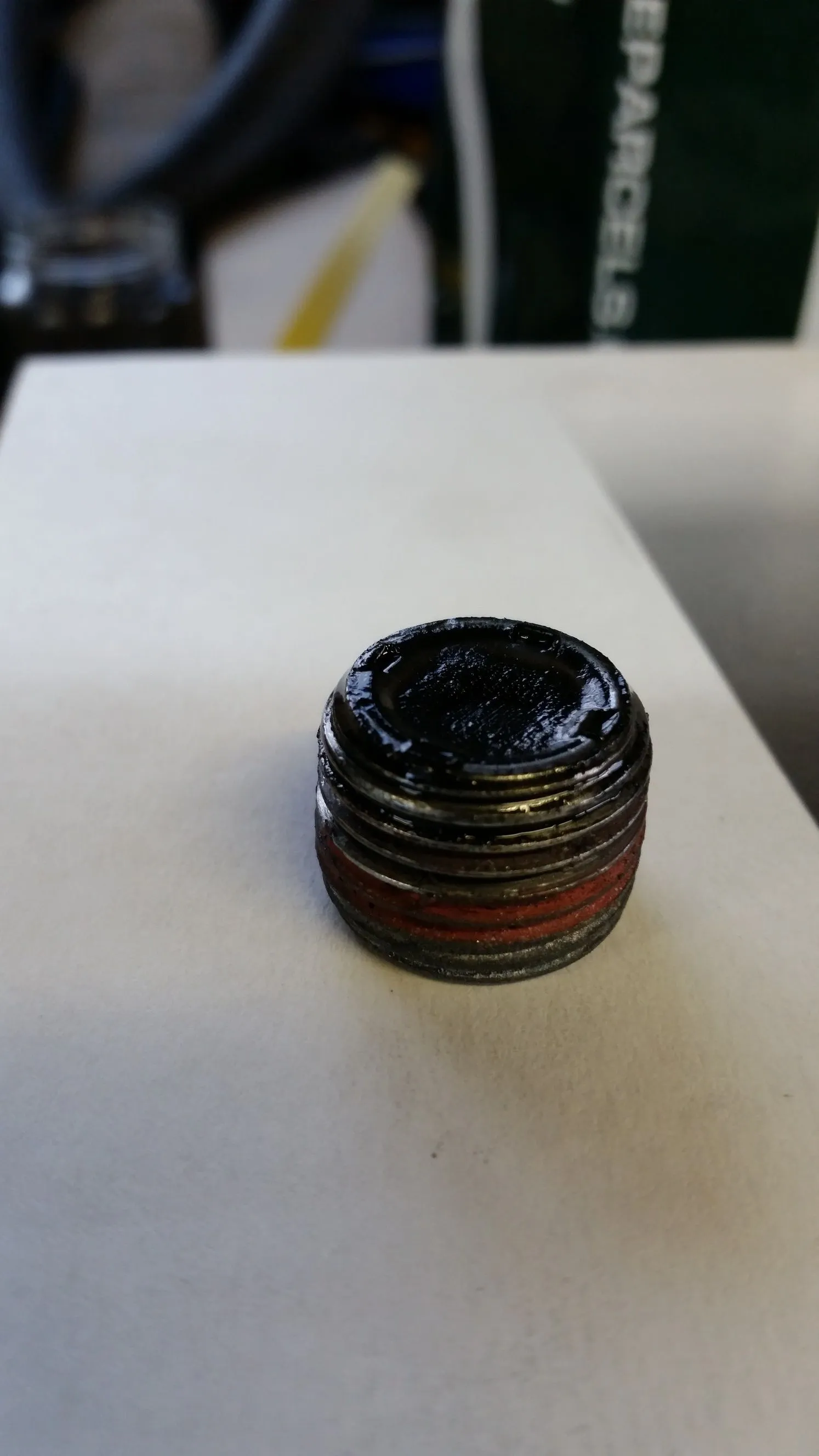

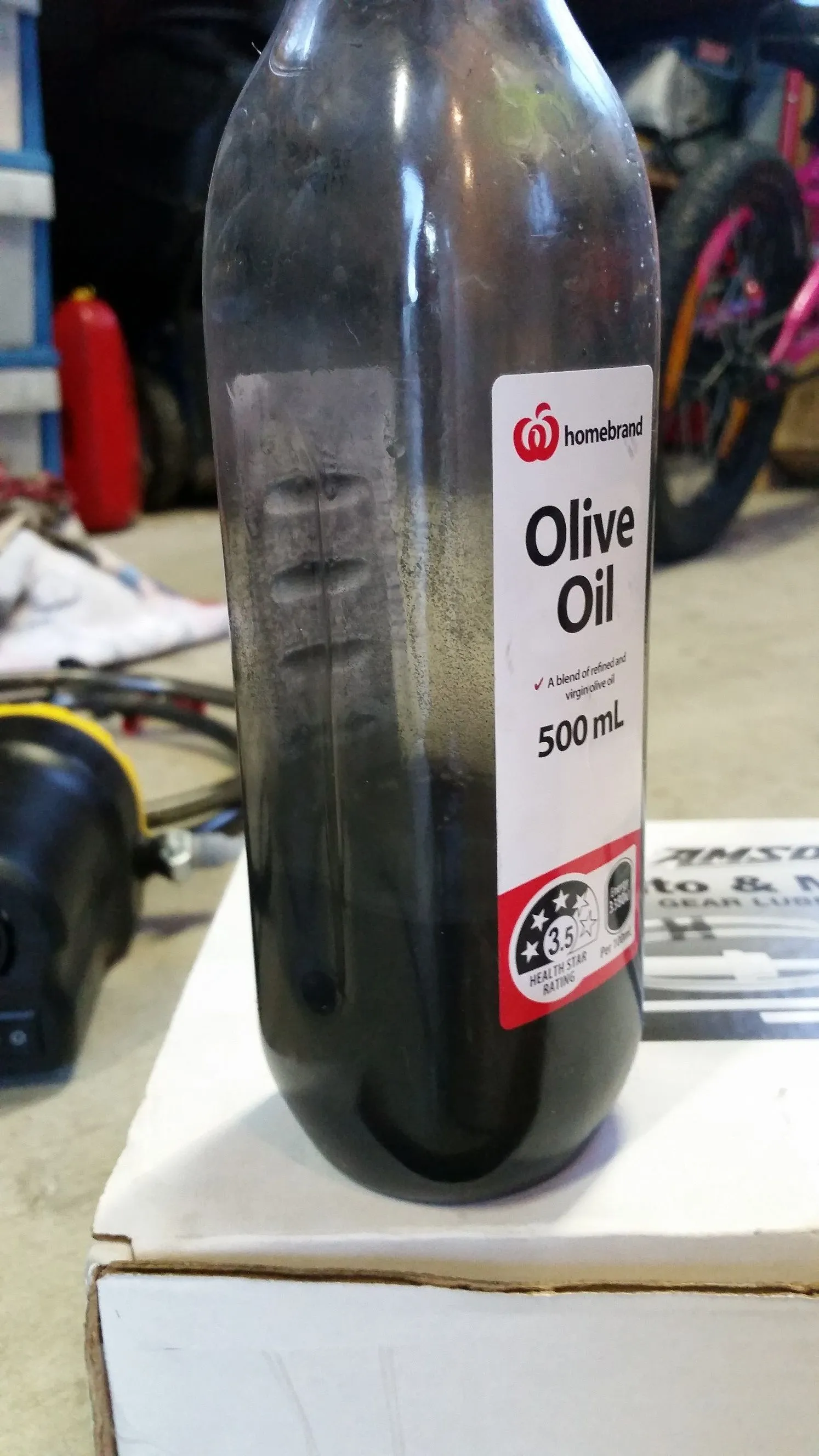

Hi guys, i changed my transfer case oil this afternoon. The job itself was pretty easy, i think most of my time was spent cleaning out the pump hoses and trying to clean away the oil that ran down the side of the transfer case!
http://s1160.photobucket.com/user/m...zda CX-9/20160516_164722_zpstljwj5mj.jpg.html
As you can see in the photo, the fill plug was reasonably clean. I believe the mazda technician took it out last week to check the oil condition, and probably wiped any gunk off then.
http://s1160.photobucket.com/user/m...zda CX-9/20160516_170206_zps03ntrgty.jpg.html
I only removed about 150ml of black oil from the unit and when pumping in the new oil another maybe 30-50ml was pushed out.
I plan on repeating the process after 800-1000km and comparing the results then.

yep, your plug looked like it was definitely cleaned when they inspected it last week, mine looked A LOT worse when I first took mine off for the very time at 38,000 miles (it had a good chunk of thick goop and sludge on it).
Wow only 150 mL oil left ? looks like you caught it in time before that transfer case ran completely dry.
Drive around for another week or two, then redo procedure and you'll be good to go, cheers.
