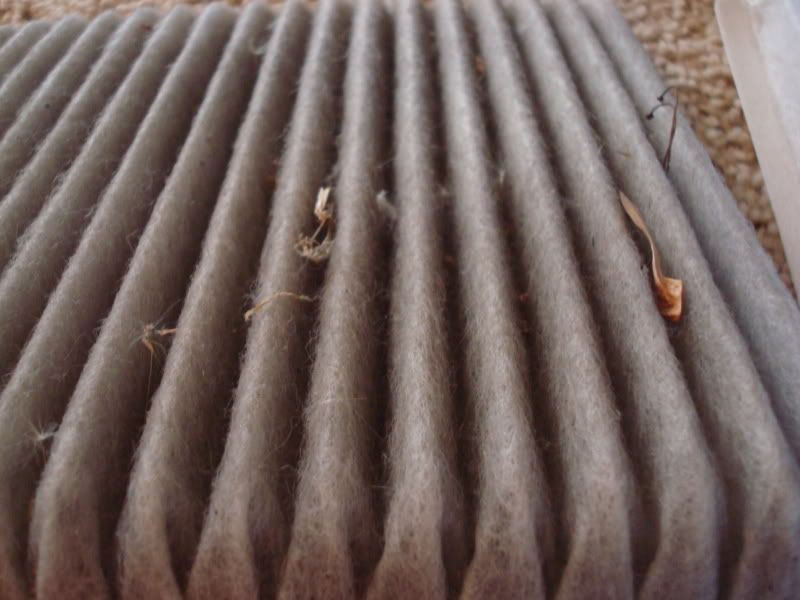

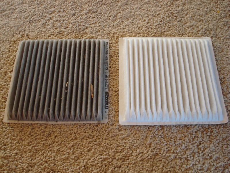

Changed the Mazda CX-9 cabin air filter at 35k, boy was it dirty!

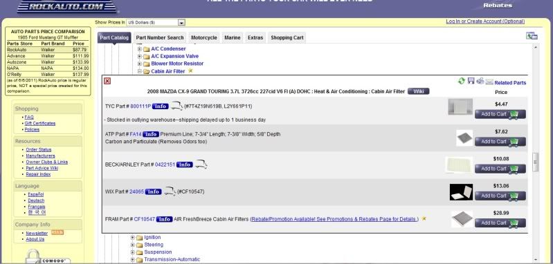

Ordered from Rock Auto, less than $10.00 shipped. Less than 1 minute to remove old and install new!

open glove box, remove access panel (2 tabs at top) and then unclip the white plastic air filter housing cover (unclip on left side)
no tools required, just hands.

How did you get one for $10 shipped. I have actually never replaced ours and I have almost 43k on the clock. Just went to their site and shipping itself almost runs $8.00. Was there a free shipping code? I am sure I need to change mine. I at least use a K&N for the motor and clean and re-oil that annually.
www.rockauto.com select mazda cx-9 (applicable year), then "Heat & Air Conditioning" then "Cabin Air Filter" $4.47 plus shipping. $9.52 shipped for priority mail. Done, easy. I just checked it, and that is shipped to my zipcode. Perhaps it is more to ship to your zip? but I doubt it.
TYC Part # 800111P {#7T4Z19N619B, L2Y661P11}

I change the Cabin filter of my CX9 today, I ordered the OEM part from MazdaParts.org and after seeing the original filter and the OEM replacement I was disapointed, My wife's VW have a cabin filter that is definitively better, looks like an EPA Filter. The Mazda OEM, in the other hand, it barely looks like Foam filter. So, I am wondering if anyone can give me a hint about if there is another replacement that may be slightly better, if any. I found the following manufacturers and part numbers:

The so-called "better one" has fine charcoal particles charged on the filter to absorb bad smell.
(it looks a bit greyish or blackish)

I just changed mine after 3 years. It was a mess too. Watch out that the leaves don't drop off the filter into the fan when you are pulling it out. They make an annoying sound and are hard to clean out. Ask me how I know....
