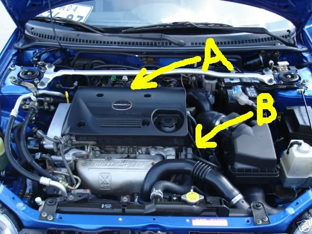

My son's MSP threw a code P0171. After searching on this forum, it seems that the most likely causes are a vacuum leak and/or a faulty Waste Gate Actuator.
This afternoon, I replaced all the vacuum hoses. I started the car and took a vacuum reading directly on the port on the top of the intake manifold (around A in the picture). I was reading about 18" at idle. So far, so good. I reconnected the vac hose to the intake manifold, and disconnected a hose at the "T" connector (the junction that goes to the WGA and to the thing on the intercooler hose - around B in the picture). I was reading less than 5" here (the WGA is still in the loop).
It appears that I have a massive vacuum leak at the WGA (new hoses on it). Does it seem plausible that I need to replace the WGA? The car has just over 60K miles.

Some people have replaced their WGA. Test it to see if holds the pressure. Replace it with ATP unit if needed.

I replaced the waste gate actuator, and now I'm reading 20" of vacuum everywhere. I cut open the old actuator, and the rubber bladder inside had about a 1" tear in it.
