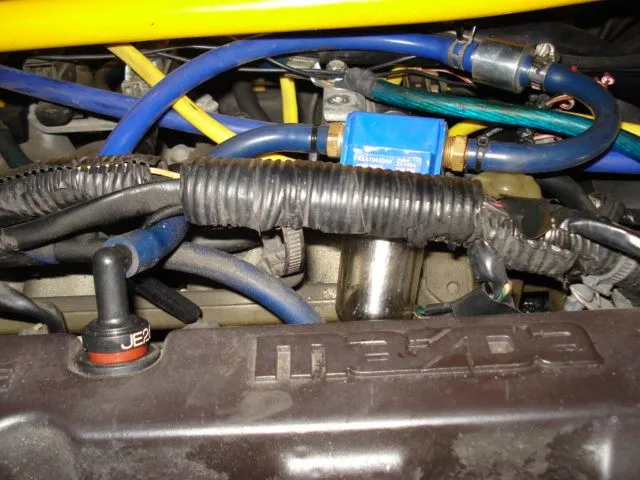

One line comes from the valve cover then theres a "T" fitting so there 2 lines going into the intake manifold. I used an air compressor filter as a catch can that I picked up from lowes

Here's a pic of mine...the chrome deally under the blue prefilter. It runs from pcv to catch can then back to the manifold.
where at on the manifold does it plug in to?
Plugs into the same place the hose off the pcv used to go to. It just elongates the same path from the pcv to the intake manifold with the catch can in the middle. You can also put a catch between the end of the valve cover and the port on the air intake before the throttle body.
