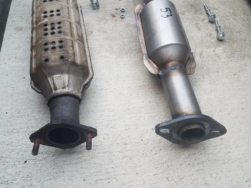

I bought one from eBay. I had to trim a little with my Dremel to make it fit onto my MSP's exhaust, but it passed smog no problem, my car sounds great, and I don't smell anything weird.

Here's what I had to trim. Took all of 5 min.
attachment.php
