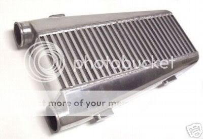

later i changed JUST the IC to a procharger style IC (pic below) and ran the dyno again.
New numbers were 324whp and 379 Ftlbs WTRQ........... 24psi and 27* total timing. I felt alot better about turning down the timing a little and being able to make more trq with less boost.
