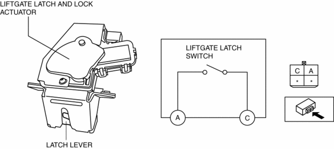

Lift Gate Latch Switch works.... or I assume that is the exterior button and not some microswitch in the actual latch assembly?

It's not the separate latch microswitch as dashboard door indicator shows hatch open & closed. Looking closer at how this thing is wired it does appear to go directly to the RBCM. Lots of troubleshooting data in manual but of course need a M-MDS to interface with it. Even if one got the module it appears you need Mazda dealer to program it according to FSM.

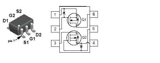

I damaged my RBCM in the process of installation of additional LEDs. I didn't unplug the battery...(burn) and the mosfet Q15 was burned. There are two variants of such MOSFETs: SOT23-6 (replacement ZXMN6A08E6) and SC-62(replacement 2sk3065).

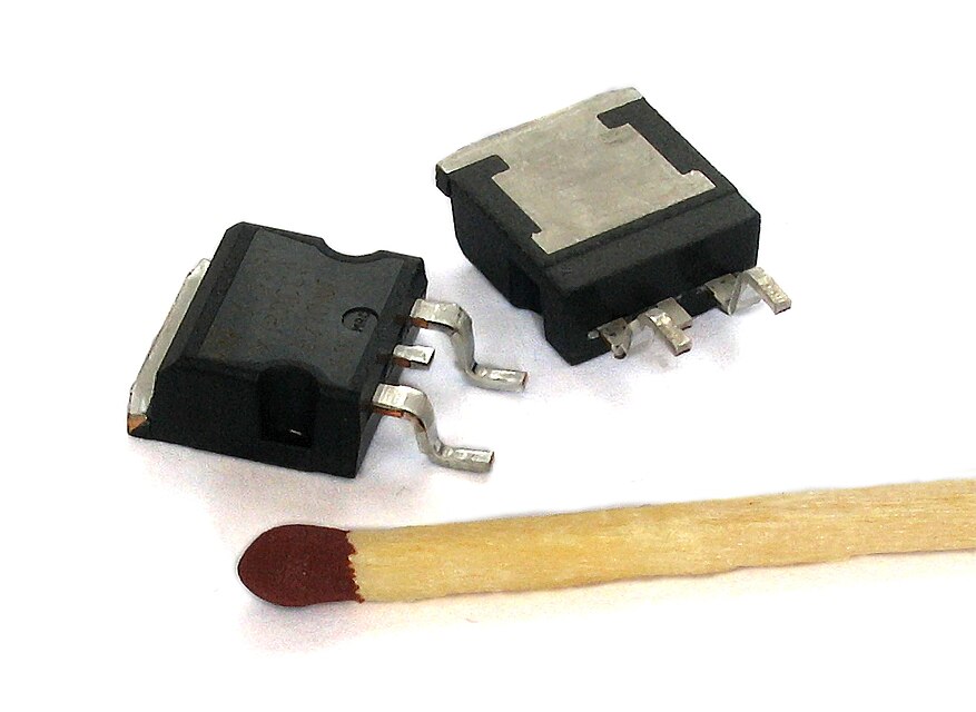

Thanks for detailed info on what you'd found when you damaged the RBCM. If you could pinpoint the burned component, you can fix your damaged RBCM at component level by yourself with easy. I guess from my old knowledge a MOSFET power transistor loooks like this:
And this has dual MOSFET power transistors packaged together as one chip like you mentioned - type SOT23-6 which is on our RBCM board:
