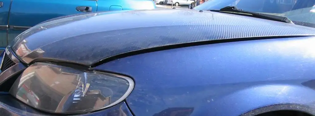

It looks good also, nice fit.
stay away from ViS hoods.....thats what i got and its bad....the drivers side used to stick up little bit over the head light until i put the pins in. Ive heard that other hoods have better fitment then ViS
I had a Ractive hood that the front of the driver's side stuck up higher.
After having a number of Ractive products I try to stay away from their stuff.
