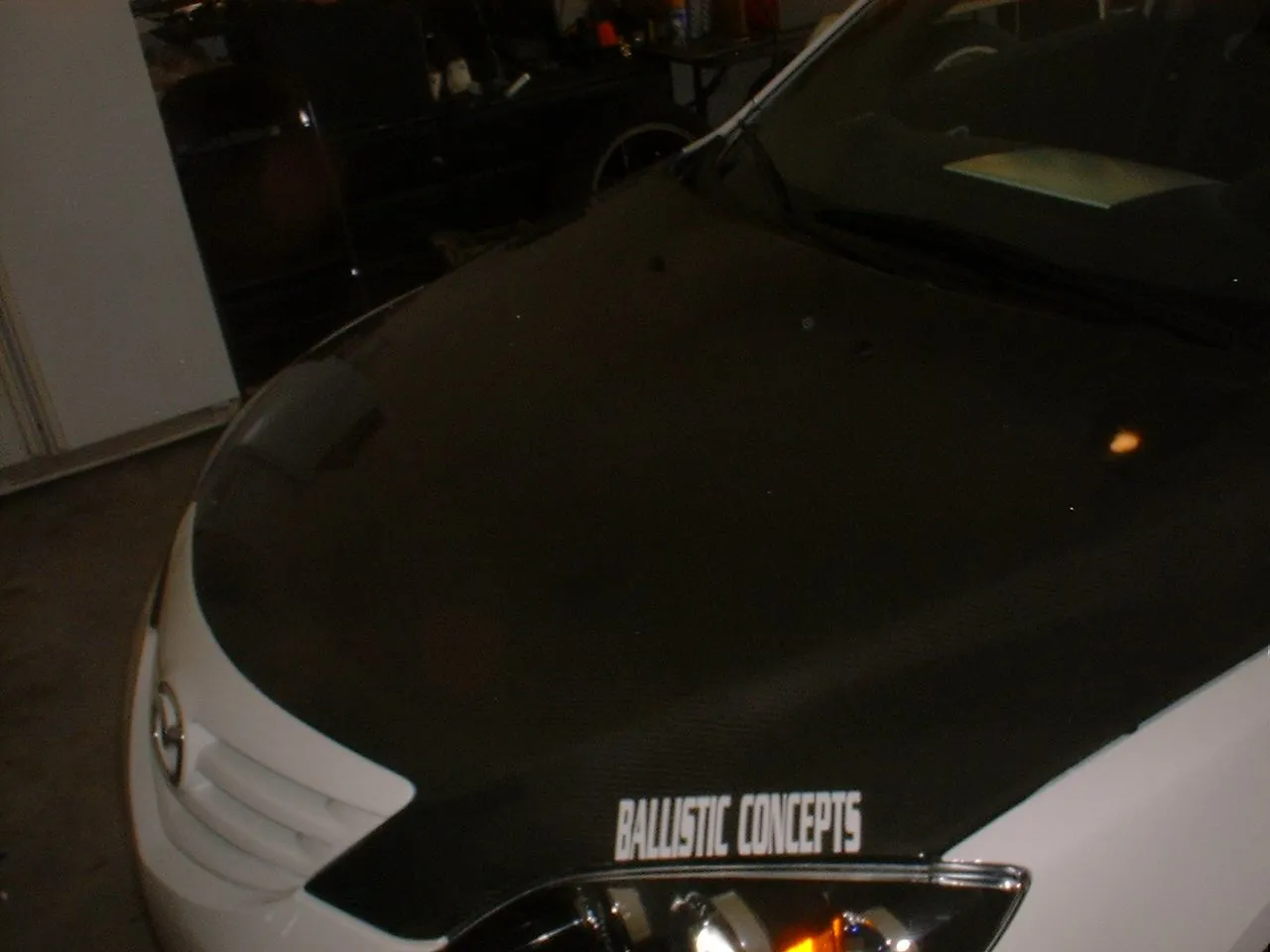

I decided to save a little money and buy my carbon fiber hood from a cheaper, not by much, neverthless cheaper merchant. From the day I got the hood, the quality of the hood was never poor. Even now, well over a year after, the hood still has no serious problems.
The most FAQ about the cheaper hood is the discoloration of the cf hood. Well, I will personally admit to a little discoloration under certain cirucumstances. Under direct sunlight from about 5-10ft away, the hood has a lite greenish tint on the weave of the carbon fiber(it appears). Once approaching up close to the hood, the greenish glare disappears and the weaves are good as the day I got the hood. Same goes for 10ft and up, the color is black, no green hue on the hood.
Picture Break!

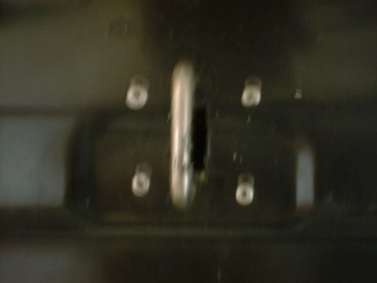

The second issue I bring to the table is not the actual carbon fiber, but the hood latchet that is fiberglassed in. This is my fault as I should have installed hood pins, as I knew this kind of things are common. The fiberglass surrounding the hood latchet is getting worn from the stress. Not yet a problem, if I don't do anything now, over period of time it will rip off, and my hood is going straight to my windshield! I will update on this, as I ordered some sparco hood pins yesterday.
again picture time!

I guess the last thing I want to talk about is the clear coat. Personally, I believe the amount of clear coat used, and the quality of the clear coat could have been better. The hood still has a good shine on it(see pic below). But a good layer of wax weekly helps alot on the hood.
