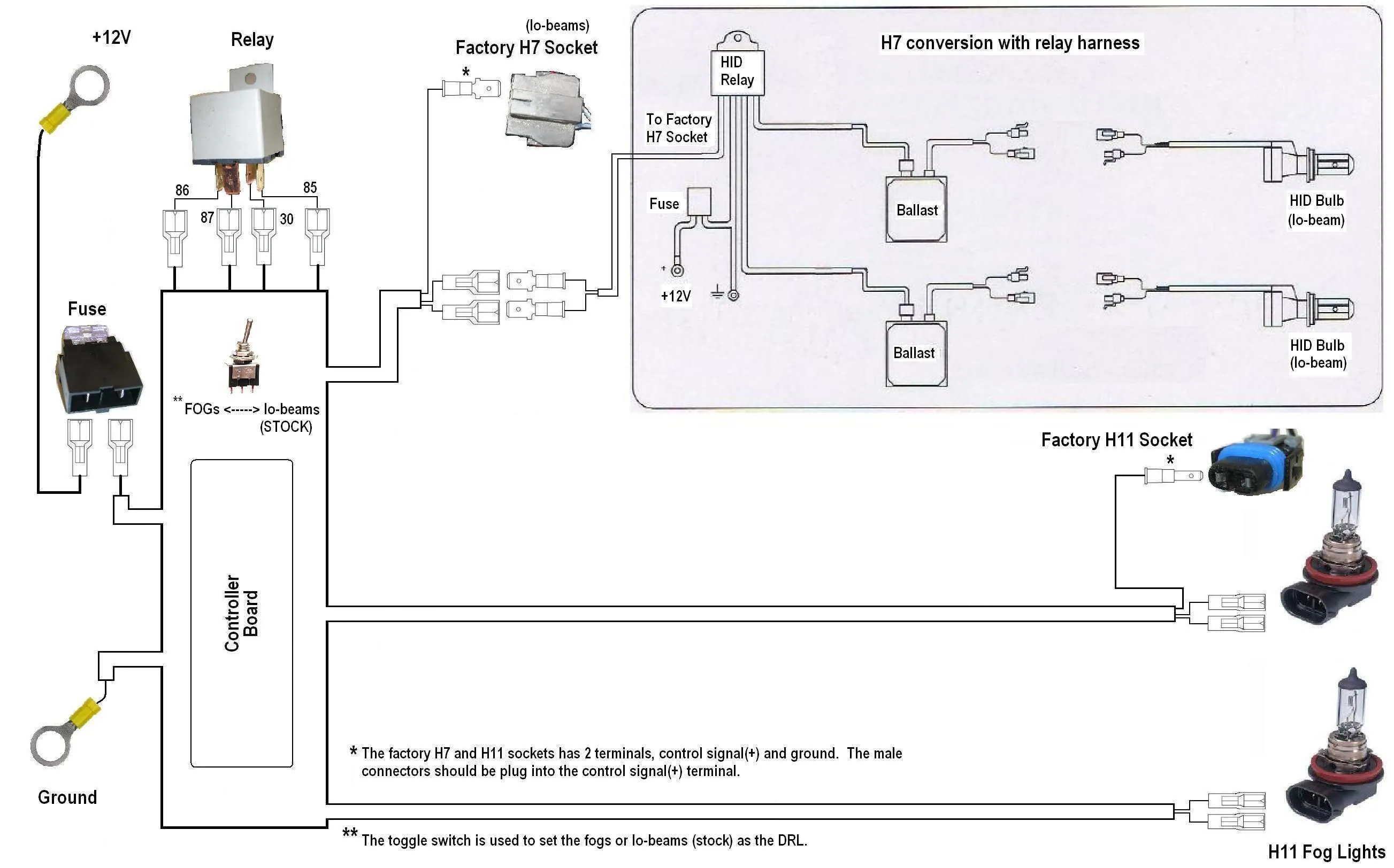

Here is the wiring diagram for the harness for a set up that already have the H7 HID conversion with a relay harness. For someone who has not done the HID conversion the only difference is the HID relay harness does not go to the ballasts but goes directly to the stock H7 halogen lo-beam bulbs.
I have started the installation guide but need pictures of an actual installation to complete the guide.
