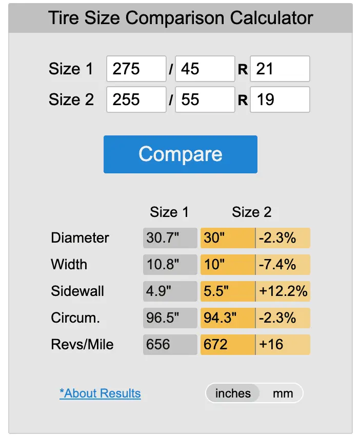

Considering upgrading my CX-9 to CX-90. I have a good winter wheels with 255/55/19 winter tires on them. Can I keep them for CX-90?
Numbers look acceptable, did Mazda change offset or smth?

Comparison with my winters looks acceptable, but might be a bit narrow.
I think it's doable. Backspacing could be a concern but I don't think the 90's brakes are big enough to cause fitment issues.
