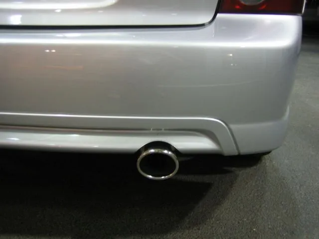

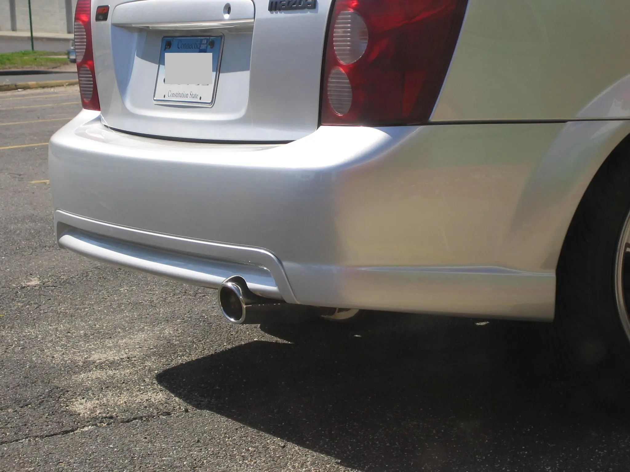

here's a pic of mine. It's the round tip from the 03 MSP!! I love it. not too loud, and looks perfect.
