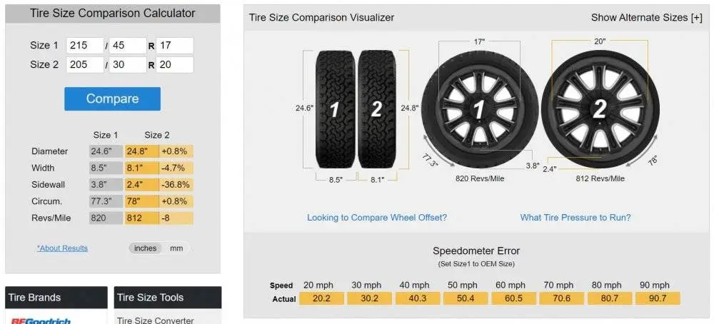

Simple answer is yes. It's the overall rolling diameter that you have to try to match. If you don't plan on modifying the wheel wells (other than rolling the guards), your biggest issue is the width and offset of the 20" wheels.
The biggest wheel/tire combo from factory for BJ Protege was 17x7.0 wheels with 215/45R17 tires, and ET55 offset. That combination has a rolling diameter of 24.6". To keep to that rolling diameter with 20" tires, you'd have to fit 205/30R20 tires (24.8" rolling diameter). Then find 20" rims that are 7.0" wide, with a ET55 offset and you'd be able to fit them on a Protege without too much issue. Possibly an issue on the rear wheel wells where there might be rubbing depending on ride height.

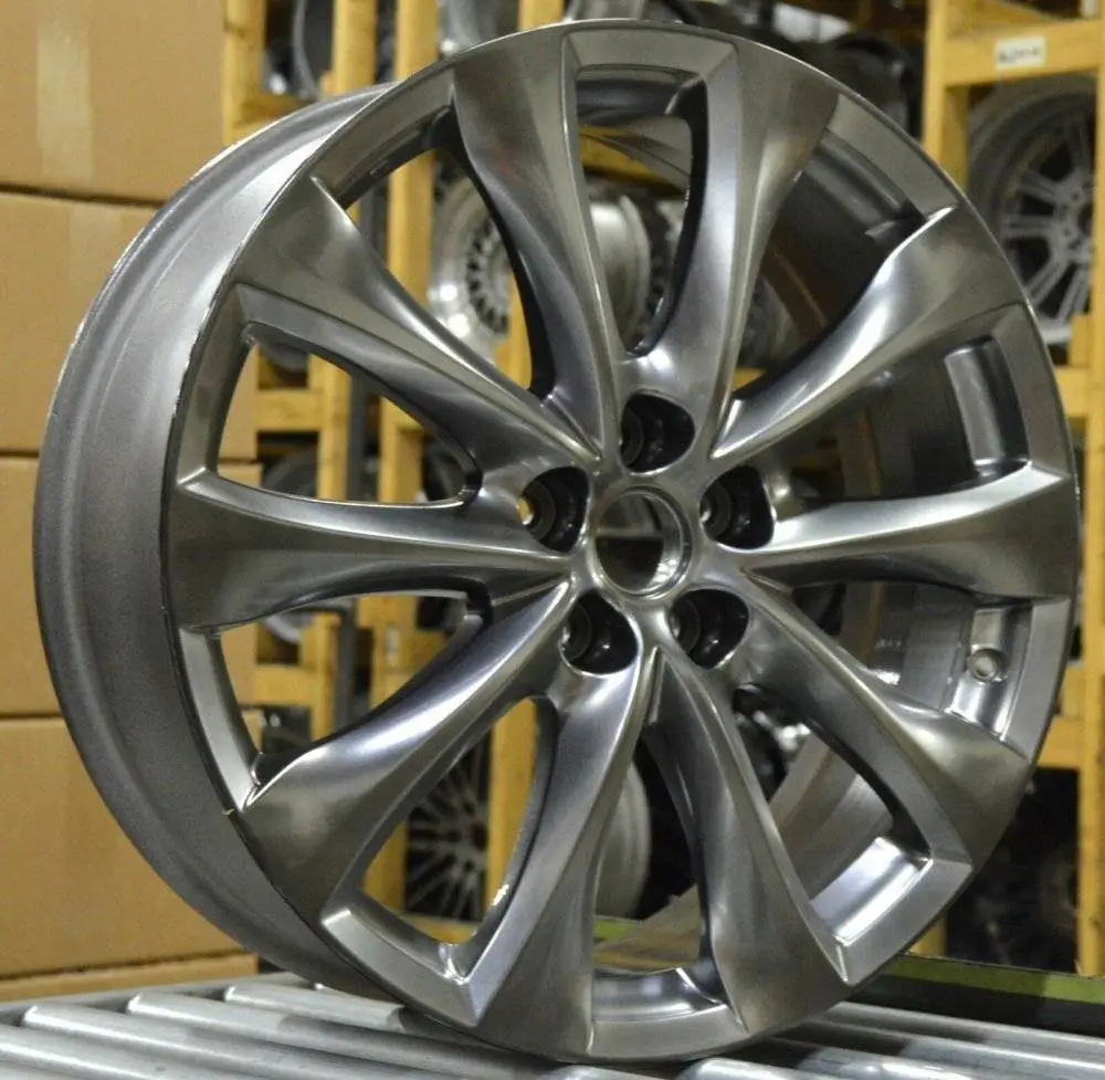

Finding 205/30R20 tires is not easy. They're available. But not from big name brands. Having such low profile tires you wouldn't want to drive on any damaged roads that's for sure. You'd be riding on rubber bands! Next issue is finding 20" rims that are 7" wide with an offset of ET55. There are a couple of Mazda factory wheels that are 20x7.5" and ET45 off of the CX5-CX9 range. See below for one such example.
