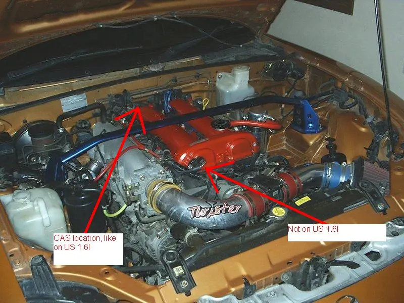

I just looked at your other picture. That sensor isn't on the US spec 1.6l, but looks like it's on the cam gear, not the cam itself.
as far as i know is at the back side of the engine. $75 for camshafts?! sweet jesus!
my new problem is that the camshafts that they offer are 254 degrees. the stock camshafts are 248 so as you can see they wont make much difference. i send a reply mail asking for camshafts with 260 degrees. if they have Aricjm15 has just saved me :) any feedback for this option?
here is what i was talking about. the CAS is located on the back of the intake cam, just like on US spec 1.6l. but you have another sensor on the front. From it's position, it's located on the cam gear itself.
-edit- actually looking at that picture, that looks like a 1.8l. that is your car, right? I pulled it from one of your other posts...

The electronics could be different on the Euro cars. but i was noticing the intake manifold, and the thermostat housing.
Master cylinder's on the 'wrong' side too :p (I'm assuming it's RHD...)

yes that is my engine. its 1.6L i was refering at the NAs when i said that i think the sensor is at the back side.
yeap, cyprus, japan and uk are always rhd :)
like i said, I don't see why it wouldn't work. That front sensor is on the cam gear itself, so just swap it.
yes i understand what you're saying. the problem i believe will be at the back side where camshafts must be shorter on NAs. i'll check it out of course and i surely hope you are right!
why would the cam be shorter? the head is the same.
