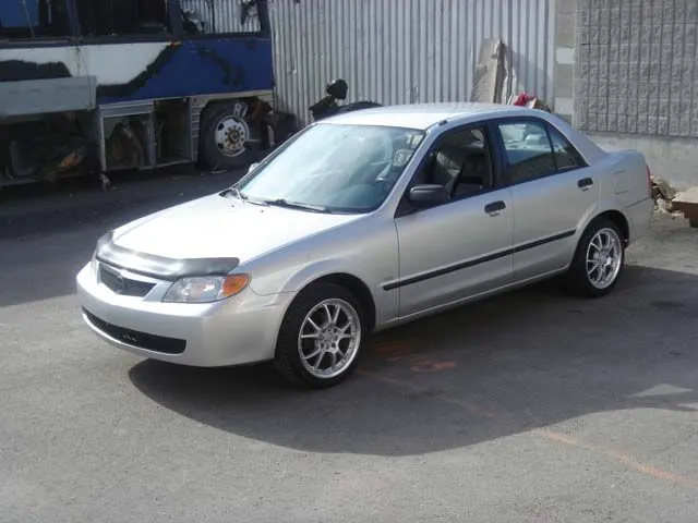

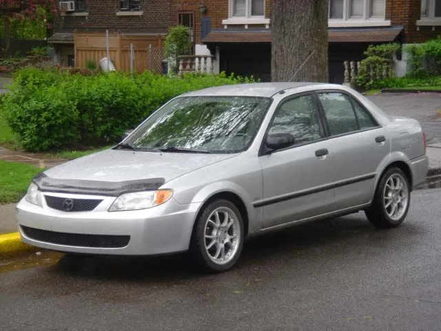

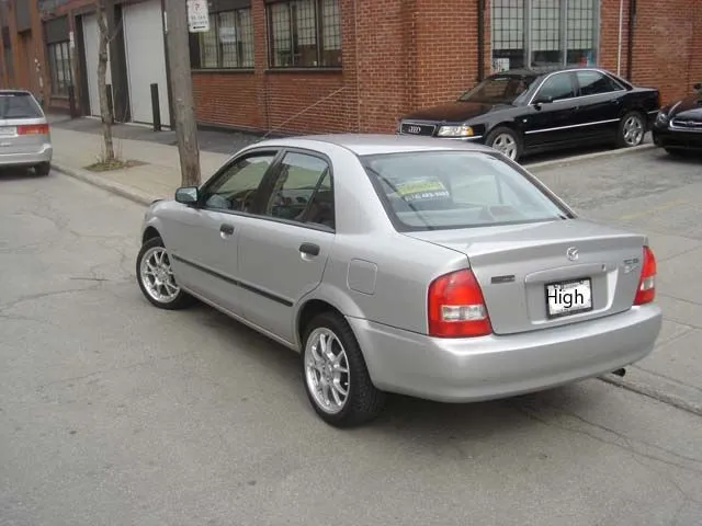

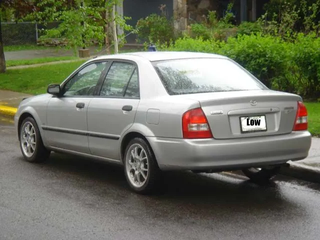

I don't think I got anywhere near a 2 inch drop, here's some pics:
CaptAhab said:
OMG what a difference, I thought my car handled good before but now, it's like on rails! What a pleasure it is to drive now, except now I got bearing noise on the front drivers side, I guess I got a little carried away on some corners, oh well, it would have needed replacement soon anyways :)
Yah, definitely not a 2 inch drop...I just installed my Eiback Pro-Kit and Tokico HPs about a week ago and they've really settled....basically my front wheels no longer match the curvature of the wheel-well...looks really in there and it's only supposed to be 1.5" drop....I'll take pics when my bro comes back w/the digicam from Wisconsin.
