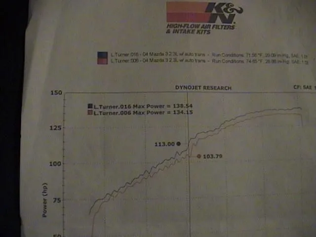

Here its my dyno sheet.
Hey guys look closely at the peak of both graphs. My stock readings were red and my blue readings are after the intake. Remember to keep in mind that intakes are for midrange power not over all. It didnt comeout very nicely but you get the idea. I can email it to someone if they want to see it clearer.

s*** you got 10 hp of the K&N even with the chrome rims on!
Where was this dyno run done? Phone number? I've never seen a dyno sheet with the K&N logo on top before. Does this place rent out ad space on their dyno printouts?

He is only getting ~4.5whp peak gain. The 10whp gain is at 3000rpm. The dyno sheet is supporting DA6, that the gains are midrange and in throttle response.
Well guys I told you I was not bsing. I didnt get much overall but like I said intakes are for midrange power not over all. It helps in the shifting. As the dyno sheet that was given to me by K&N engineering themselves while I took my car up to have them install my intake. Remember also that the engine hasnt fully gained the effects of the intake so gains can be higher after driving a 100 more miles. My car is also an automatic too so manuals will probably be higher.

Guys, I just received my AEM CAI and as I'm reading this I'm getting more and more confused. The following comments may be ignorant b/c I'm new to the tuner scene, but this is what I've found through research. 1- this is the 1st time I see a claim of 10WHP from a CAI only....are we sure we're not talking 10HP which would clear things up??? 2-The dyno sheet has KNN logo on it b/c it was done by KNN, point is they probably tweaked everything they could while still leaving the car stock in order to be able to advertise it.

Its a 10 horsepower increase at the wheels thats how dynos are done. Second of all K&N didnt tweak anything except their intakes to make sure they dont get SES lights for running to rich or lean. As for the K&N logos thats their so called stationary they use for their dyno sheets. Its not used for advertisement. That dyno was taken off my car only no other cars. Thats why my name is at the top for the stock and intake installed readings.

The K&N shows 4.4whp gain, the 10 is ft lbs of torque at 3k rpm.
Even with that, the numbers are sad, and 4-5hp and 20 ft lbs behind what the 5 speed gets.
