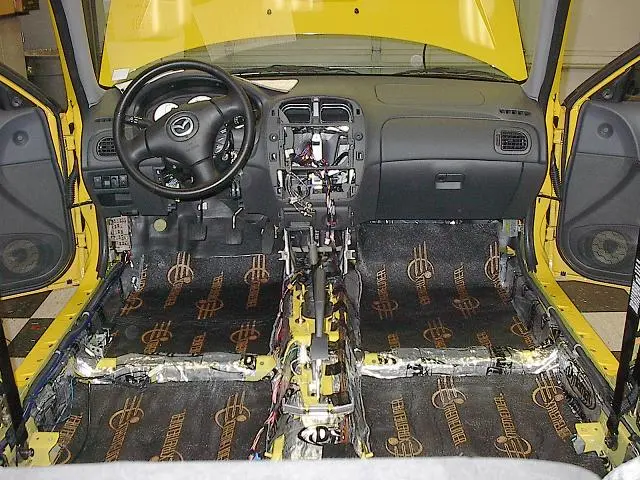

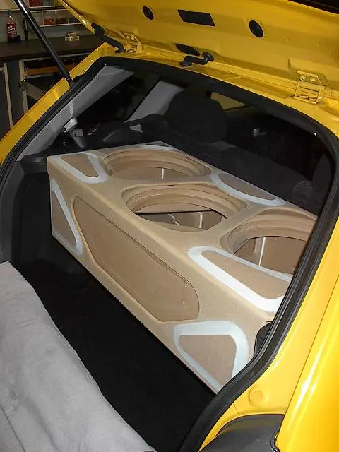

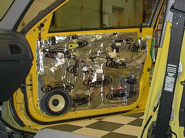

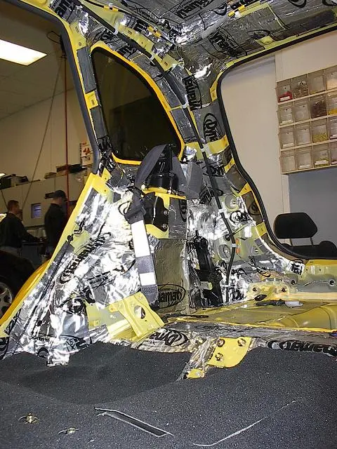

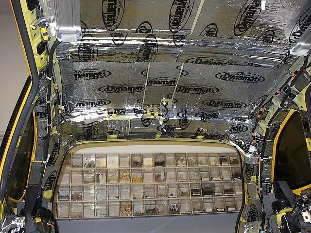

definantly use the MAT for killing rattles -- i used dynamat but that was before i did my reading, but i also got a kill deal -- stores sold it for $250 a box and i got it for about $100 and it took four boxes.
it did its job very well for killing rattles -- it did help with road noise too. before, if i had a passanger, i felt like i had to speak up to talk. now its suttle and nice.
But since you have exhaust drone -- you will NEED to add the Ensolite on top of the MAT to help with that --- its a long job but 1000x worth it.
i dont explain things well sometimes, so if you have any questions, just ask
Billy
