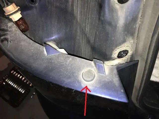

1. Remove the rear light assembly by loosening the two screws. This would exposed one clip underneath, remove it.

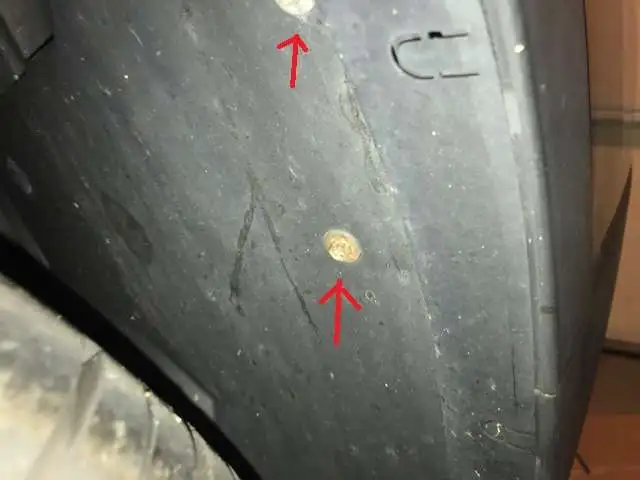

2. remove the two screws (7mm) of the wheel splash fender (I don't know its technical name). No need to remove the clip further far inside.
3. remove the clip of the black trim over the wheel. This would allow the trim to come loose.

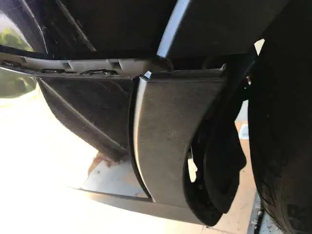

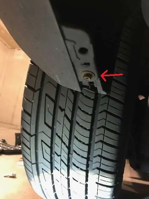

4. Underneath the vehicle, remove the screw (7mm) that joints the splash fender with the bump cover. Then you can separate the two. Let the splash fender loosely hang there over the clip in step 2. After separation, it will expose another clip for the bumper cover. Remove it.
5. Pull the bumper cover toward you to disengage the hidden clips behind. You may need to yank a bit and apply some force. Don't be afraid, it will come loose.
