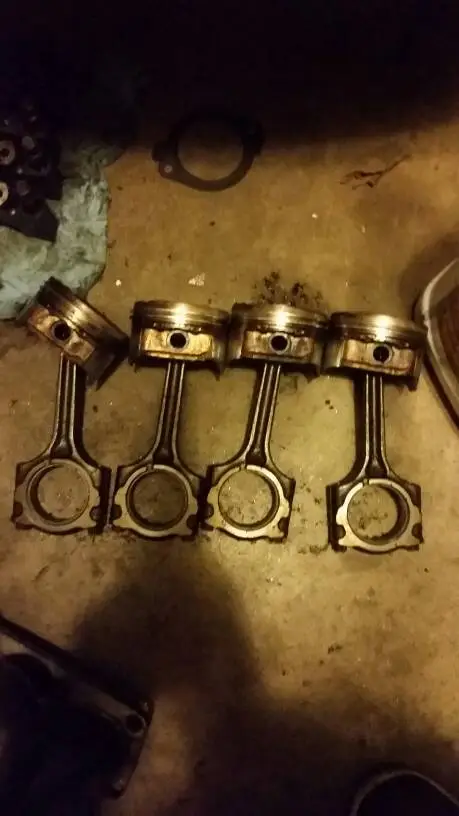

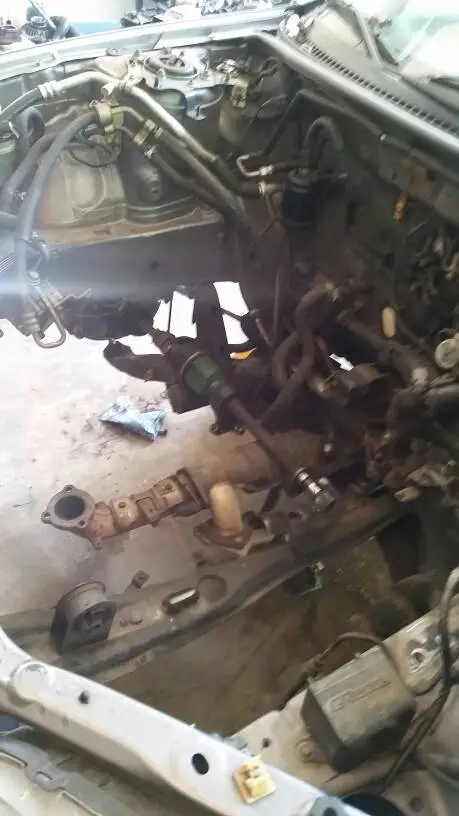

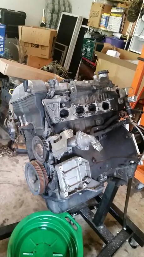

So we then started taking things apart and pulled the motor out.

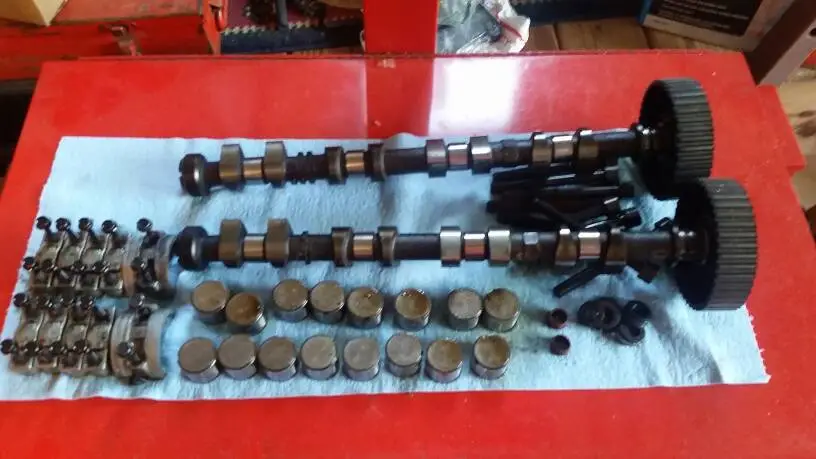

Then we began taking the motor apart.
View attachment 213143View attachment 213144
View attachment 213146View attachment 213147

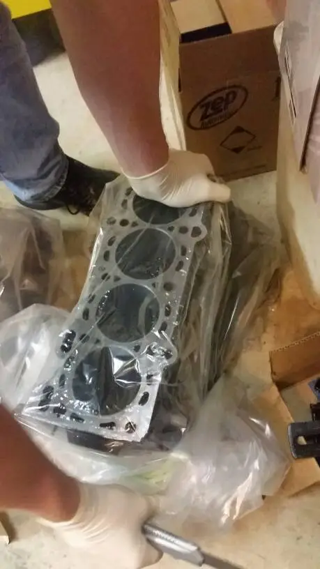

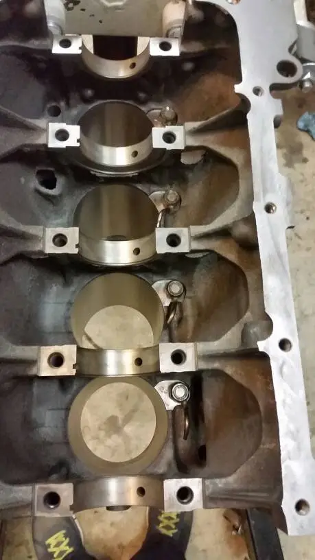

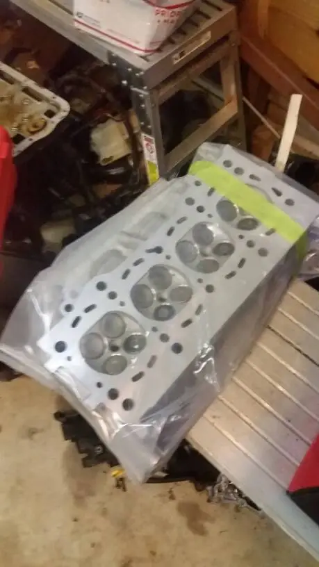

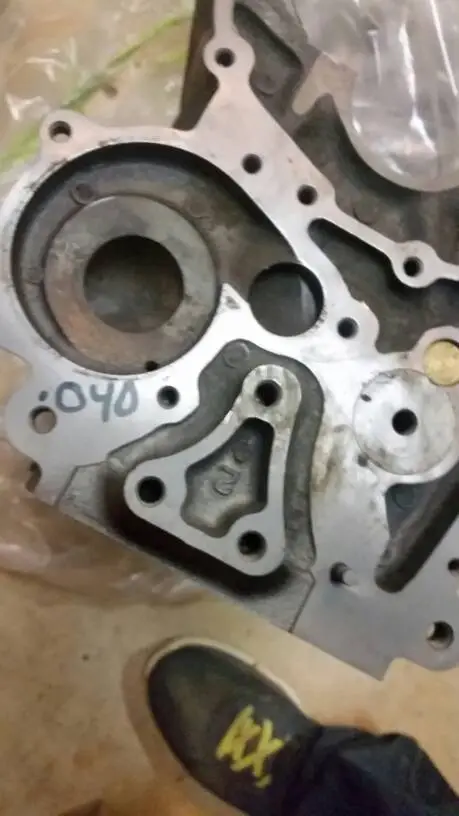

I took the head, crank, block, and flywheel to get resurfaced. I also bored the block .040 over. uploadfromtaptalk1454863189973.webpuploadfromtaptalk1454863235595.webpuploadfromtaptalk1454863252580.webpuploadfromtaptalk1454863271106.webp

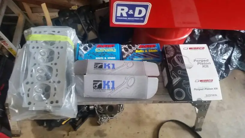

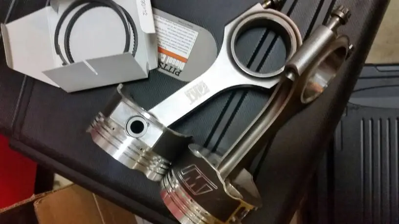

I then started ordering parts.
ARP Bolts, gasket kits, water pump kit, Wiseco pistons, K1 rods, oil squirters.
I also bought FMIC, hardpipes, new BOV,
Radiator, electric fans, new belts, corksport exhaust, air intake from street unit, and pope exhaust manifold.
I took the head, crank, block, and flywheel to get resurfaced. I also bored the block .040 over. View attachment 213148View attachment 213149View attachment 213150View attachment 213151

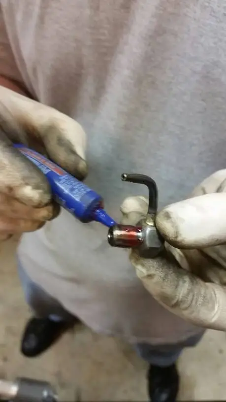

We took a screwdriver and a rubber mallet and began to gently tap out the oil squirters. 2 came out easily the other 2 we had to give a couple of good hits for them to come out. We then put loctite on the new ones and carefully tapped them in as well. uploadfromtaptalk1454866298471.webp

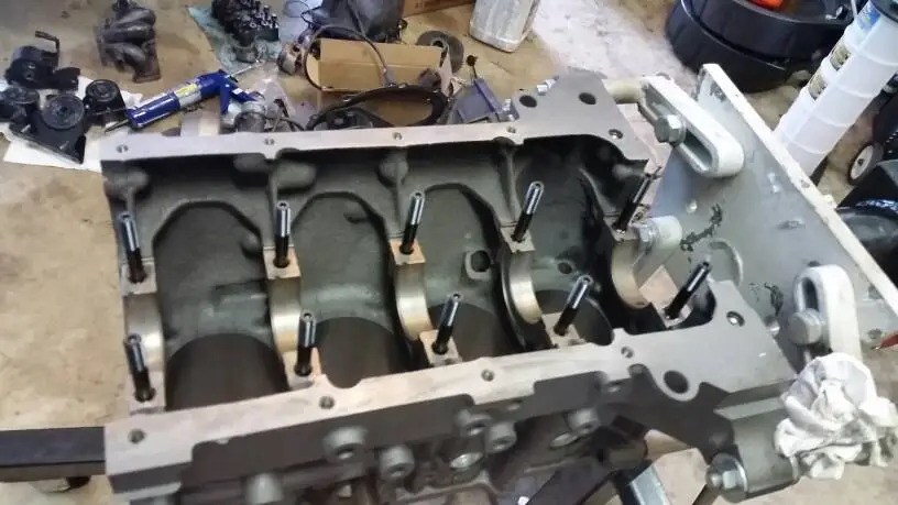

We then started with the ARP bolts.

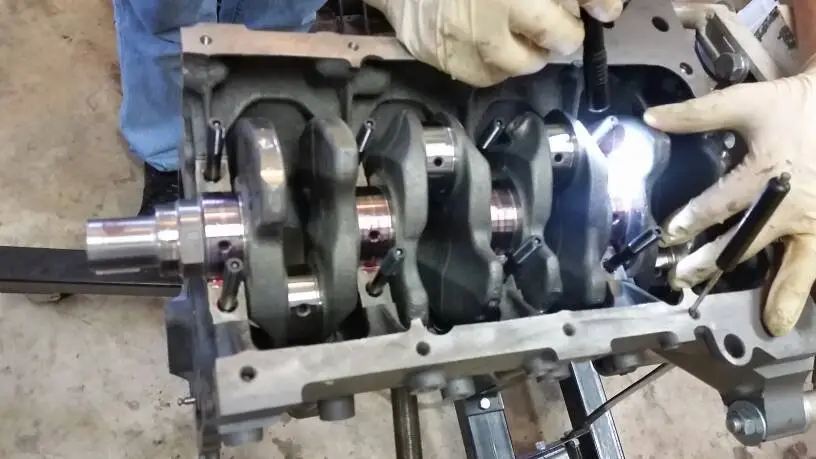

And then the crank.

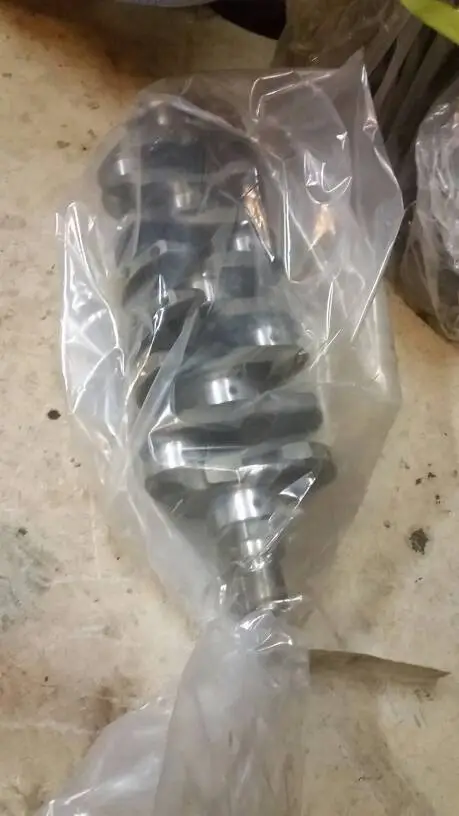

And then the crank.

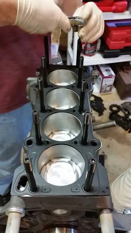

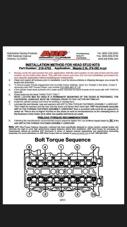

Then we added the gasket and the other ARP Bolts. And put the head, cams,and valve cover back on. I attached the arp head bolt sheet as well.uploadfromtaptalk1454870430264.webpuploadfromtaptalk1454870652638.webpuploadfromtaptalk1454870669310.webp

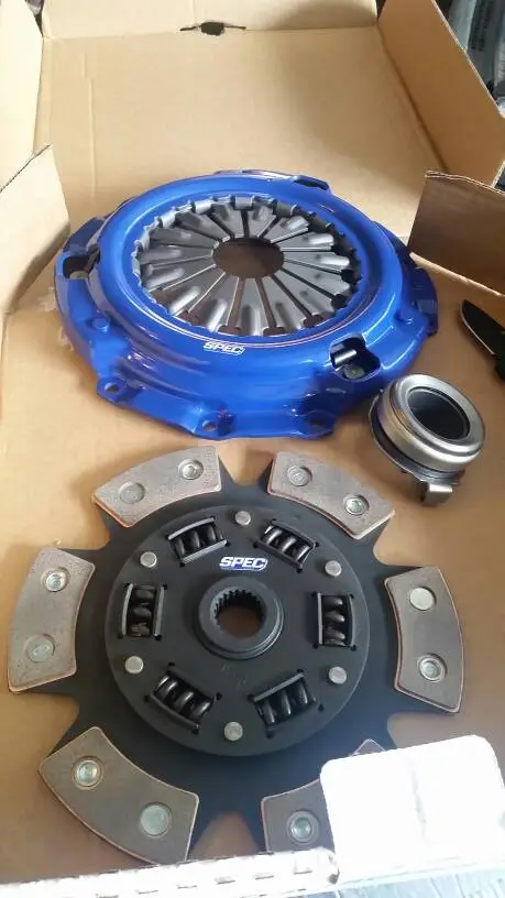

Then I got a spec stage 3 clutch from street unit. uploadfromtaptalk1454870730244.webp
Sent from my SAMSUNG-SM-G870A using Tapatalk
I then installed the clutch.View attachment 213189

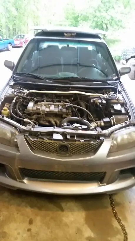

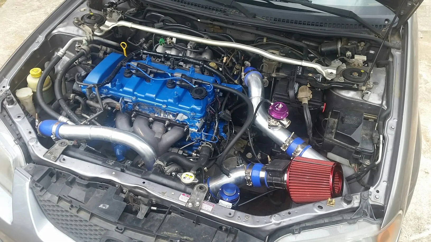

Now that i had everything back in the car. It has been sitting for 8 months since I blew the head gasket. Now it was ready to start up for the first time.
Got into the car and turned it over. Nothing happened...... Tried again and still nothing... I did everything to try and get the car to start but nothing.
We could not figure it out. We had checked everything. We double checked everything. It took us 2 days to figure out the problem. The machine shop did not properly shim the valves on the head. So we took the engine back out. Doing this chipped off like half of the paint on the engine. Sent it back to get it fixed. Got it fixed and a week later we had everything back in the car again. Now time to start. I put the key in and turned it over and it started right up. But after a while we noticed that i was not getting oil pressure. This also took us about 2 days to figure out. A dirt dobber ( if you know what that is) built a little nest in one of my oil jackets. We finally fixed that and then the car ran pretty good. I drove it around for like 3 days back and forth to work real easy to break the engine in. Then i noticed the turbo was making a weird sound. We checked it out and the turbo was BAD!!! So i went and bought a Garrett GT2871R turbo and installed it.
