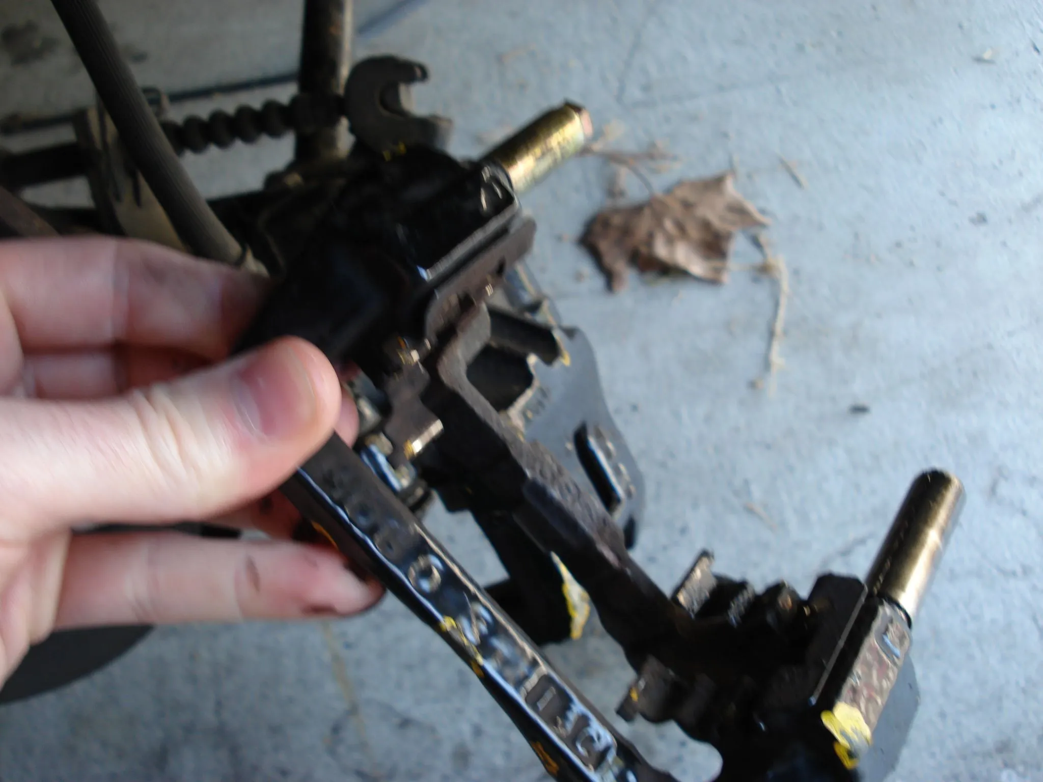

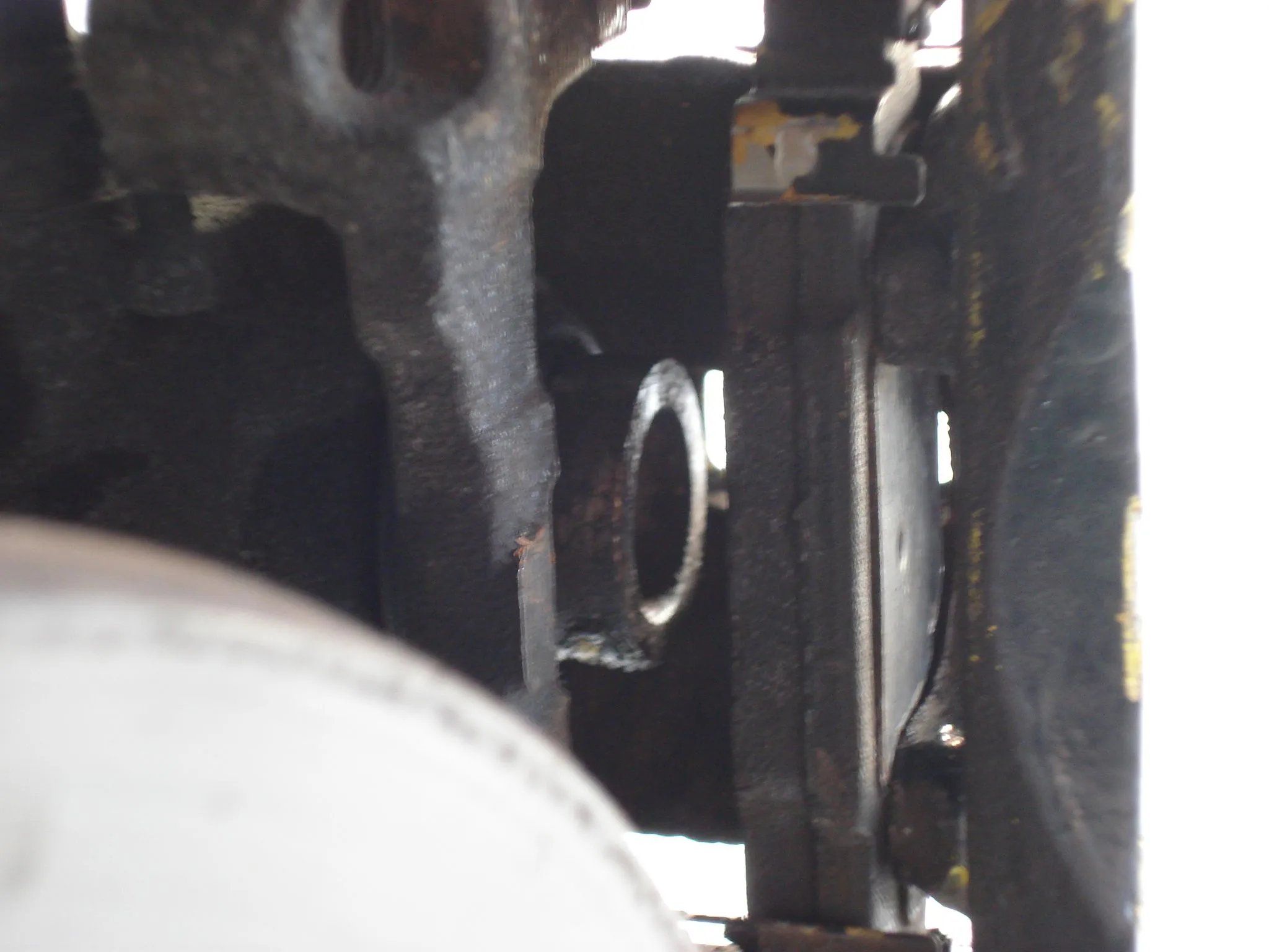

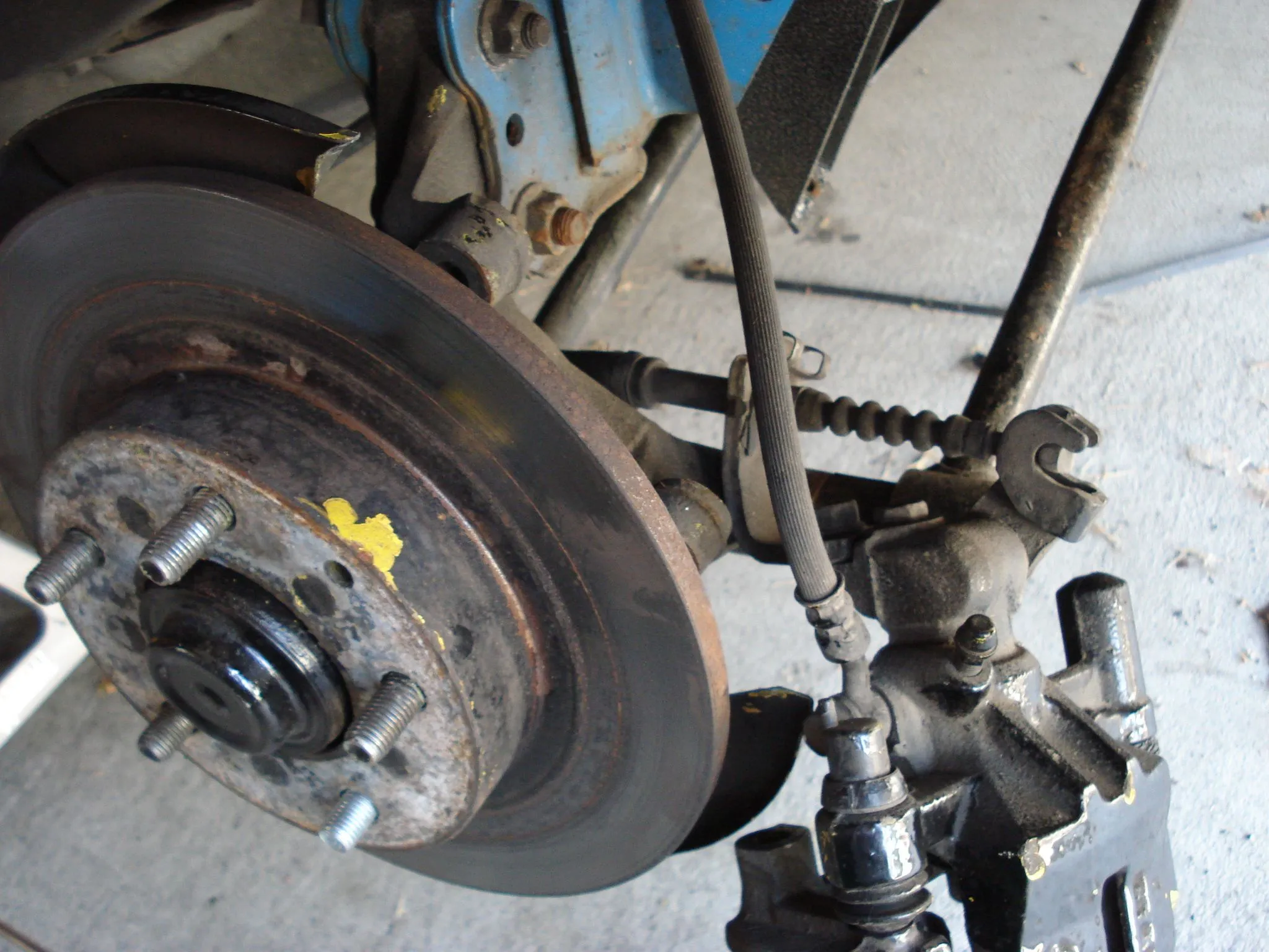

heres some pics....3rd pic shows that little head i was talking about. theres little room to get the inner pad back in. once in, theres no gap to place back over the rotor. what piece is the 2nd pic?

You've popped the piston out of the caliper. This can happen when brake pressure is applied and there is no rotor or pad to prevent the piston from travelling too far. You've either got to go purchase a caliper rebuilding kit and get new dust seals, or get a new caliper. Make sure you've got compressed air if you're planning on rebuilding, as it's about the only way to puff out the seal as you press the piston back in.
And the bolts are grade 8 10x1.25 mm pitch. Best place to get them is from the stealership. Grainger or Fastenal or the like don't have that pitch, and their selection of metric bolts is pretty thin.
Tow it to a shop and have them put you right. I don't normally say that, but it might actually save you money in the long run. Driving around for a month with a loose rear caliper might have ended a lot worse.
